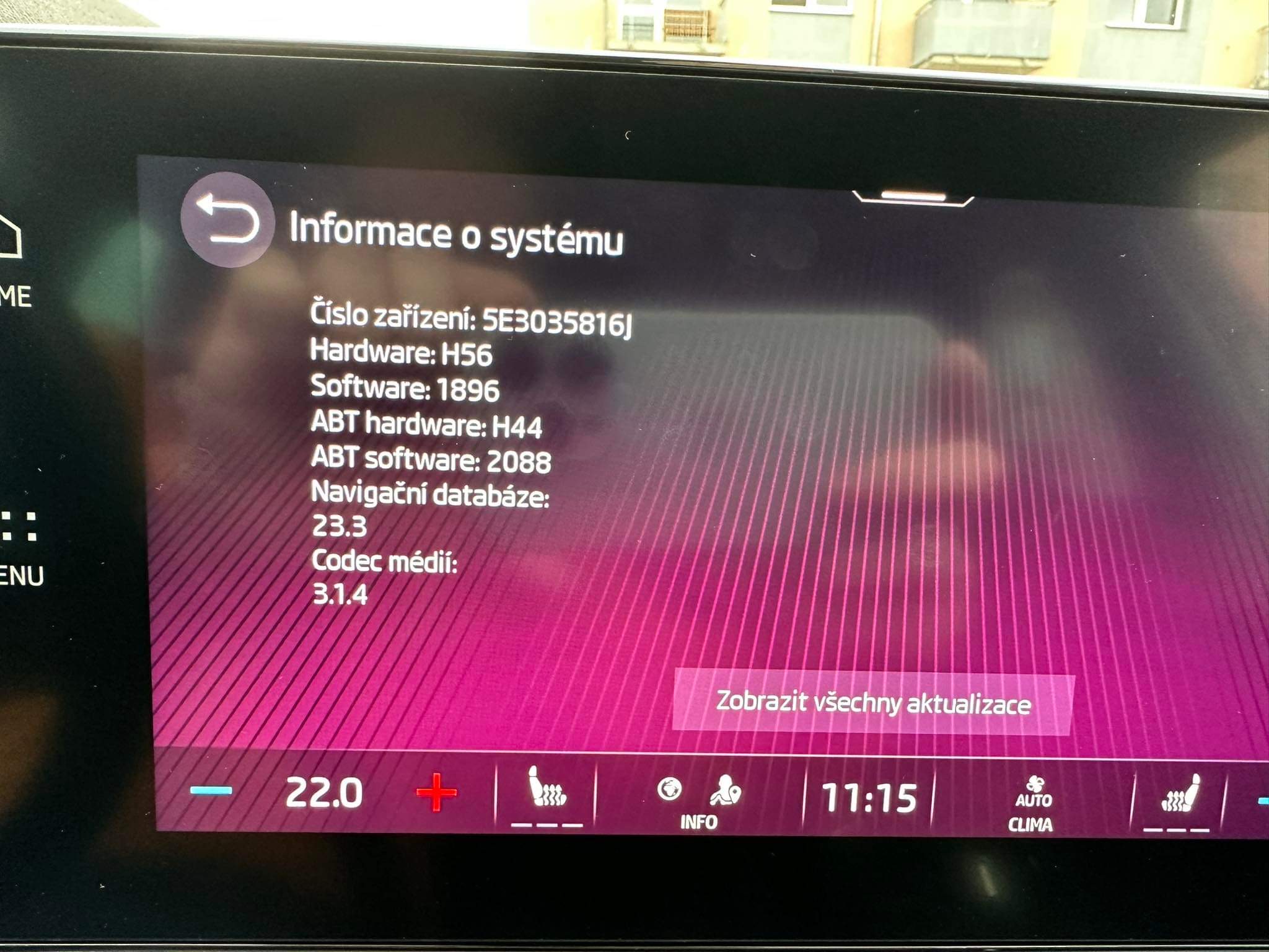

On 22. 6. 2023 at 8:33, Patiiik said:

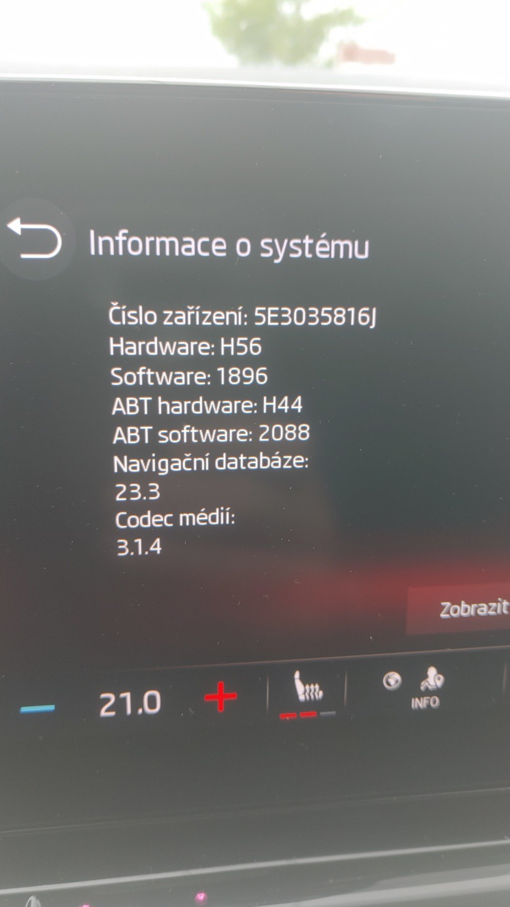

 Dobrý den,
mohl bych Vás také poprosit o odkaz.
Nyní mám hardware 1896 a H56
viz foto-
Dobrý den, také bych rad získal odkaz na stažení SW 1941. Současně mám H56 a 1896

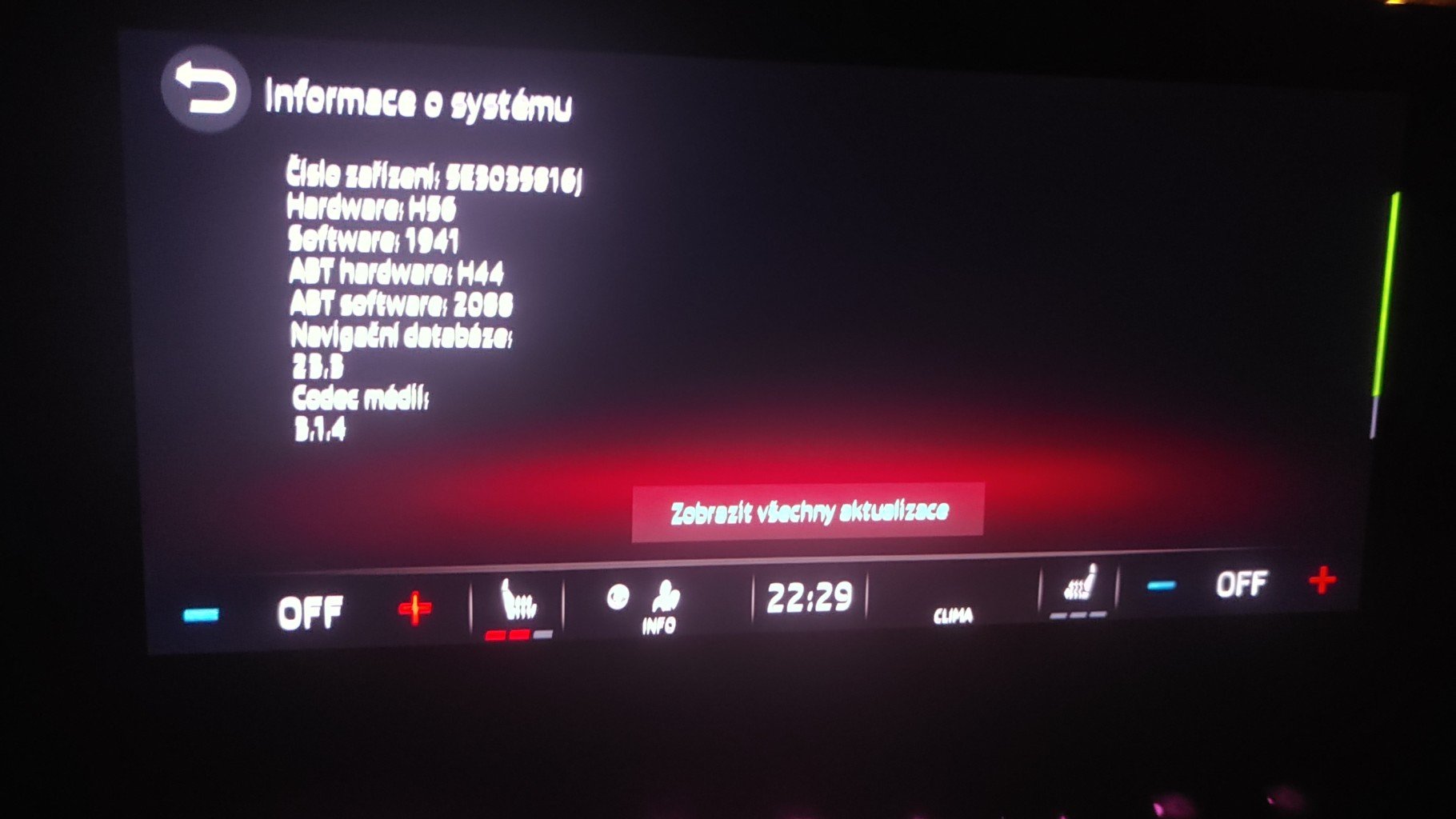

Hello,
I have a Skoda Octavia Combi IV
The car was manufactured in Oct 2020 and I would like to update the software version to 1941.
  • My current software is MOI3_EU_SK_R8960L version 1896
  • Hardware H56
  • Display unit H44
Could someone share a link to download this 1941 version?
thanks a lot

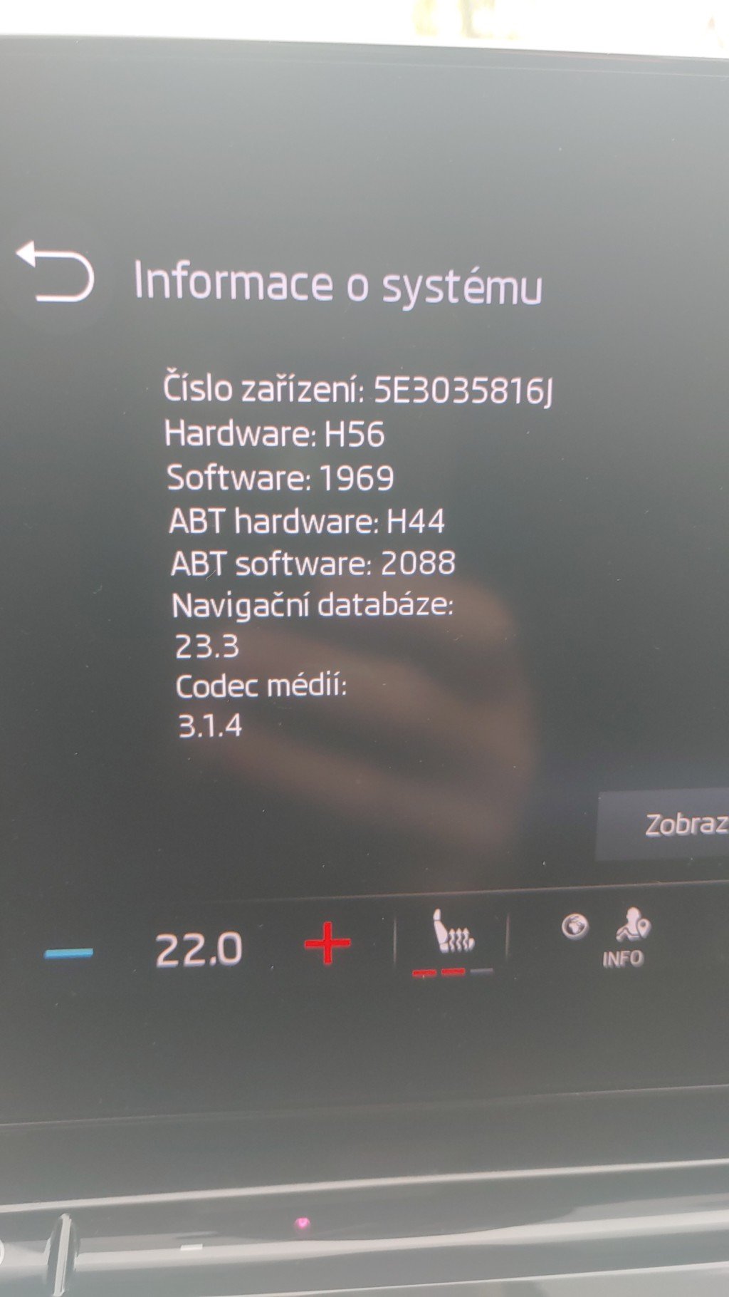

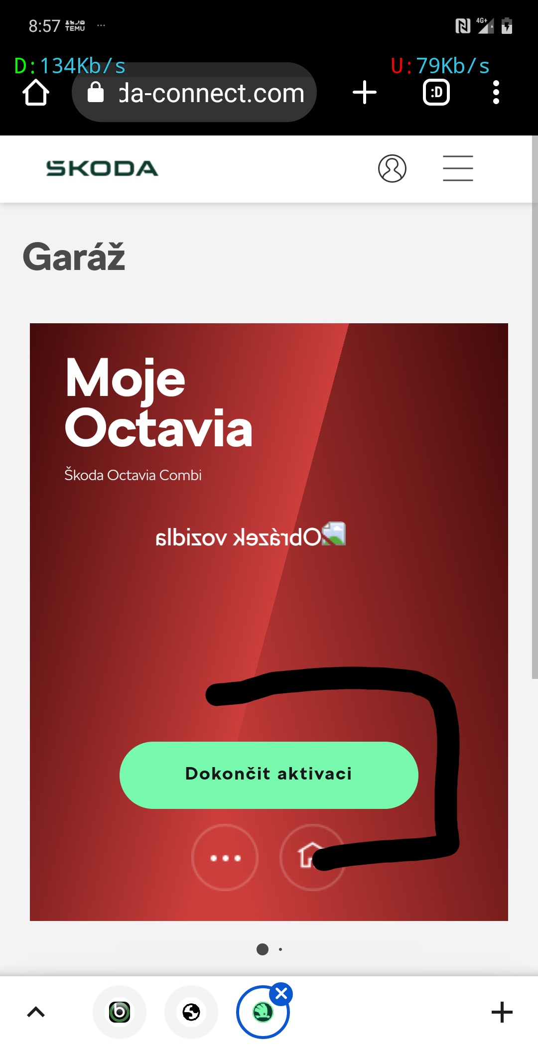

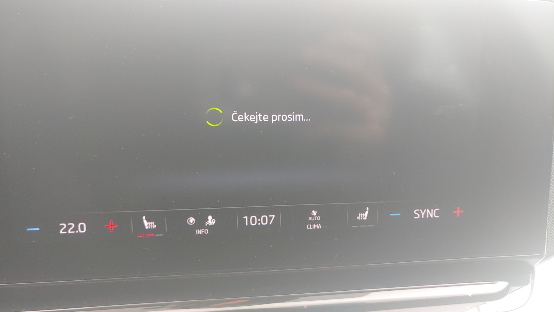

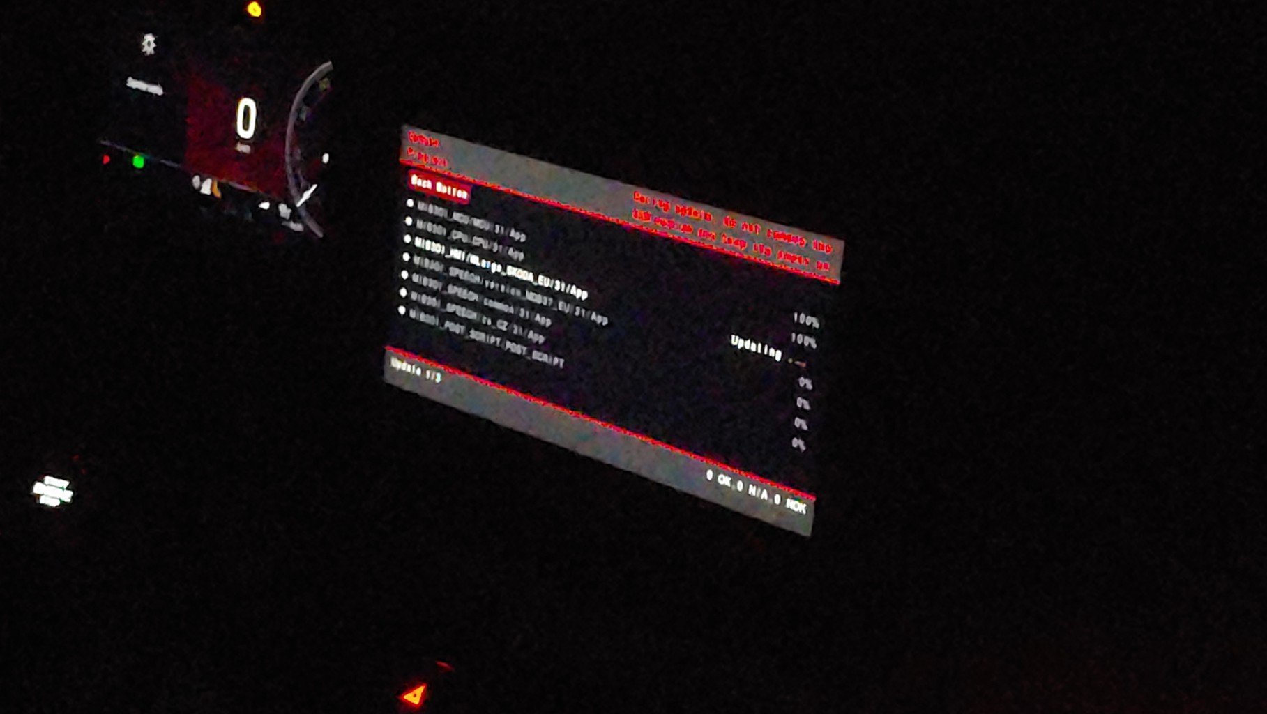

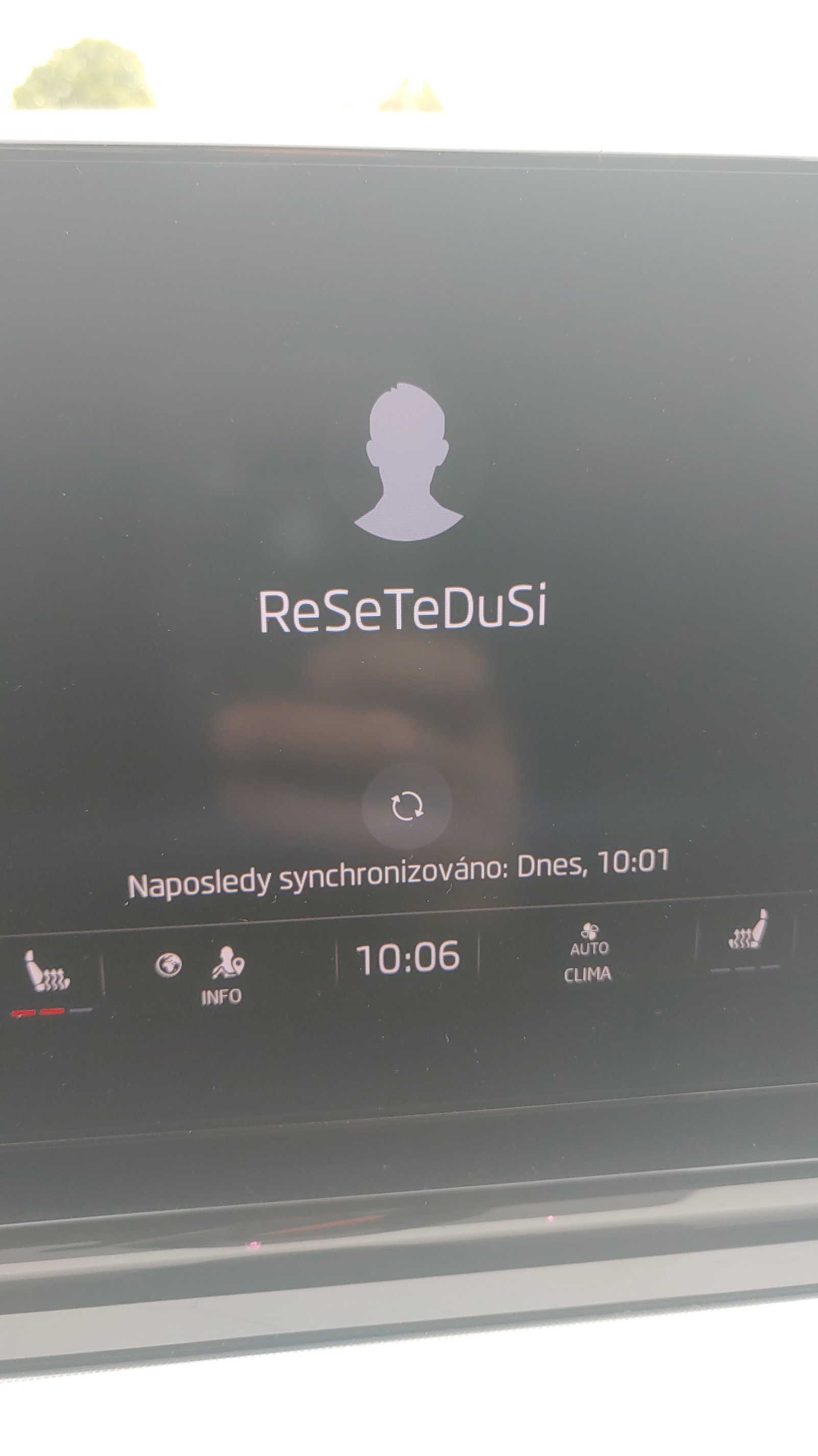

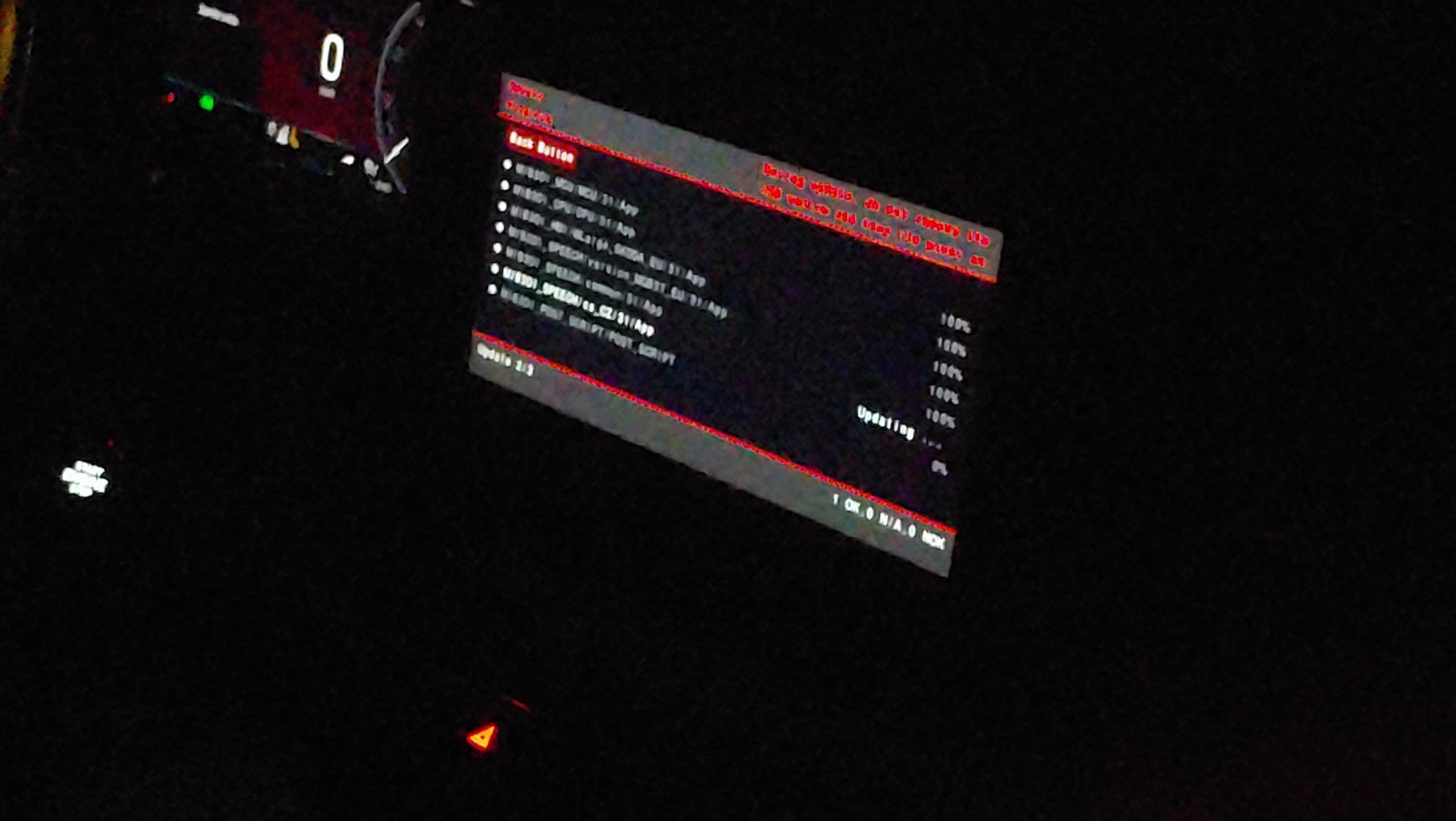

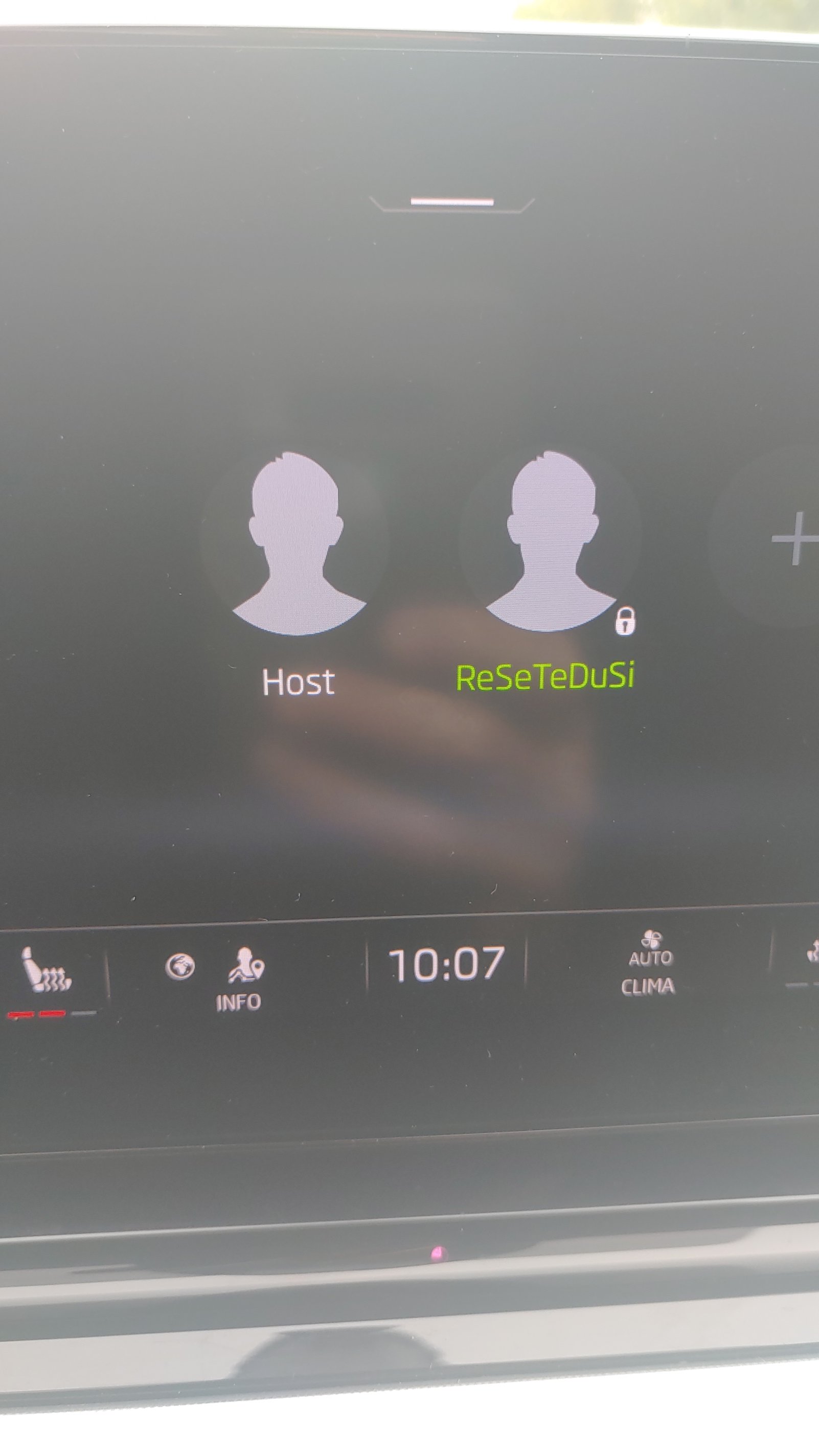

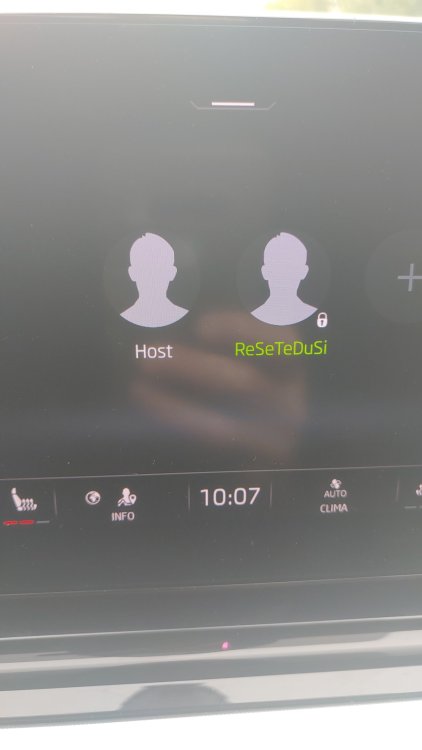

Hello to everybody.  Thanks for the links to the SW update.  I bought an Octavia 4 in 2020, which was version 1869. According to the following advice, I first updated the SW to version 1941, which went smoothly in about 22 minutes.  I tried for 2 days and then went to update to version 1969, which also went fine in about 15min.  With both updates, I noticed that the ethernet and mercury items are not updated and remain the same.  Infotaiment has sped up compared to the original version, no reboot in 14 days connection of android phone is fine.  The only problem that updates do not solve is the administration of the main user.  since purchase in March 2024 I still haven't managed to become a master user.  I dealt with Skoda support, still with version 1896, and they sent me to the service center to update the sw.  I have already been to the service center 2 times and 2 times they played the software first back to version 1941 because I updated myself to version 1969 and the second time to version 1969 including resetting the oco unit and it still didn't help, still the main user.  can't stand  Even with me skoda ID and their skoda ID, Infotaiment will stay in spinning wheel mode and write wait.  So the service is contacting support after 3 and they will call me back when they have the information.
Maybe you need an to get the Online Connected Unit (OCU) updated? The OCU controls the functionally of online services which includes user accounts.
If you ever had your SOS module updated or replaced then that is the OCU.
You can source the OCU update files from MIBSolution but I have no idea if that is something you can apply yourself or if you need ODIS like every other module in the car.
3 hours ago, aaaaplay said:
Možná potřebujete aktualizaci online připojené jednotky (OCU)? OCU řídí funkčnost online služeb, které zahrnují uživatelské účty.
Pokud jste někdy nechali svůj modul SOS aktualizovat nebo vyměnit, pak je to OCU.
Aktualizační soubory OCU můžete získat z MIBSolution, ale nemám ponětí, zda je to něco, co můžete použít sami, nebo zda potřebujete ODIS jako každý jiný modul v autě.
Hello.  Thanks for the answer.  Quite frankly, although this is a fairly common problem, according to how many of the same problems I have read on the forums, it's a shame that Škoda support and their original service still can't fix this on the first try.  The IT department referred me to my nearest service where they sent them the sw to update and it didn't help.  The service contacted IT again and they received the OCU update, they did it and it didn't work, the service also tried with their ID account where they have normal vehicles in the application as the main user and it didn't work either.  So, I am contacting Skoda support and the IT department again and they will call me back when they know what to do next.  The user can be added and his settings are saved, but he cannot become the main user, he does not ask for authorization with the help of both keys/drivers.  Without the main user, the application does not work, the activation is not completed and there is no conncet item for online services in the menu.  Of course, the infotainment globe is white and I have paid for esim data services.  When the next service is over, I will let other users know.
