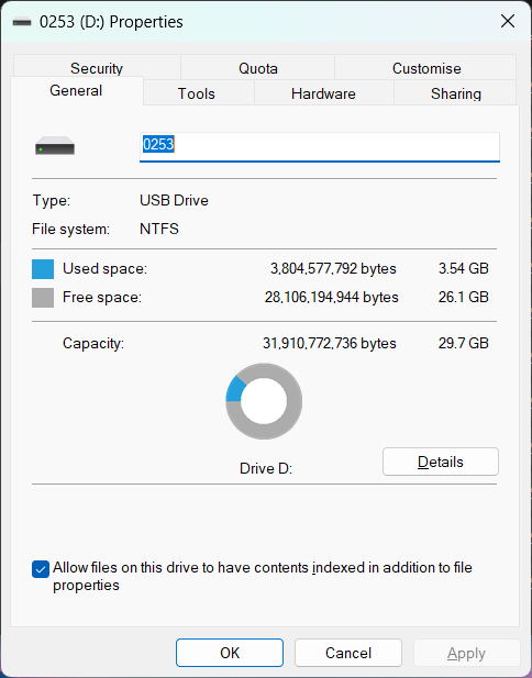

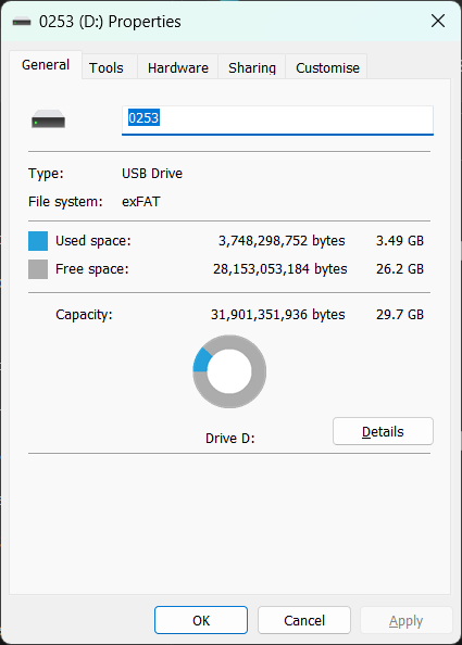

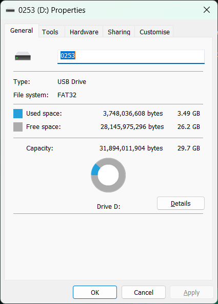

The tl;dr is that exFAT with 16K cluster size gives you the most free space available for map storage.
As you can see from the same card formatted with NTFS/FAT32/exFAT, the NTFS has the least free space, and exFAT has the most free space for maps.

Some images to show the space used/free on same card

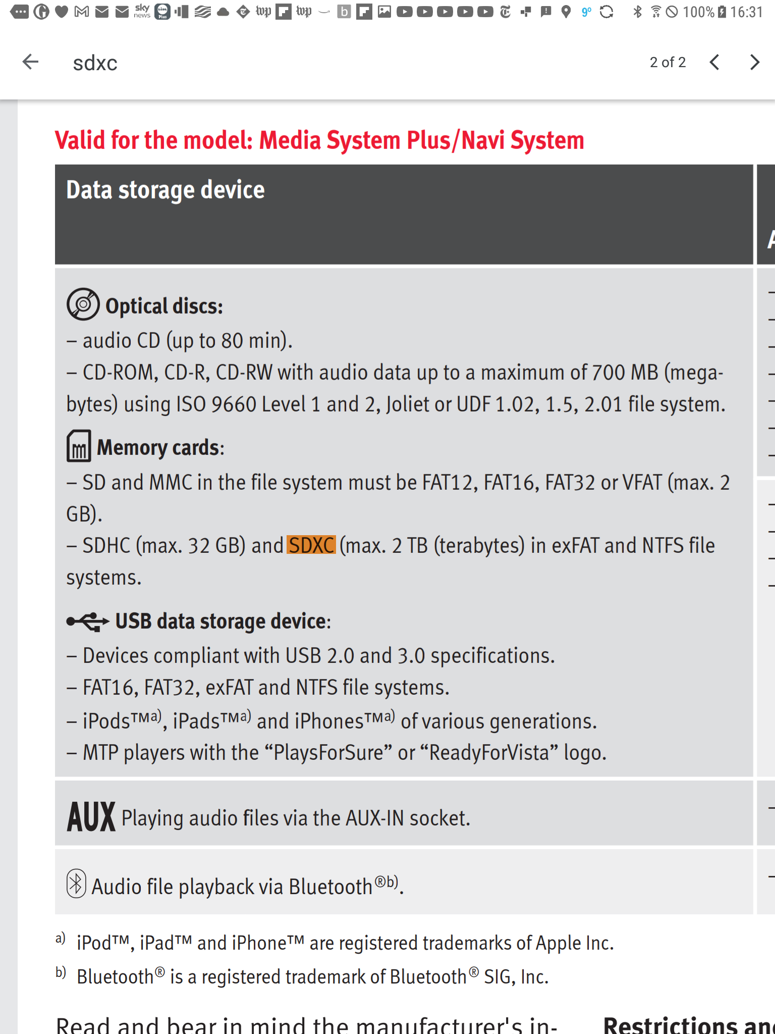

This now begs the question of whether a good 64gb card is better than USB3. The unit is suppose to support USB3 and SDXC cards.
If the tables are correct here then a USB3 drive will beat SDXC.
https://www.usbmemorydirect.com/blog/flash-drives-vs-sd-cards/
This SD SanDisk Extreme PRO 64GB SDXC Memory Card up to 170MB/s, UHS-1, Class 10, U3, V30, Black claiming 170MB/s
V
USB
https://www.flashbay.co.uk/support/faq/usb-flash-drive-read-write-speed
[USB 3.0:
Sequential write speed range = 10~45 MB/s
Sequential read speed range = 60~150 MB/s]
We don't really know what bus speed the SD reader has in the unit apart from it takes SDXC. I'm thinking it might not match this
https://wavelength.focuscamera.com/a-guide-to-sd-card-speed-other-specs/
Either way I got one of these ready for the day.
We'll have to compare notes next time round.
& I'd be doing exFat above 32gb.

Yes you need this thread. It runs on an internal SSD. To update you want to get a 64gb SD class 10 or higher in exFat, or USB formatted to NTFS. The current release is pushing the limits of 32gb SD cards so next time I'm sure it will pop all 32gb cards. Just pops some at the minute. Have been looking into it this time round for the next.
I just had a new Sandisk 32gb class 10 delivered today.
It will suffice for this update??

Try to copy the unzipped all Europe file onto it. They are SanDsk Extreme Pro I've been using. Manufacturing differences do make a difference as the files get close to bridging the 32GB size.
Possibly the next release won't due to how the cartography getting bigger. I'm expecting one will need 64gb next time round. I've identified that SD cards won't run above 100MB/s in the unit so you don't get any speed increase in the ones rated above 100MB/s it won't have the matching chip for that (I don't reckon). If you do use a USB that needs to be in NTFS. Above 32GB SD cards should be exFat.
Suspect this time round you will be fine. Keep it in Fat32 but you should not need to reformat it. Don't touch the format.
Edited by Tell
