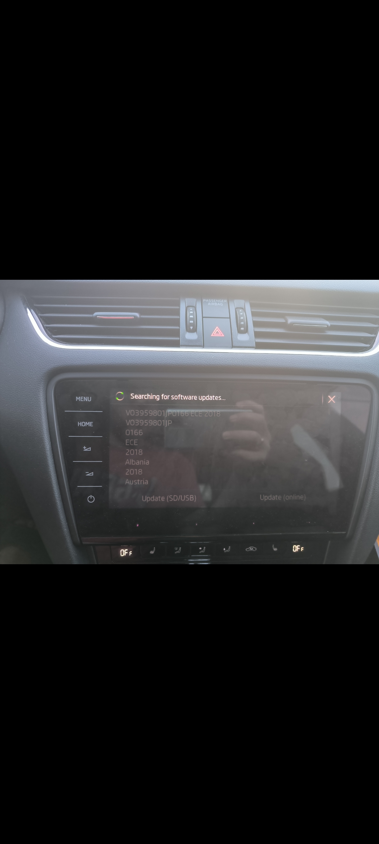

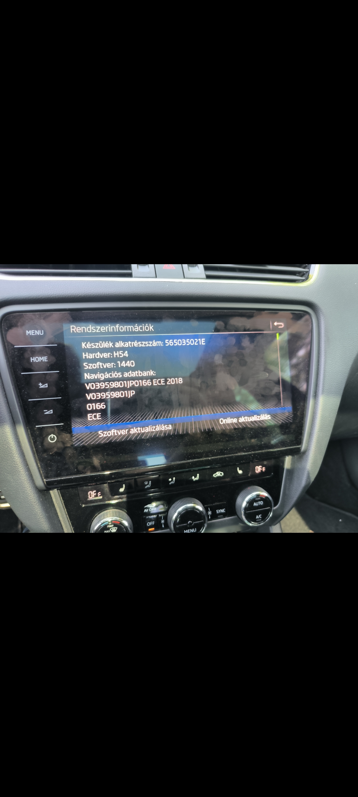

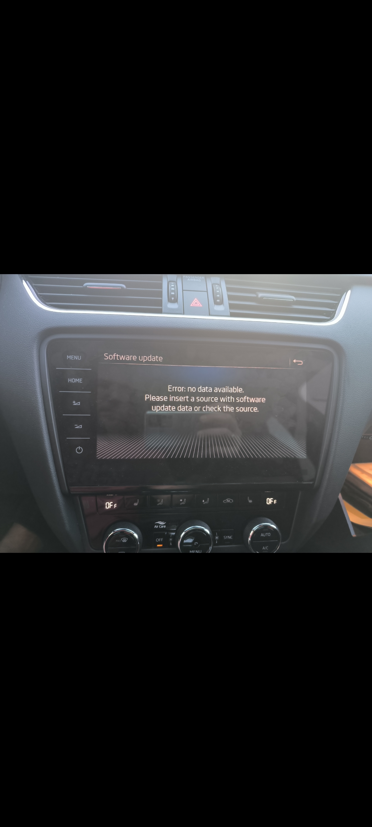

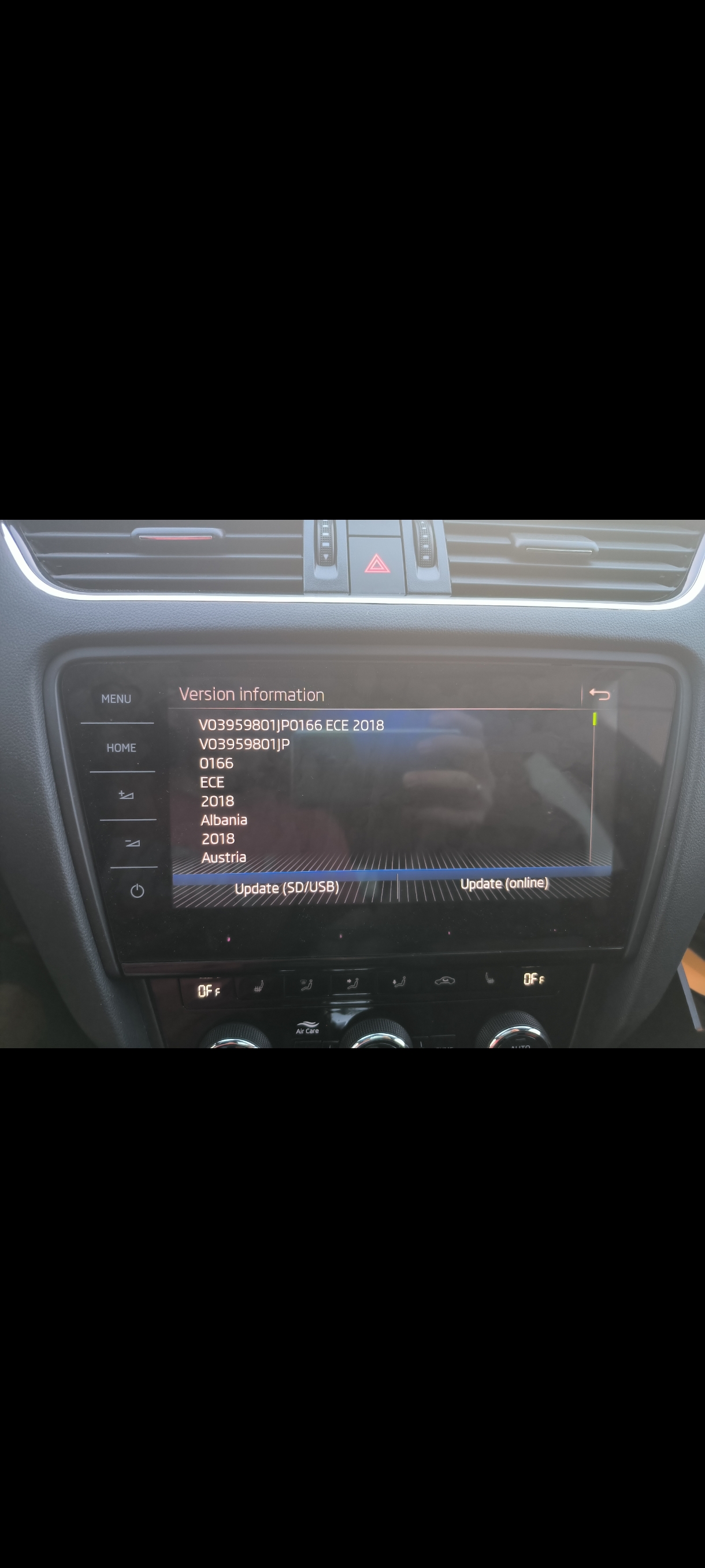

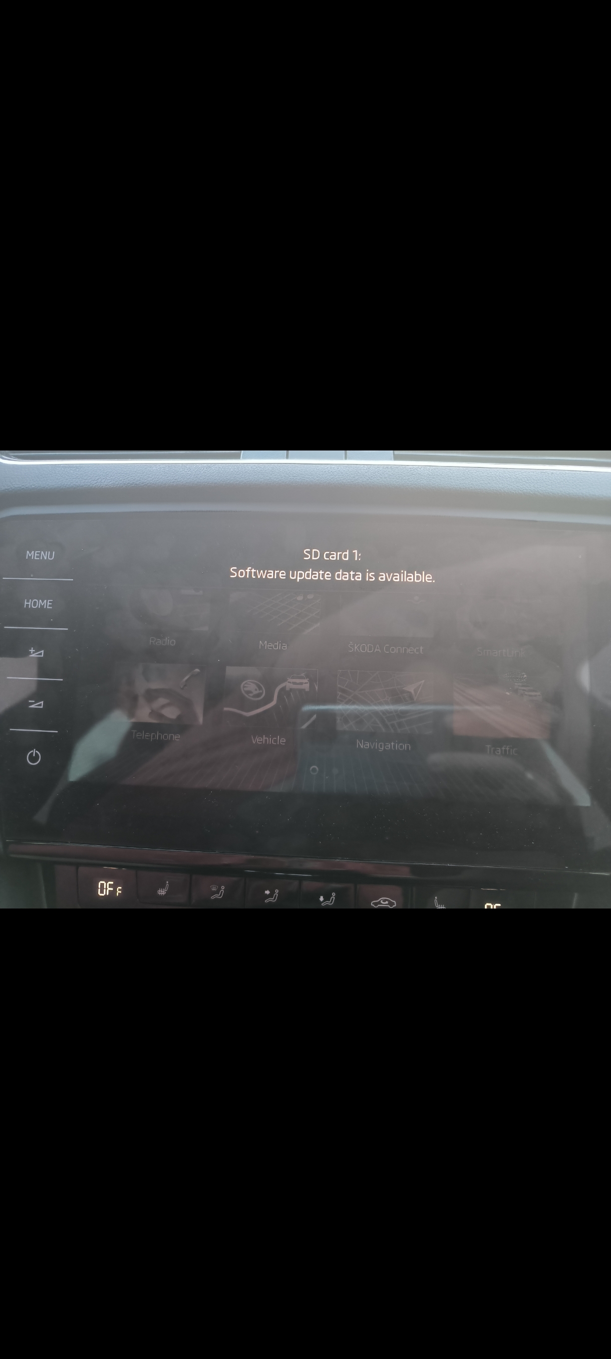

Hi Everybody,
I would like to ask for help. I can't update the map. I am attaching the pictures. Thanks
Did you use a Mac for the download ?. Macs leave a load of Mac generated rubbish in the file which causes the validation of files to fail if you presented them incorrectly. Happy go lucky Mac users fall into this trap. You download with Keka, copy to the SD card then run CleanMyDrive on the SD card, then insert it into the unit.
Failing that its a presentation issue. See the manual posted on the other threads, can't get one uploaded at the minute. Failing that if it's it's not a Skoda or VW then it will be your navigation FeCs. They need to be long FeC.
I'm sorry.
My auto ist the Skoda Octavia(2018) mk III.
I did everything under Windows.
Thanks

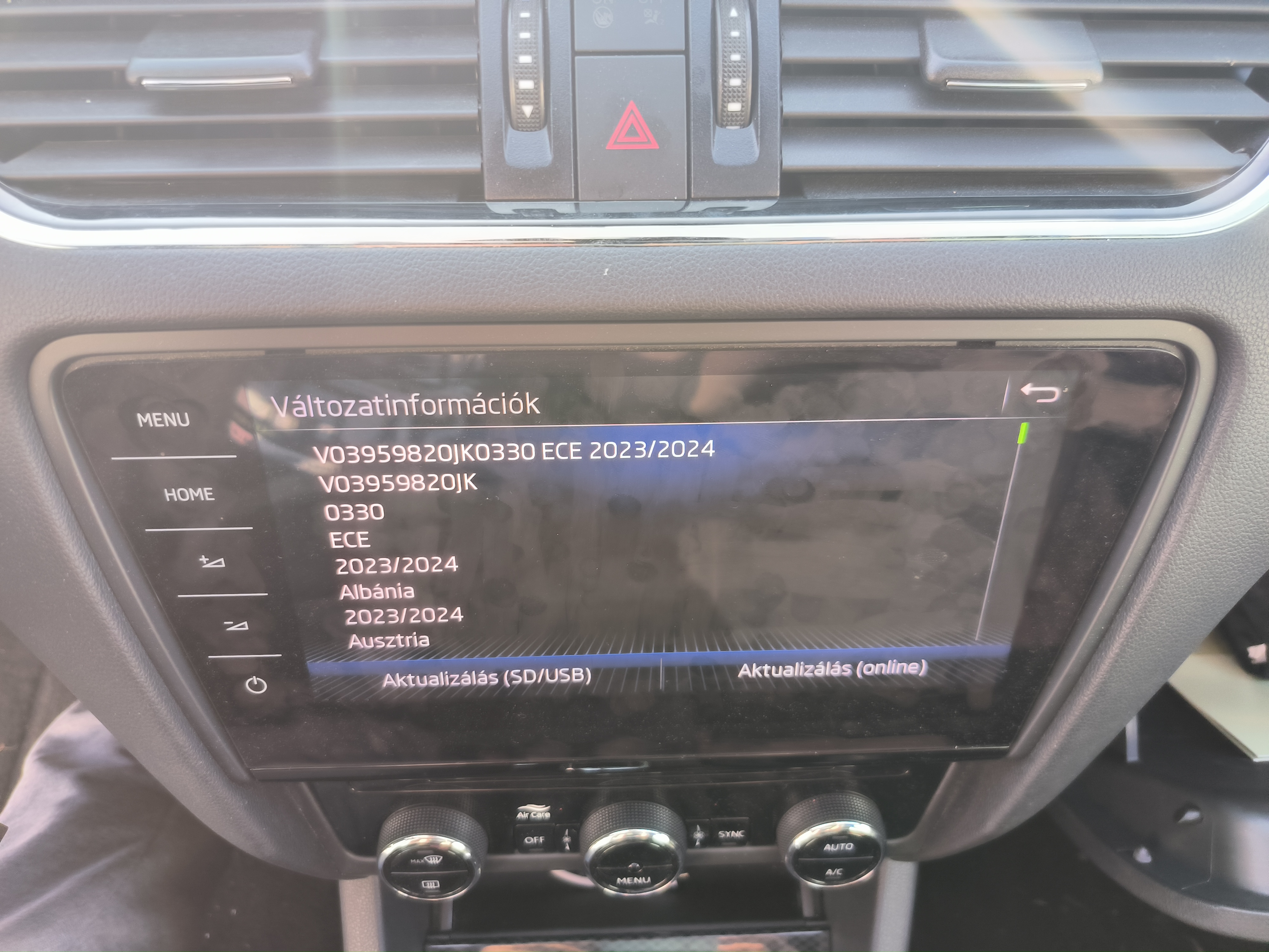

This thread isn't for the latest maps so you need the 330 release see below if you haven't found it but that isn't your technical issue.
The instructions I was talking about are here, my 11th November post, the VW how to PDF. The gold standard:
So your issue will be a presentation issue only of not presenting the update as expected (You have a mib2 high, tick, a Skoda so not a navigation FeC issue, tick, using Windows so not a Mac issue tick). That leaves not unzipped or at the wrong directory level down in how it's presented etc (see PDF in thd link). Also good to pull other cards out so it only sees the media.
You are suppose to use 7zip for the unzip process. Others can give a problem. Basically the unit reads the files and checks the integrity of the files from the signatures and checksum. If they don't pass it won't see the update. Not in the correct level is another - see the PDF, not unzipped correctly, or not using a valid file system, Fat32 for the 32gb card, exFat for above cards, or NTFS for USB and it wont work. Those are the outstanding issues to check.
Suppose to be in Fat32, 32gb SD card but the maps have outgrown some cards, you use say 64gb in exFat if that's the case or USB in NTFS (That isn't in the instructions above). I mention that if after using the latest you find they wont fit on the card.
I did use to say only stick to the 32GB card but since the maps have expanded above what some 32GB cards can handle now, you can get issues if you don't get the file system right for exFat on big SD cards or NTFS for USB. So that was the other issue people hit.
The latest maps are here:
Release 330. Your 166 you see on the screen will become 330 when successful. They are the June 2023 release found early by MartiniB in April. I think poster drifted threads at this point so you might be using the latest or may be not. The Mod John needs to pin that thread above and un-pin this one so people find the latest at the top else people grab the wrong files.
Edited by Tell
