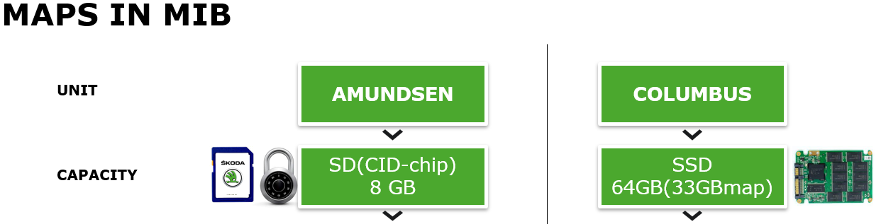

I was looking through some technical documents today, came across this.
It would appear that they dedicate a 33GB partition in the Columbus for the maps.
Hope this helps everyone, knowing there is still capacity.
10gb of that 64gb goes to the Juke box. You got the firmware itself and then a little bit of space they keep to move around in over the maps, juke box, firmware. Run time space assuming it's in there... probably not so little. Depends a lot on how rigid the space is, probably pretty rigid.
I'm sure there is a detailed memory map somewhere of the SSD. Probably the firmware isn't in that nor user POIs. Still about 20GB unaccounted.
