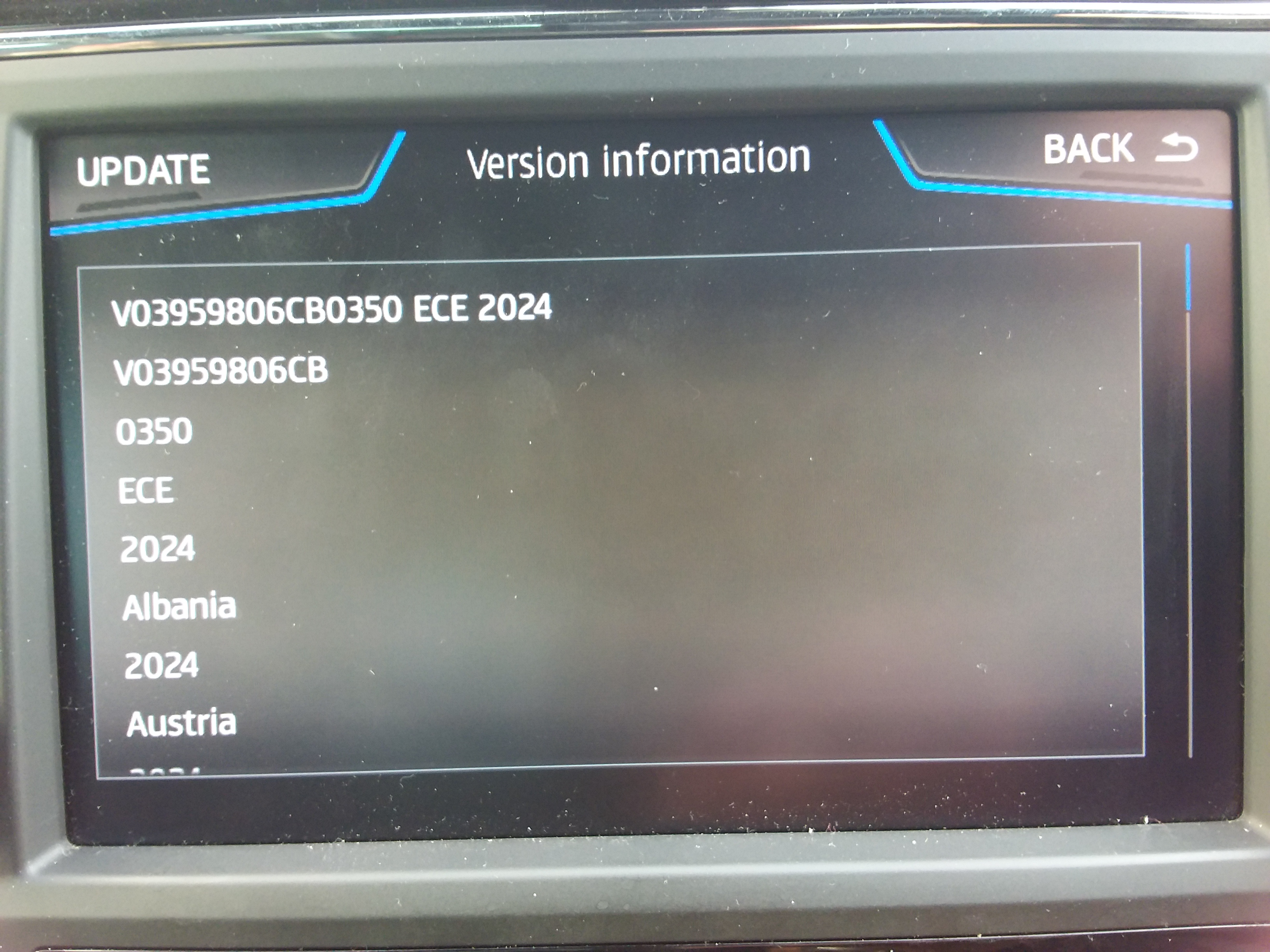

As posted I got the latest installed without issue (350):
From Vag PDF Same for all VAG cars.
Installing the map material
• Insert the SD card into one of the SD card slots on your vehicle until it audibly clicks into place.
• Now select the “MENU” button on the Discover Pro. Click on “Update software” in the “Setup”
menu under “Version information”. Now follow the instructions on the display of the Discover Pro.
Unzip, copy across then above.
