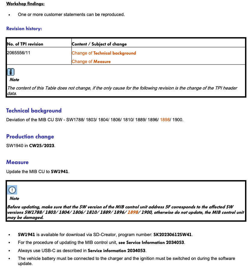

Please read this very carefully. If you have LOW numbered firmware/software, then you MUST visit a dealer before you attempt to upgrade to 1941 or 1969.
If you attempt to do so then you may cause major damage & have to buy a new infotainment system which is hideously expensive.
So please bear this in mind.

"Before updating, make sure that the SW version of the MIB control unit address 5F corresponds to the affected SW versions SW1788/1803/1804/1806/1810/1889/1896/ 1898/ 1900, otherwise do not update, the MIB control unit
may be damaged."
@TheWanderer is this the section you're referring to?
I'm surprised that the update files don't have a version checker.
If you check out this thread from the Kamiq section the MOI3 Preh checks which version you're trying to install. If it is too new then you have to do some of the incremental updates in between.
I've experienced this first hand on my mother's Kamiq, it won't accept the update.
I'd be very surprised if the MOI3 LG used in our Octavia's wouldn't have a similar protection - but it's entirely possible. In saying that I haven't seen anyone with a version older than 1788?
Yes. So if you have one of those firmwares listed then visit the dealer, get them to do the checks and necessary upgrades and then they can do the upgrades afterwards or leave it up to you or the system to do it itself via the OTA system.
Before updating, make sure that the SW version of the MIB control unit address 5F corresponds to the affected SW versions SW1788/1803/1804/1806/1810/1889/1896/ 1898/ 1900, otherwise do not update, the MIB control unit may be damaged."
The use of otherwise, suggests the exact opposite. As long as you have any of the software versions above, then proceed with the update to 1941.

It is imperative that you DO NOT attempt an upgrade from a low numbered SW revision otherwise you will almost certainly get a big bill for a replacement infotainment system. The forum or it's members are not responsible if you damage your cars infotainment system irreparably.
Like any of us. YOU DO THE UPDATE AT YOUR OWN RISK.
Everything we do ourselfs come at risk, nice that you found the TPI for the update @TheWanderer

I would say that was lucky. Skoda technical don't issue those TPI instructions without good reason.
  • Sponsor
@aaaaplay makes a good point above about the interpretation of the instruction,  particularly the word 'otherwise'.

To be fair I actually paid for and then posted those screenshots of portions of the TPI.
Also based on the TPI Information you had a software version that was safe to update from anyway.
