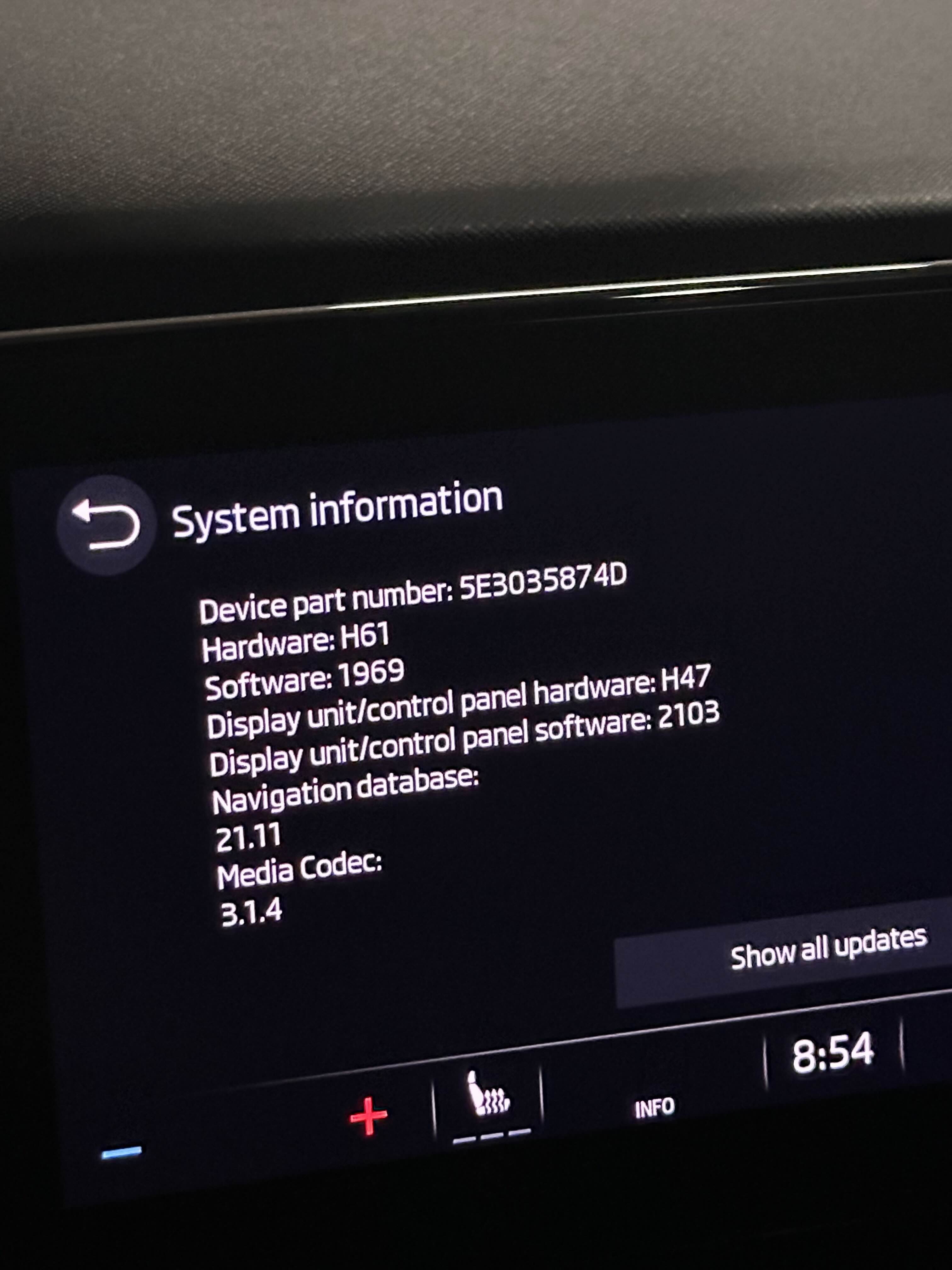

Got 1969 and give it a good soak test on a 3 hour drive home after collecting the car. It's nice and slick and never missed a beat with Android Auto connected wirelessly.
Early days I know, but looks promising.

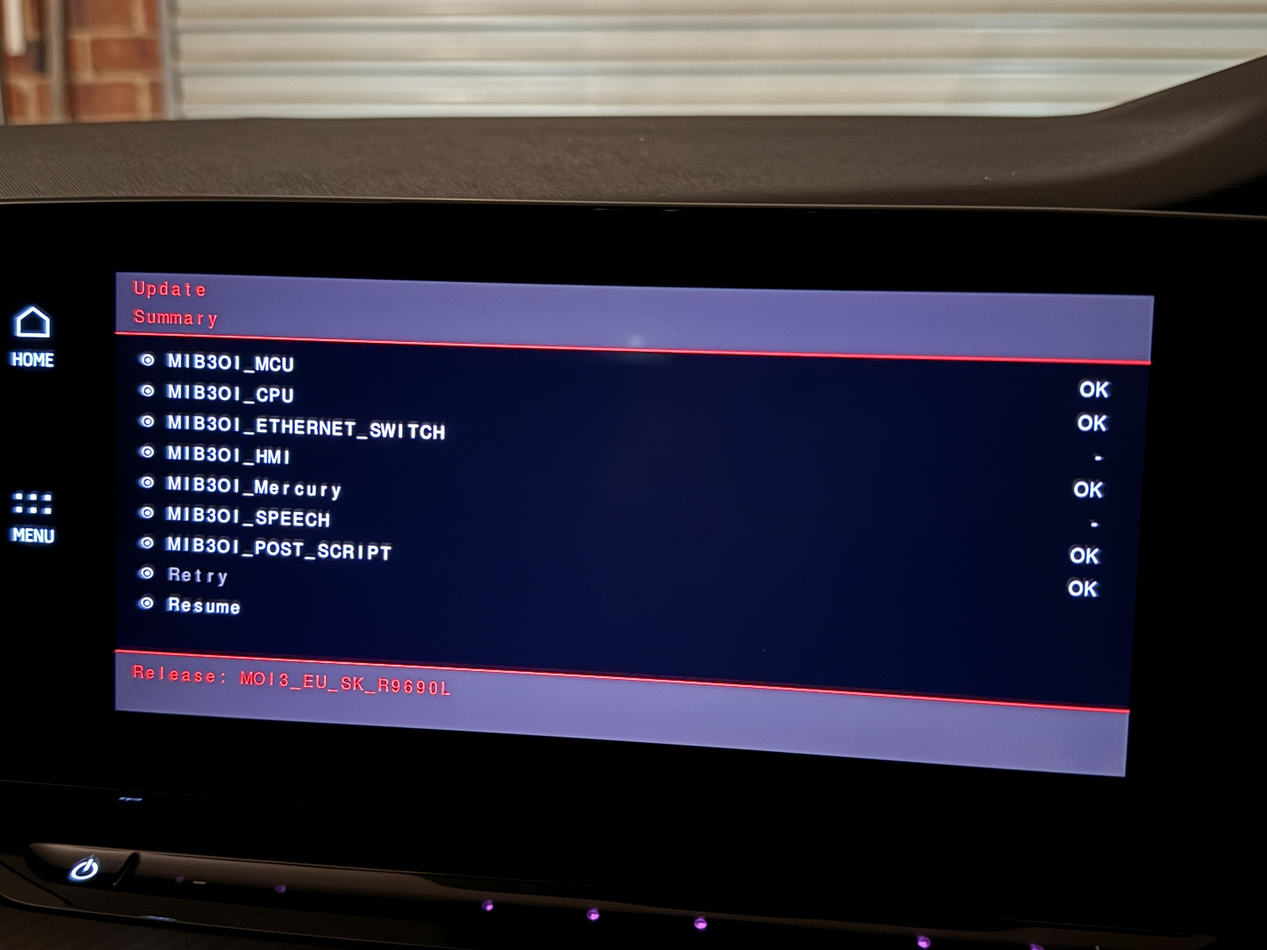

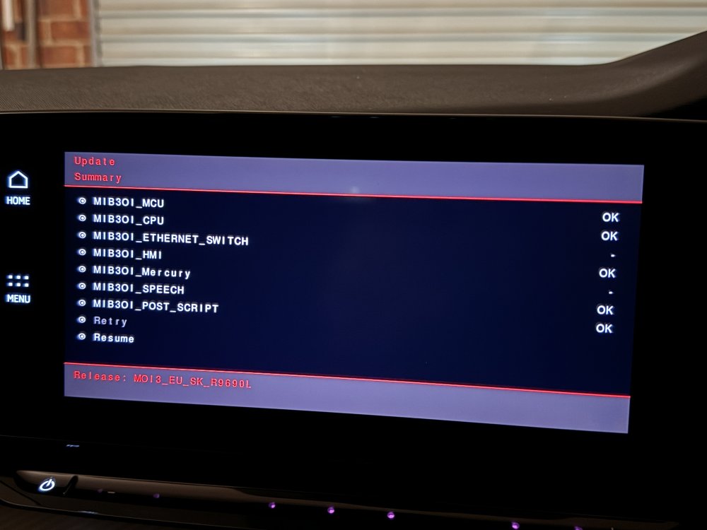

I updated my Australian spec Octavia and everything seemed to go well. The only thing I noticed is Ethernet Switch and Mercury didn't update - but everything seems to function fine.
The biggest speed improvement I've noticed is cold boot.
For context, I have approach unlocking enabled and since this update the head unit is sitting in standby displaying the time well before I'm ready to press the ignition button.
Whereas before, I could be driving off while the MIB display still says Skoda - that's was on 1941.

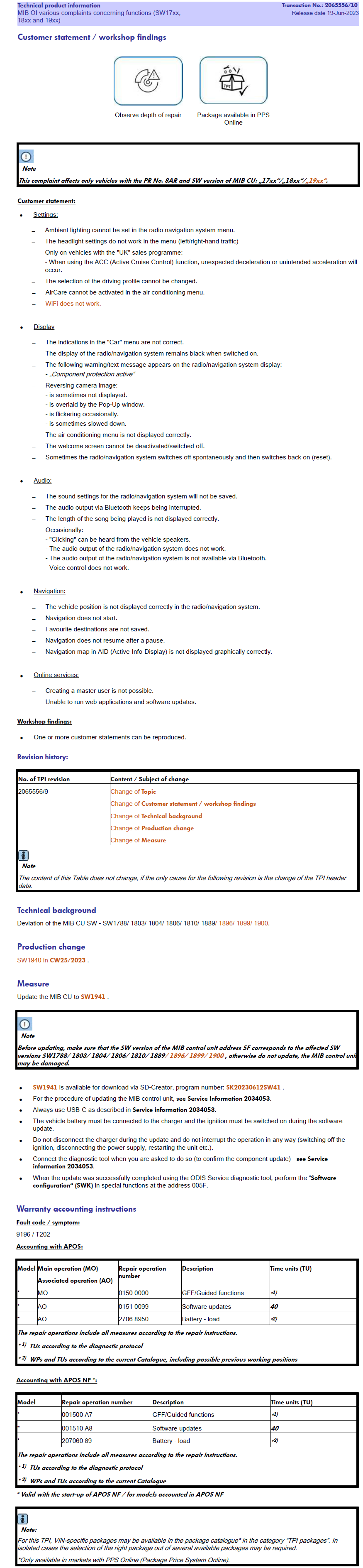

Does someone have TPI document for this update? I'm curious for faults addressed with this.

My dealer called in January to tell me there is a TPI available for my car for upgrading from 1788 to 1941. Told me the factory is trying to upgrade all the cars with version lower than 1896 to the latest so cars will be able to get major updates over OTA.
5 minutes ago, llewis6996 said:
This is for 1941 rather than 1969.
