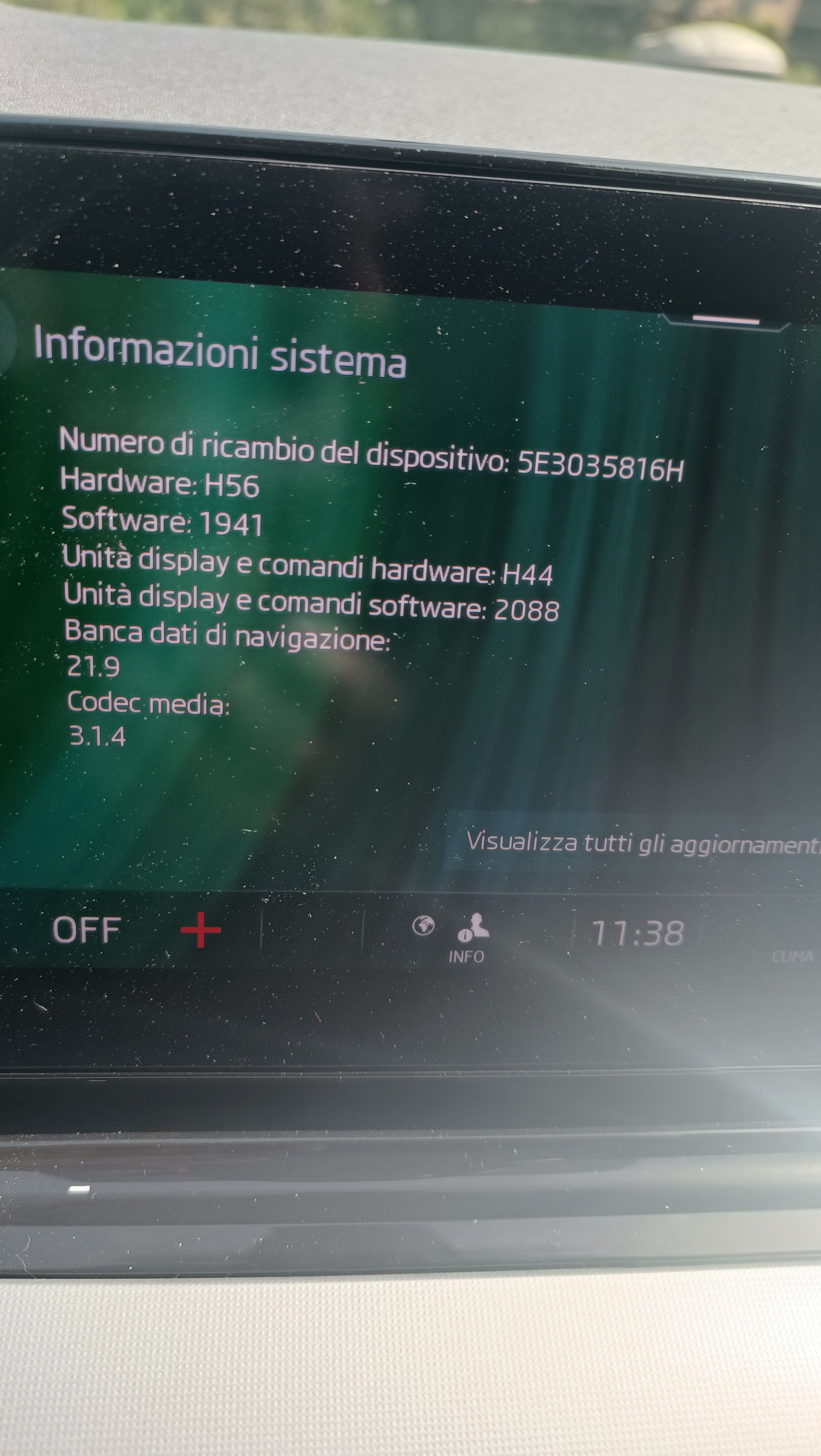

Hello,
I'm thinking to upgrade to 1969 due to I'm going crazy with continuously restart and sometimes and infot. Sworn on also when the car is closed.
I've actually this configuration.
Do you think I could solve?
Thanks for the help

Seems like a dangerous choice to make. If it reboots during the update then the unit will be totally bricked. Have you contacted Skoda?
Yes I do and they gave me an appointment very far.
Yesterday evening seems to go ok without any problem after I disabled gesture and proximity from the display settings.
Sorry for the little OT I'll put this trick into another topic
It shouldn't reboot when it's in maintenance mode. When I did 1941 and it was doing random reboots in 1900 software, once I activated the maintenance mode with the software/ firmware screen the reboots stopped and I was able to do the update without any problem.
