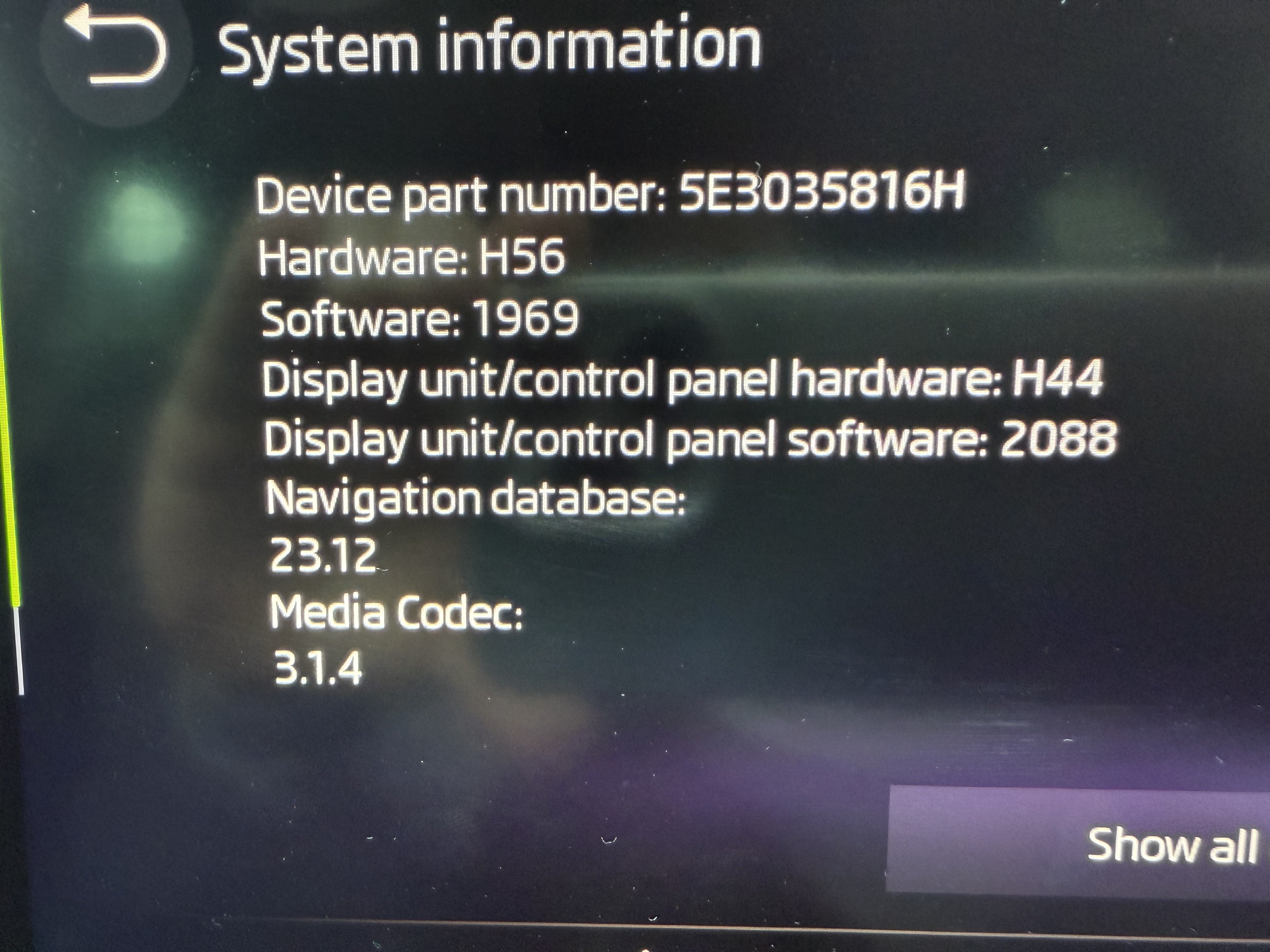

On 08/10/2024 at 19:22, Maxi24 said:
And that's my challenge - unless I can find someone who has had dealer update (or OTA) or reference to it on a Skoda site, they will refuse to believe that it is real as it is not the latest according to their documentation. The dealer did say they contacted tech support who confirmed that 1941 was the latest release.
My dealer (DM Keith) updated my car from 1806 to 1969, but only after a lengthy chat with Skoda U.K. (who were not interested) and some excellent side support from the National Skoda Fleet manager (as my company has many Skoda vehicles)
The dealer wanted £156 to update.
Between the national fleet manager and her direct influence with my local dealer and also bringing in VAG group direct, it was done FoC
Since the update I have been able to update my navigation map via USB and things like settings ‘drive on the left’ are now cured.
Will understand if other things have changed as I use the car more , but for now I am unfortunately sunning it in CYP for 3 weeks 😉

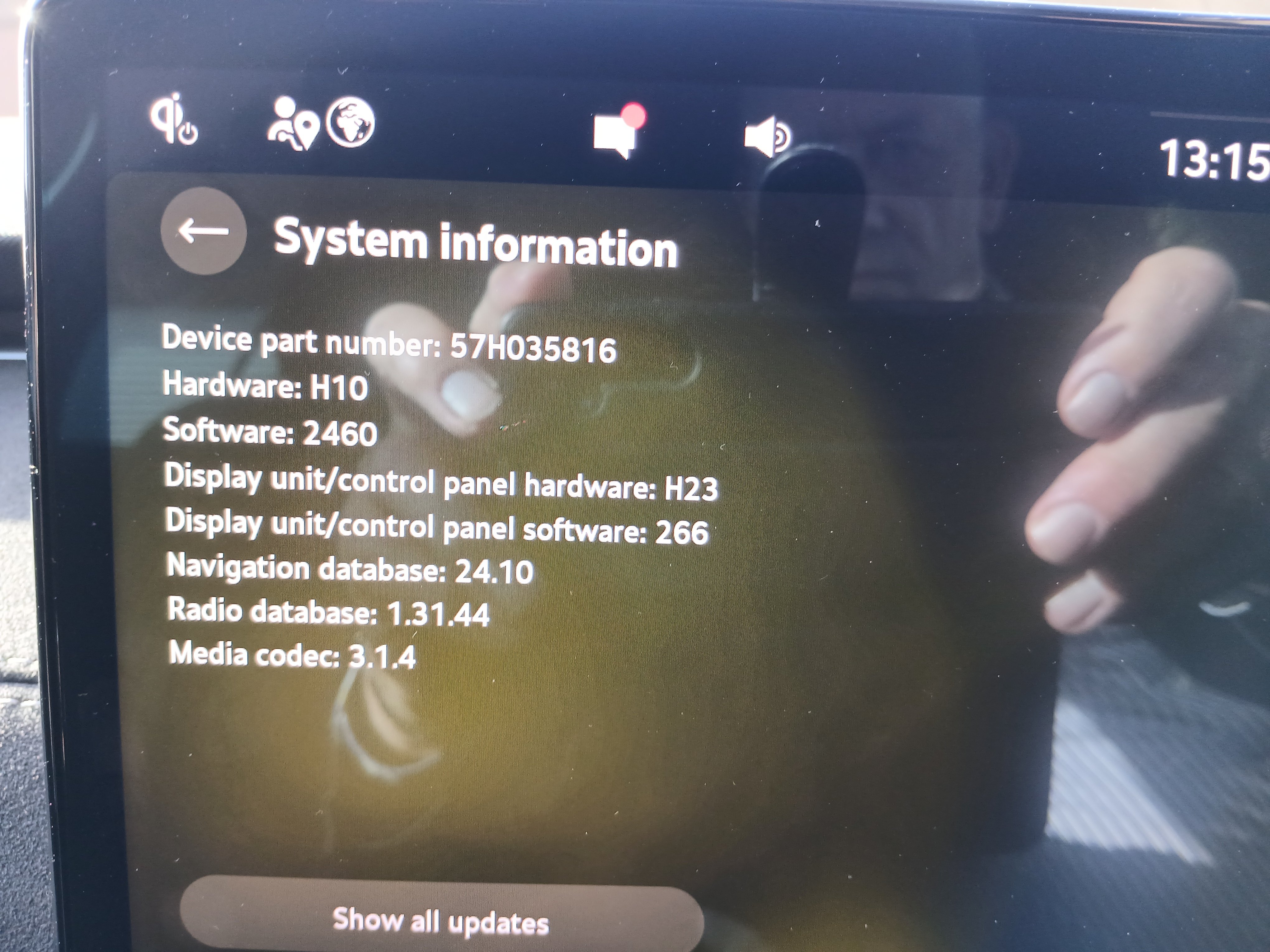

Here is my info on a post face-lift demonstrator first registered 18th June and bought by me from a dealer on 18th September.
Foolishly i didn'trecordthe software level when i got it but im pretty sure it was 1969. It looks as though the navigation database has been updated, presumably OTA, but I can't remember being asked to approve it.
Where has 2460 come from?
Never seen it before.
After facelift there is different tech in Octavias, nothing about pre-facelift is relevant to new cars.
Do you mean to say that skoda actually learned a hard lesson from the previous infotainment system debacle?
I think they have. From what I have seen the infotainment system in the FL Octavia is the same (as in it looks the same) as the new mk4 Superb.
Would make sense if it is as there would be fewer variants to manage updates for.
The FL doesn't look much different on the whole, though.
