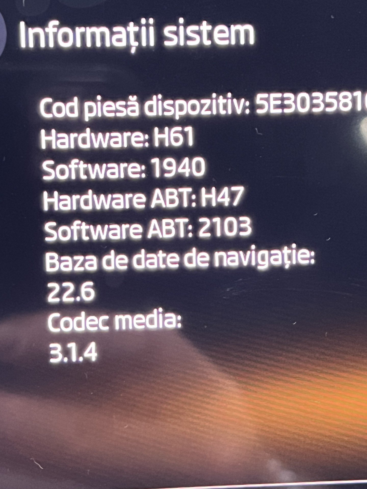

Hi everyone, a couple of days ago, I went to the local dealer to update my infotainment system but unfortunately, the system can't be updated because it freeze. They tried many times to update without success.   My software is1940, can you tell me how to fix this problem?
THX!
They need to replace some components by the sounds of it, I think they may have tripped the component protection, unless someone else knows better.

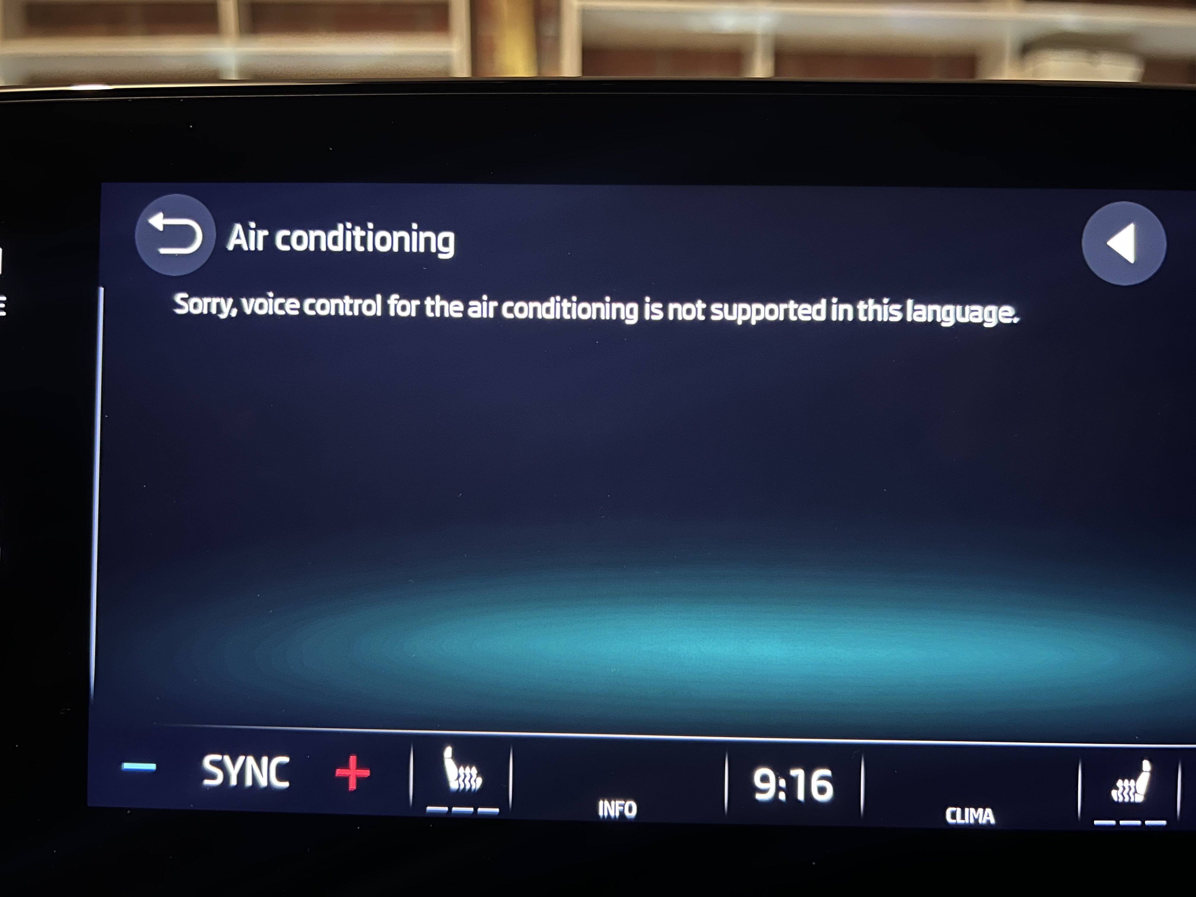

On 08/07/2024 at 11:48, Rickster90 said:
Hi DaveFromSydney. On my MY23 Octavia RS with 1900 software, voice control can’t adjust AC (e.g. set temperature), it says ‘not supported in this language’ . Did you mean that 1941 update will enable voice AC control? Thanks. I’m from Melbourne btw.
Confirm that upgrading to 1941 fixed voice control. I can now voice control AC and seat heating. Audio quality seems improved as well.

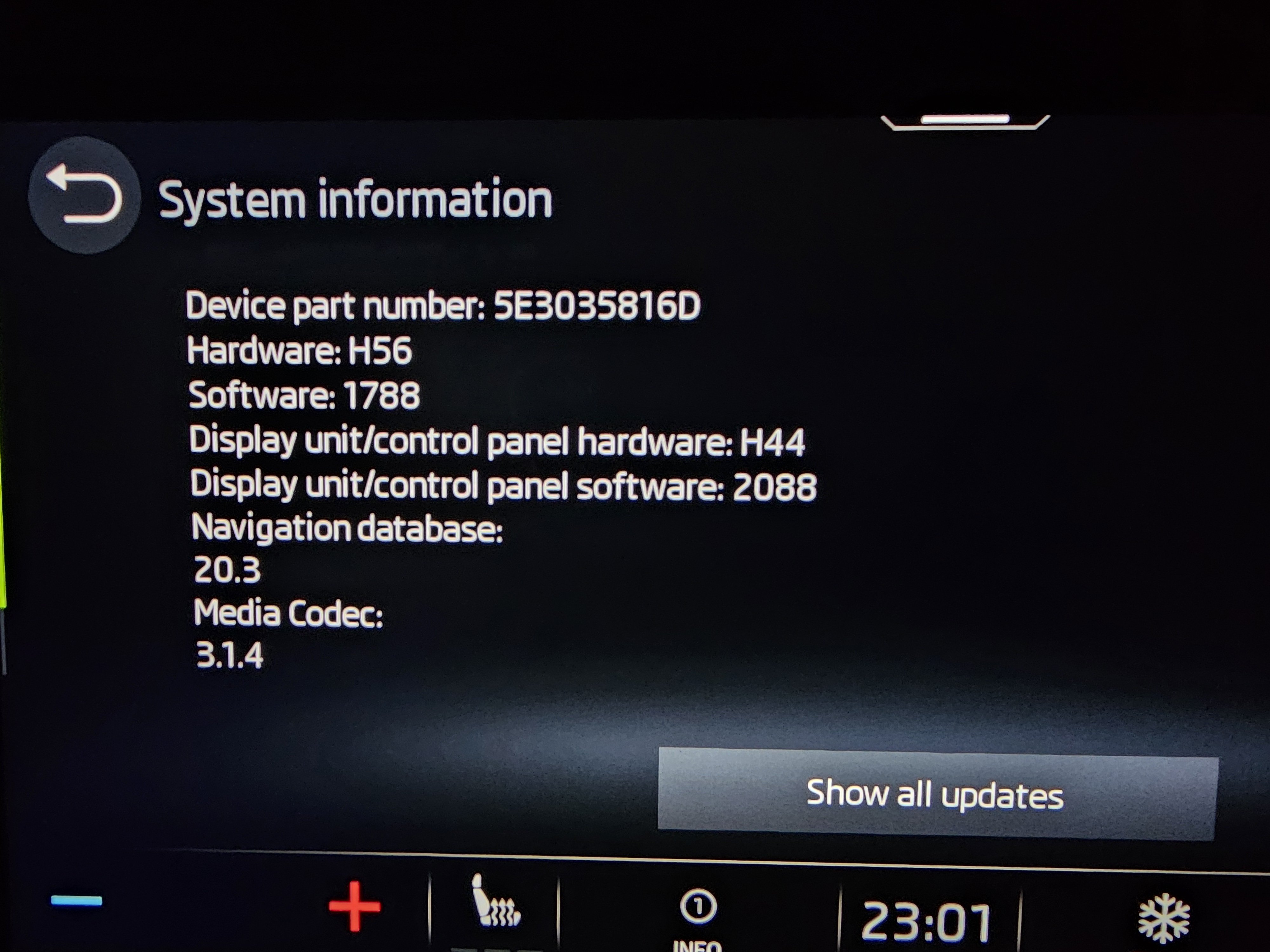

My 2021 Octavia SE-L etech has had some buggy problems with the infotainment system (screen freezing, stuck on loading settings, climate controls missing and can't turn off the cold air, very laggy on startup, unable to raise the volume control for android auto voice assistant so can't hear what it's staying etc) so I read through the threads about this issue and find that recent firmware updates resolve a lot of problems other mark 4 owners have been having. So I called the delearship to ask about how to get these problems resolved as my system won't update over the air and I appear to be stuck on version 1733. I am told that there are no updates for my car, the last update they can see on their system was in July 2021. I said but I'm on 1733 and the latest version is 1969 but they said no, my car doesn't have any updates available and if there were any recalls for known issues it would be on their database. I was told to factory reset the infotainment system as that has resolved any issues that they have ever encountered with it and if that doesn't work I'll need to book it in for a diagnostic. Can someone help me to understand why everyone seems to be getting firmware updates that fix their problems but I am stuck with the old version?
AP1GczPReuWW32IpLMZRpstGR82KUbKAiP4GgVOHiyRJpdzW8Q8sTSbAqZaC5w=w1215-h911-s-no-gm?authuser=0image.thumb.jpeg.73bff777cede593950e0f6856c66b227.jpeg
There are updates in both hardware and firmware for the infotainment system, tell them to look for the TPI regarding infotainment system faults.

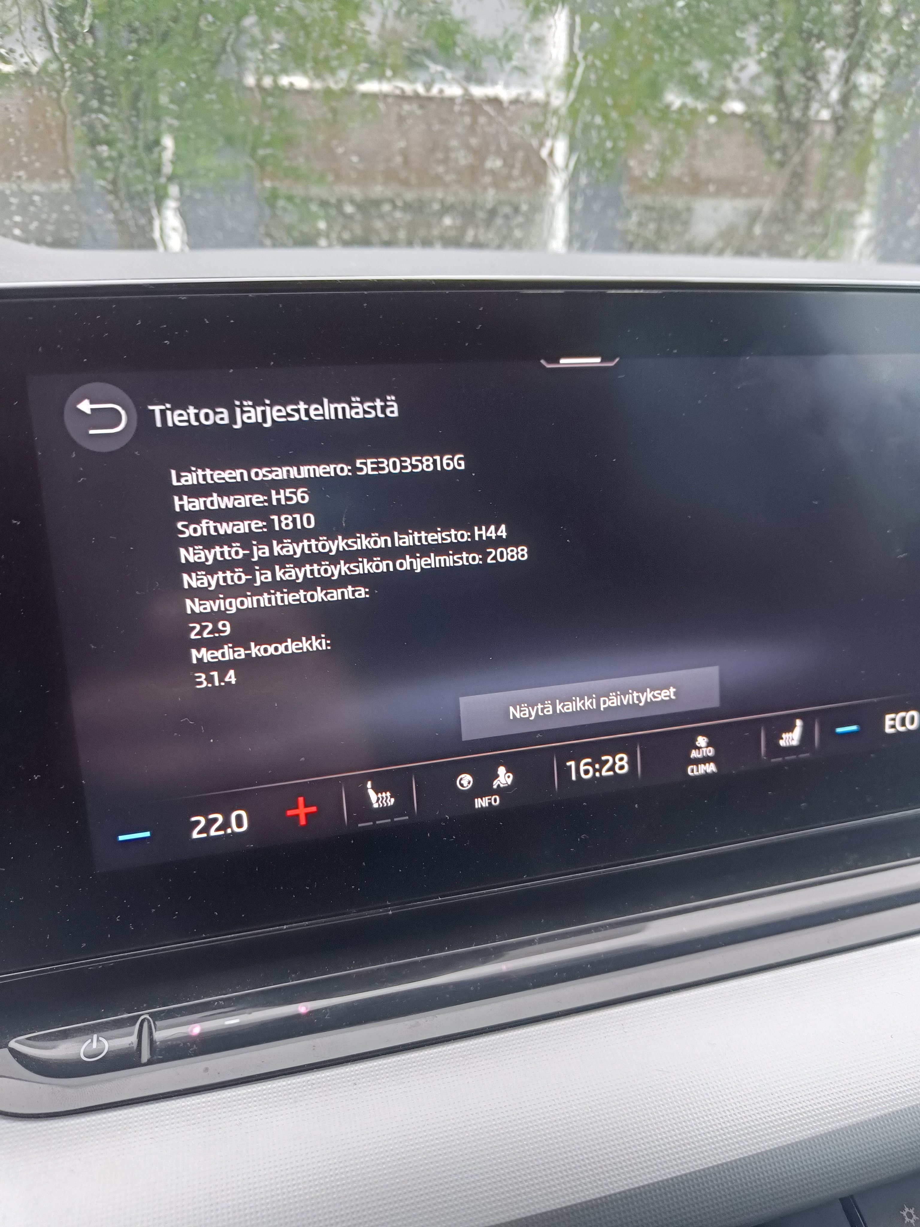

Hello,
i have 1810 in my octavia. can i install 1941 without any problems?
i cant make main user and thats why cant receive any OTA updates.
and is the software same for PHEV and e-tec?
Here is also picture
