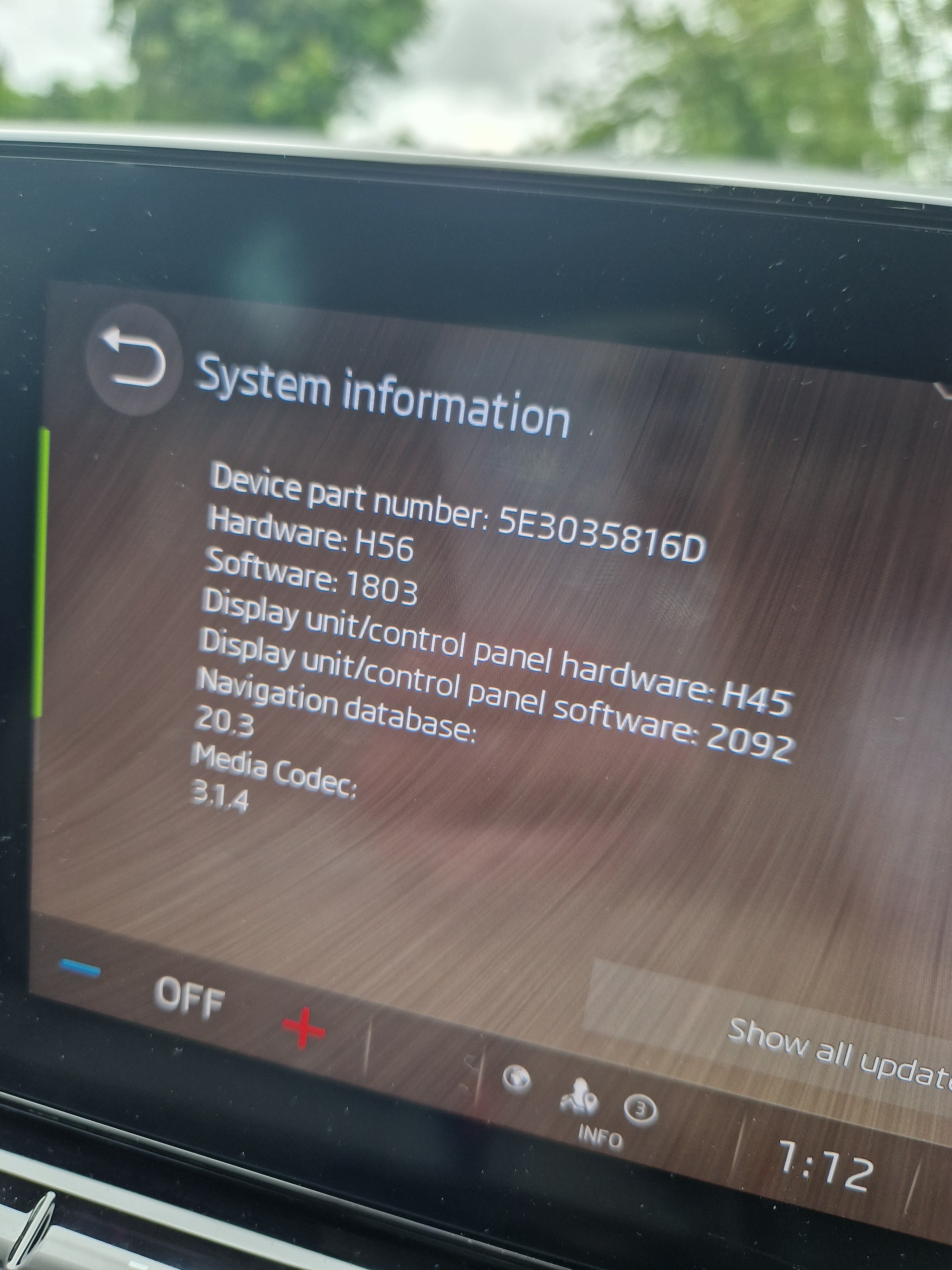

Hello, my car is in version 1803 I would like to upgrade it to 1941 first. Is it risky to do it yourself? I don't have a battery charger, can I leave the engine running?

Based on what I've read on forum. Version 1803 will probably require other software updates that will need to be done by dealer before you can go to 1941.

That's correct. If you have a very low software revision number like 1803 then you'll need to visit a dealer first, so they can do it and possibly replace a component, before they can upgrade the system firmware to higher revisions and then upto 1941 & subsequently 1969 or newer if a newer revision exists.
So apparently I need a new MIB control module, which they can’t get for a month 😞
