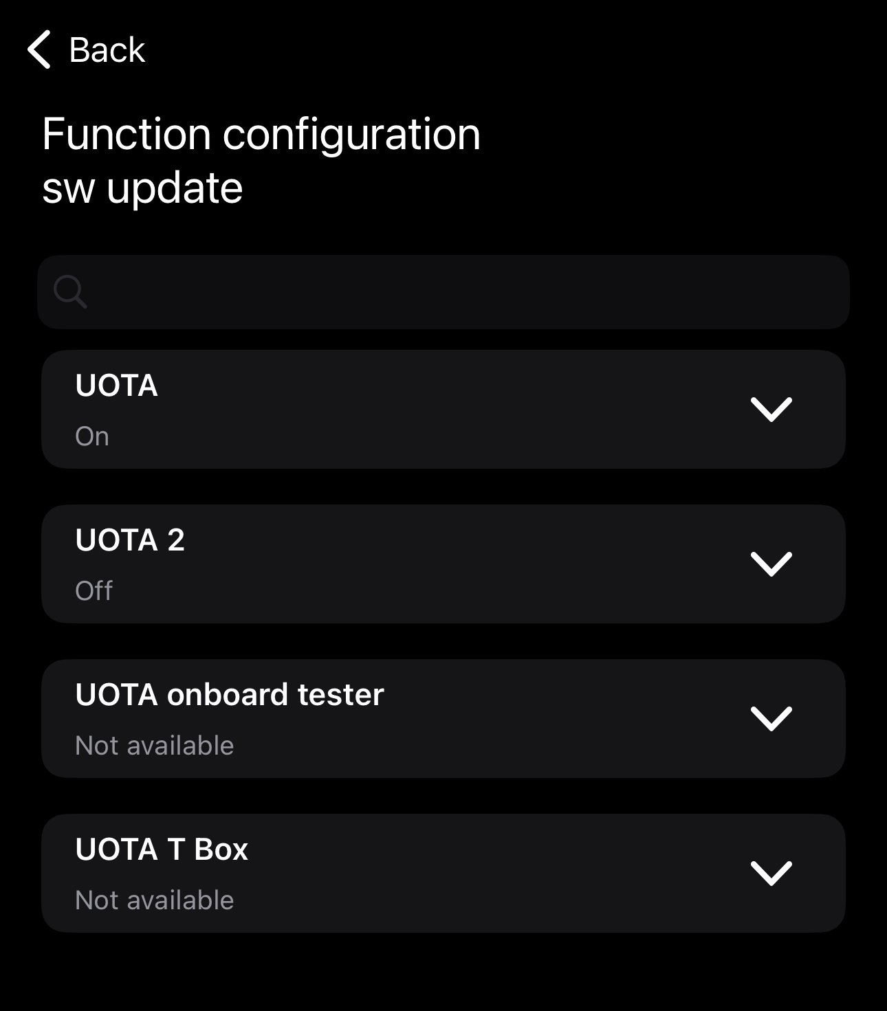

I've looked through the 5f Multimedia adaptions and did see these options but changing them does nothing:
But even if it did, we'd still need Skoda to push updates out over the air for us to receive anything.

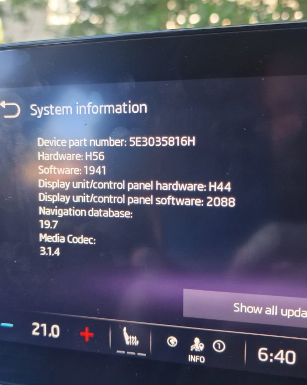

Did they say they will update the MIB to 1969 or 1941? They only updated mine to 1941 becasue they needed to do it for the audio issue.

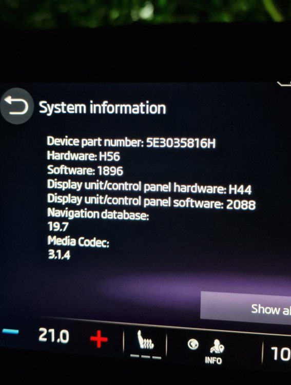

In my car, I have software version 1668, which seems very old. I'm experiencing a lot of system reboots, and the only workaround seems to be disabling all online services by setting the most restrictive privacy mode.
I have requested an appointment with the dealer. Last year, I was told that they managed all possible software updates, but that doesn't seem to be true; software version 1668 appears to be older than 1 year.
HW56
SW:1668
Display-HW: H44
Display-SW: 2088

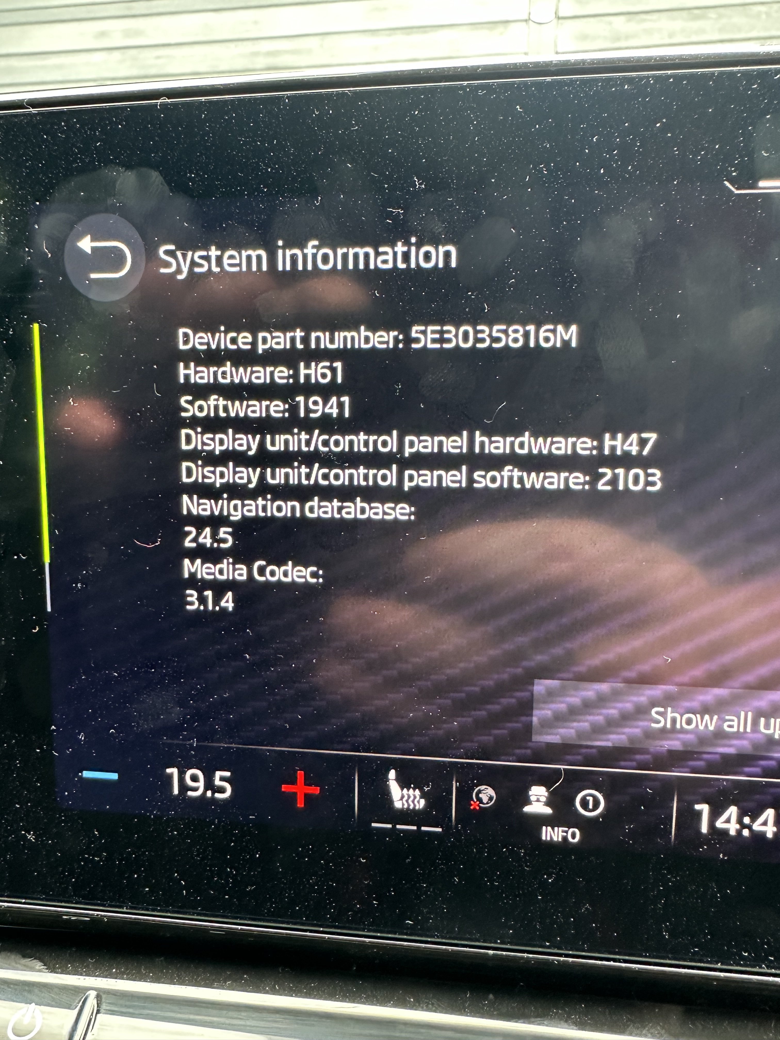

Hi all, new here. Unfortunately I’ve seen this thread a day too late. 1941 installed a few weeks ago on my mk4 vRS and all was fine until Friday, when I had to reset the tyre pressure system after a low pressure warning. As soon as I did that, the infotainment screen started pop-popping and switching on and off, and taking the satnav on my digital dash down with it. Then I started getting PDC warnings over the weekend, and yesterday my screen stopped working completely, alongside new warnings about parking sensors and the SOS system not working. So I suspect I won’t be able to do this update myself as my screen seems to be dead.
Can anyone reassure me that the problems stop with things linked to the infotainment system ? I’m slightly worried about the electronic handbrake suddenly not working, or the DSG being affected.
This is my info, taken when the screen still worked.
Don't do anything, it is covered by warranty so contact the dealers to sort out.
If you fiddle with it in any way, they may claim it invalidates the warranty.
You should be able to get a courtesy car if they need to keep it to sort out
Did you upgrade to 1941 yourself? My experience on 1941 and 1969 with the problems I've had post install, is that I'm going to always do a full factory reset after upgrade. My car (on same hardware as yours) seems to play up until I did full reset both times.
The things you mentioned are linked to Infosys and if that's playing up your likely to get the errors. Handbrake and dsg hopefully should never get affected by Infosys.
Try a full reset of infosys and set up primary user etc again. If like me it hopefully will correct the issues. If not you need to go to skoda
