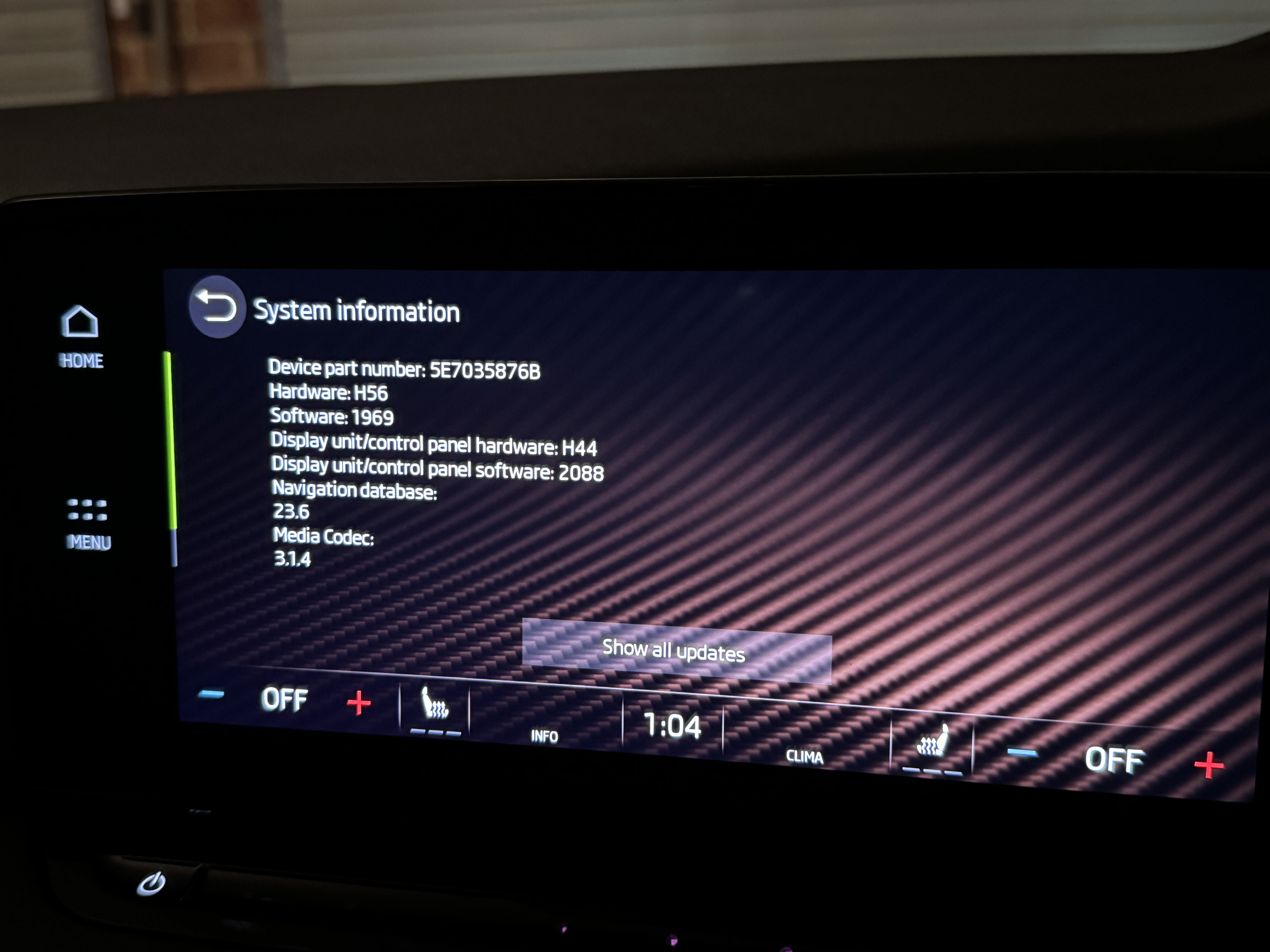

Version 1969 refers to the software version of the Infotainment system. Since launch, Mk4 Octavias have had issues with the system. 1969 is the latest; 1941 was the version that stabilised a whole load of stuff, notable repeated reboots of the system after starting the car.
Do you need to do anything? Arguably, only if you have issues with your car; and then, if under [extended?] warranty still, ideally get your dealer to update it and check for other updates whilst they're at it.

I second the dealer visit for a firmware that old. I've heard that some of the older firmware version' were less stable during the update process and therefore easier to brick a unit.
But have my doubts about any need for a hardware replacement. I'm running 1969 on H56 with an even older display/control unit.
You should only require a new unit if the dealer themselves brick it or there is an actual fault.

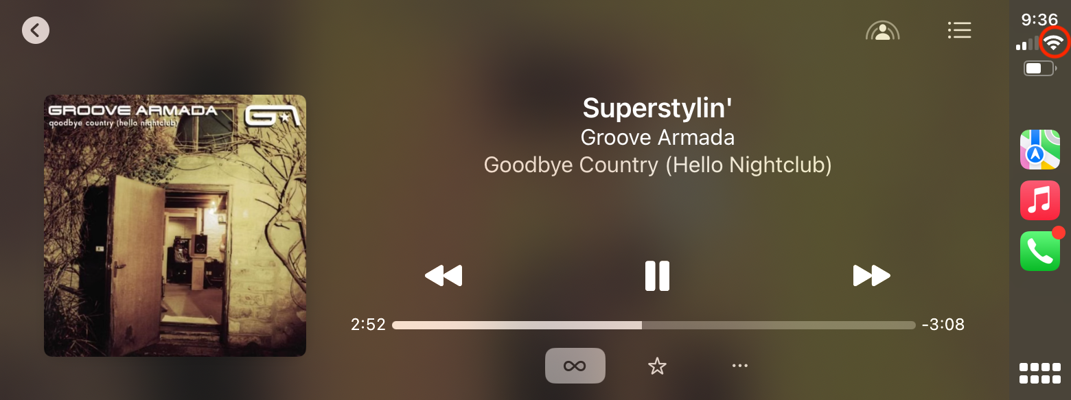

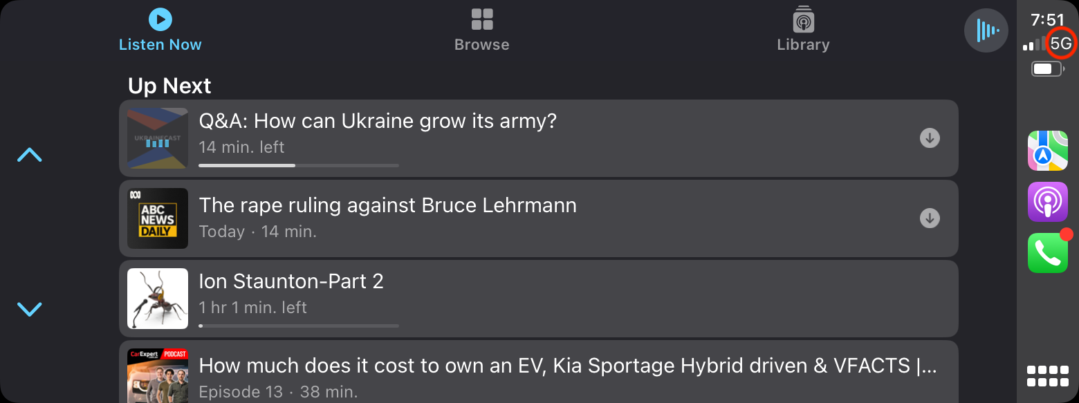

Has anyone else been having issues with wireless Apple CarPlay recently?
The specific issue is that my phone defaults to connecting to the cars in-built wireless hotspot (see the wifi logo circled in red) for data but then nothing loads because I don't have Skoda Connect in my region, so no data.
But you can't switch off the wireless hotspot. feature because then wireless CarPlay won't function.
If I switch wifi off and on again on my phone, it reconnects and a 5G symbol is shown beside the signal strength - all functions as normal then.

I've not had this myself. I'm sure I saw a setting in the Infotainment system relating to using the car's data connection and on mine it was turned off. Maybe it has been turned on by accident?
Or alternatively which version of iOS are you on? I'm on 17.4.1 but I notice there is 17.5.1 waiting for me when I want to install it so maybe it's a bug introduced by that new iOS if you have installed it?

I had the same issue and live in a country with no Skoda Connect. I just forgot the car and repaired carplay. it stopped connecting to the wifi after that.

Yes. In 🇬🇧. Started about 10 days ago so sort of matching release of iOS 17.5.1 but I’m still on 17.4.1. Slow to connect to car. Sometimes black screen instead of CarPlay. Sometimes starts ok then reverts to black after a while. Even though iPhone screen has CarPlay icon still ‘working’.  Nothing reported yet on macrumors 17.5.1 bug forum https://forums.macrumors.com/threads/ios-17-5-1-bug-fixes-changes-and-improvements.2426949/.  I’ve been on 1969 for over a month so I’m really not sure what to blame. Have ‘forgotten’ car and re-connected but it’s started again

I'm on iOS 17.5.1.
WiFi is required to be on in the Skoda infotainment unit. If you try connecting wireless CarPlay with it off, it prompts you to turn it on.

I have tried repairing it, but it eventually does it again. I usually only have to deal with the issue when I get in the car for the first time that day.
The quickest fix for me, is to turn Wifi off and on. It disconnects then reconnects and all is good.
