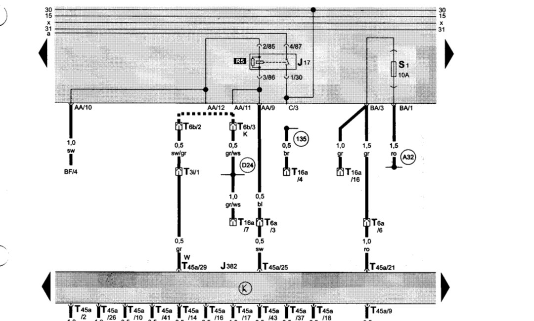

Skoda Felicia 1.6 fuel pump problem
Here's the diagram. The R5/J17 relay on the top. J362 is the ECU The "a" connection then continues to S4 fuse, which also powers injectors. Makes me think if someone connected it right to the 15 lead to bypass the immobiliser (not sure if it disconnects just the fuel pump relay or disables injector outputs, too on the 1.6)
I can't hear the relay clicking, but there is a relay in the fuse box, and I tested it externally and it's good, so I've concluded that I either need to take it from the ECU cable or from under the steering wheel.
Maybe he connected legs of relay. Can you hear pump relay disconnecting after couple of seconds? Or maybe there is no relay just jumper.
LeadDiplomat replied to codepass's topic in Skoda Favorit, Skoda Felicia, Skoda Fun and Skoda FormanOk so the car works, but that is not a relay issue in my opinion(i know only basic electrics so take this with a grain of salt) what he probably did is that he spliced a triger wire from the ecu to ignition 12 volts, prob becouse of ecu issue. What u can do is try and find where he spliced in(def a dashboard out job) and add a basic switch so u can manualy control the priming of the fuelpump(race car style 😉), or rewire the trigger wire back to the ecu and chase the accual issue. As for the manuals have u checked malualslib or scribid?
Yes, it works, but I want to leave it like new since it could affect other things in the long run.
LeadDiplomat replied to codepass's topic in Skoda Favorit, Skoda Felicia, Skoda Fun and Skoda FormanDoes the car run like that??
I mean that the pump doesn't stop after 2 or 3 seconds, it stays on all the time, and that's because the previous owner left it permanently on.
LeadDiplomat replied to codepass's topic in Skoda Favorit, Skoda Felicia, Skoda Fun and Skoda FormanWhat do u mean directly?? if the engine dosnt flood with gas, my guess wuld be fuel pressure regulator just returning the gas in the gastank
