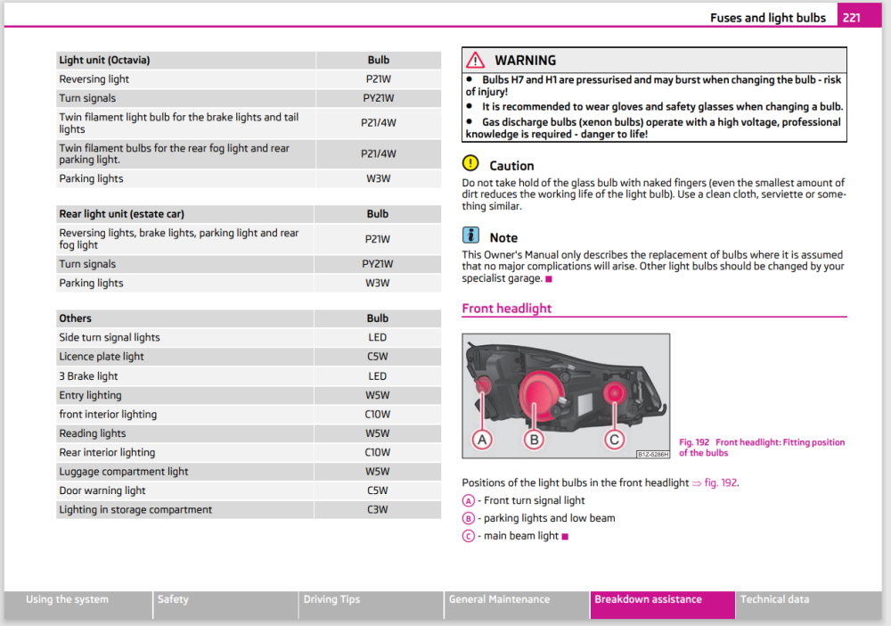

  16. Don't touch byte 18 is it's set to 00!! Changes are irreversable and you'll probably need a trip to a dealer or someone with ODIS-e/VCP to fix it... The 2011 owners manual I have suggests you should be using W3W bulbs not W5W. I'd change those to the correct bulb and see if it resolves the warnings:
