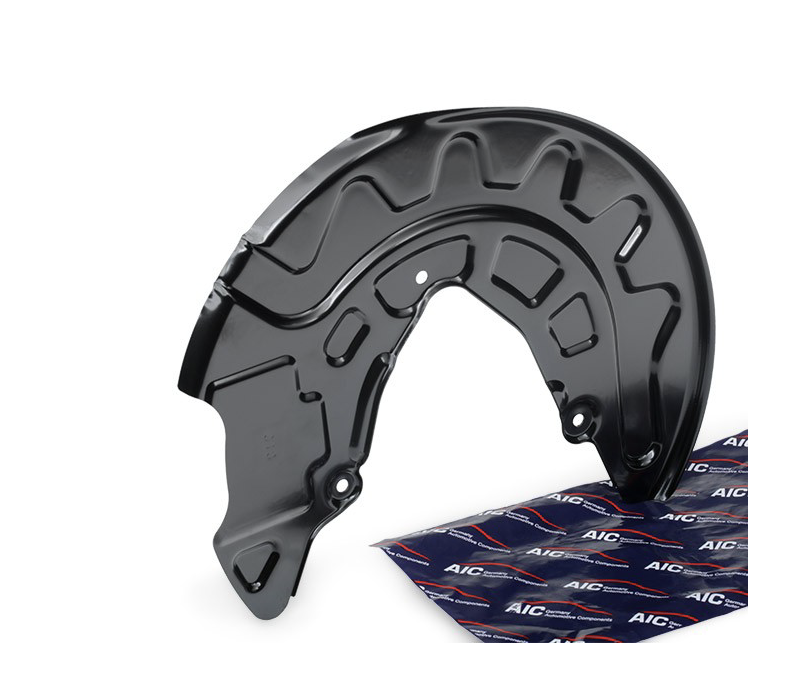

Mine are pretty rusty and given that I need to replace the disks and pads soon was wondering if this an easy enough job to install the new brake disc shields or is it more involved job, like taking the hub off? Pic for reference.

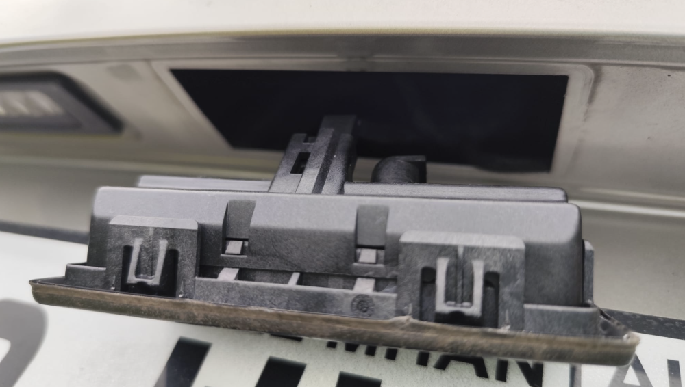

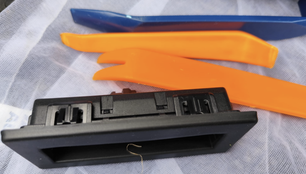

Need tailgate handle for superb hathback
As above, just fitted one and it works perfectly.
Replaced the boot switch as the old one was acting up. The same switch failed on my wife's Superb about a year ago. Very simple job and part is available on Amazon for €20.

Boot not opening via handle
Mine just failed yesterday, you can buy them on Amazon for cheap. https://www.amazon.co.uk/dp/B0B1845DN9?psc=1&ref=ppx_yo2ov_dt_b_product_details
