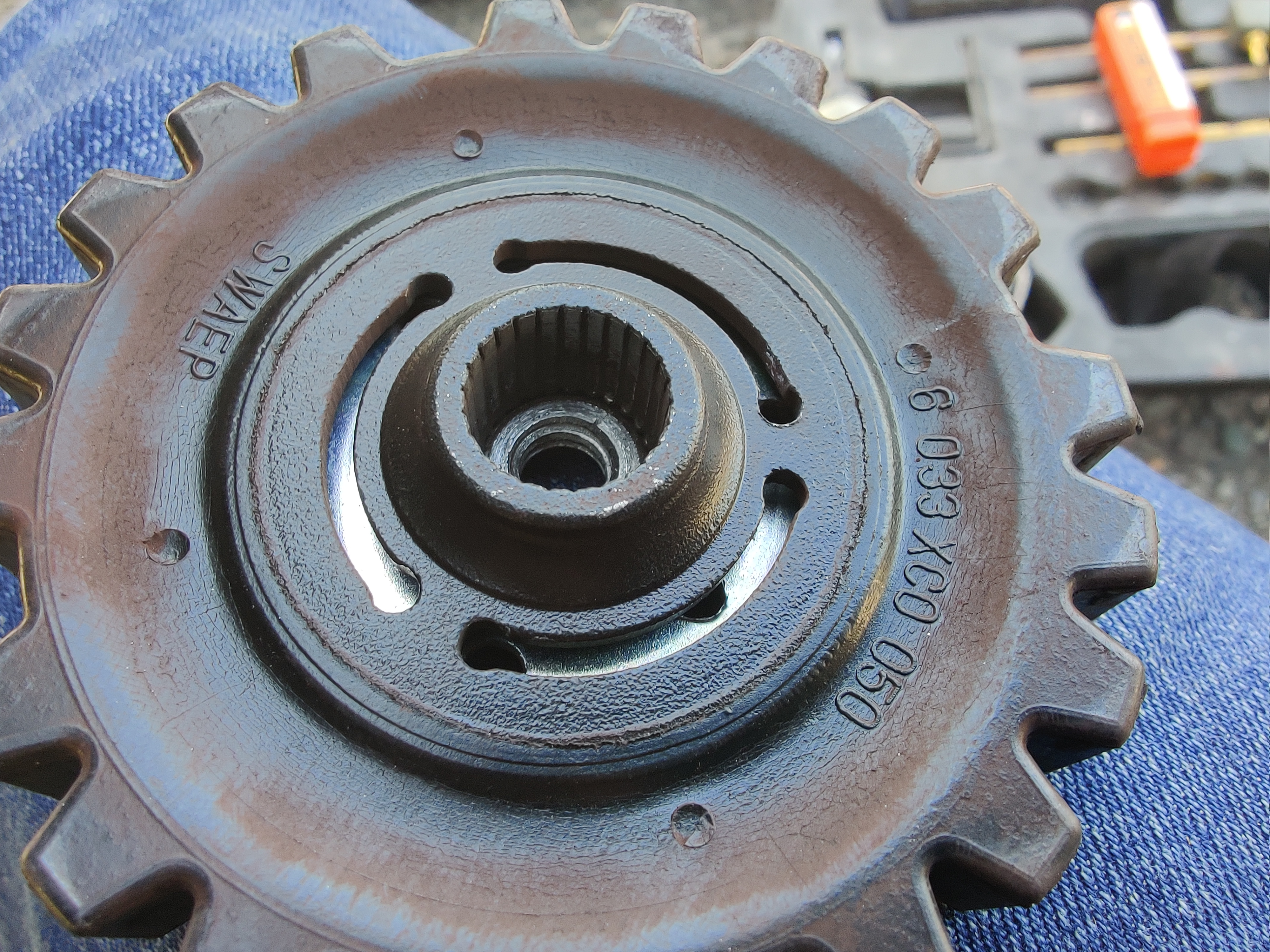

  19. It could be a problem with the clutch or hub. I have had a similar issue which was due to the splines on the hub stripping. Is there any change in engine note if you cycle the aircon on/off? If not it's almost certainly an issue with the drive.

  21. My Araldite fix lasted 10 minutes I guess trying to deal with outdoor temperatures around 28 C was too much for it.
  22. I have a new hub ordered, I found a place in Italy that actually carries Zexel spares rather than aftermarket knock-offs, so I only need the Araldite to last a week or two. It's also one of the industrial grades of Araldite, not the consumer-grade sh!te and it's pretty strong stuff having used it at work a fair bit. Long term I'd expect fretting to do for it as you say, we've seen this ourselves at work, but it lasts longer than you might think.

  24. The thick plottens. I took a closer look at this this evening, on the assumption that the hub had failed the same way it did two years ago I was planning to stick it back together with some Araldite 2014-2 until I can get a replacement shipped to me. It was not the same failure though. The splines in the hub had stripped! It was a real pain to get off as there was nothing I could use to counterhold the compressor spindle while I undid the bolt. In the end I drilled into the hub enough to be able to grip on the shaft and got it out, to discover the stripped splines. Given the current high temperatures we're getting, I wanted to get it back running some bit. The compressor spindle turns quite freely, no indication that anything's up there. I used a trick we've sometimes used at work to make adapters to grip unusual objects with a ratchet: I put a layer of vegetable oil on the compressor spindle splines, and put some Araldite inside the hub on the splines, then reassembled the hub. The Araldite should mould itself to the shape of the splines on both sides when it sets, and the veg oil acts as a release agent for the Araldite later when I need to remove it and fit the replacement hub I've just ordered. I think I'll get it regassed then once it's back up and running fully.
