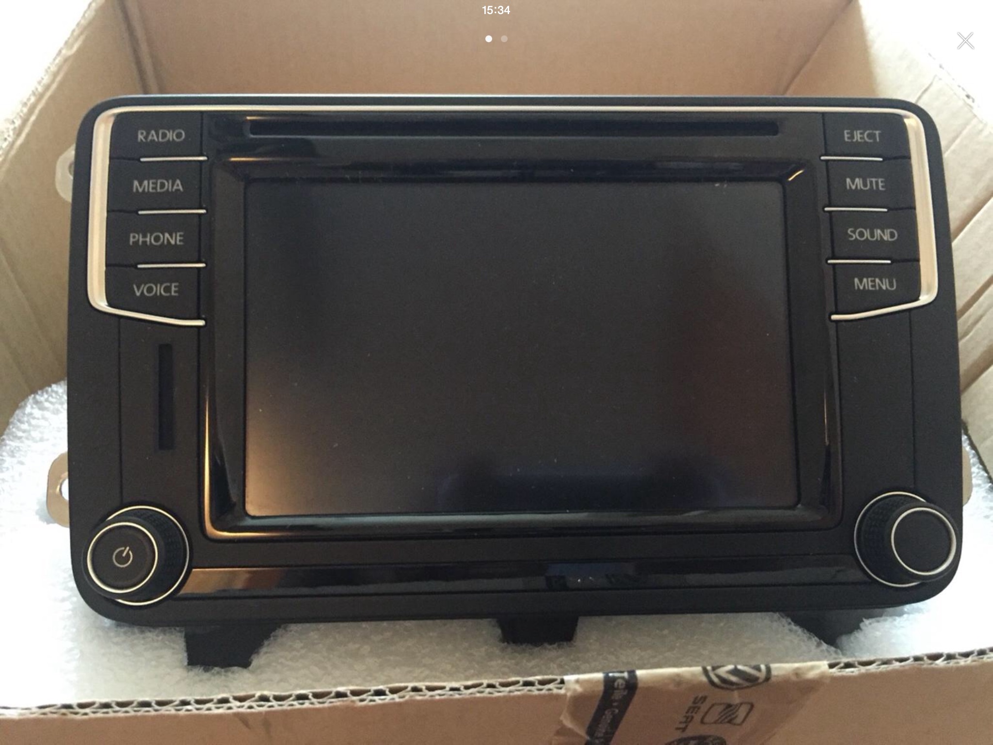

Hi everyone is just bought a a Skoda Octavia VRS 2011 but It doesn't have DAB radio. I,m wondering if any can tell me if This VW headset will fit? The models is a 5K7035200E. Any help would be greatly appreciated
No
It'll fit physically, but it won't work. First thing it'll do is flag up Component Protection Activated on the screen and mute the sound. If you go through Skoda main dealers to ask them if they can code the unit to your car they'll generally decline.
