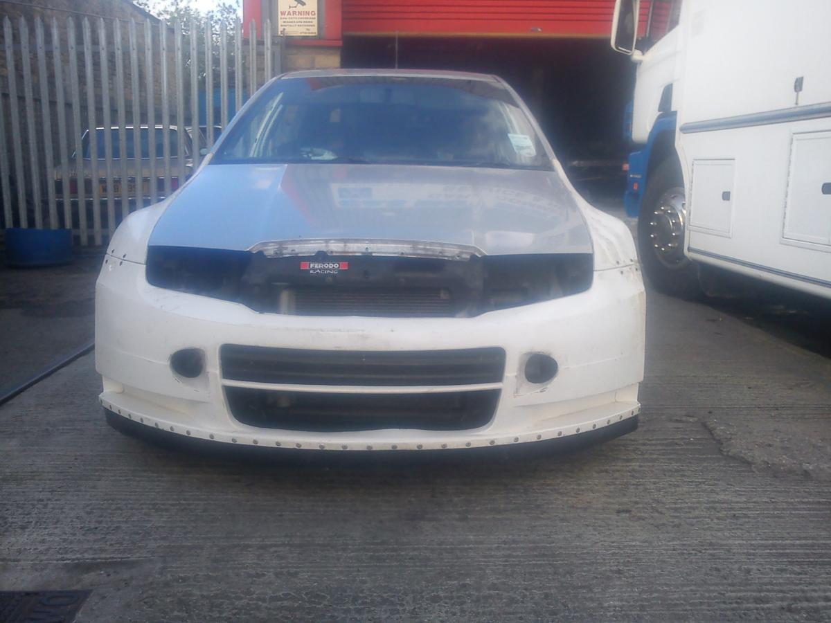

Big stripdown for paint tomorrow so its all good to go next week

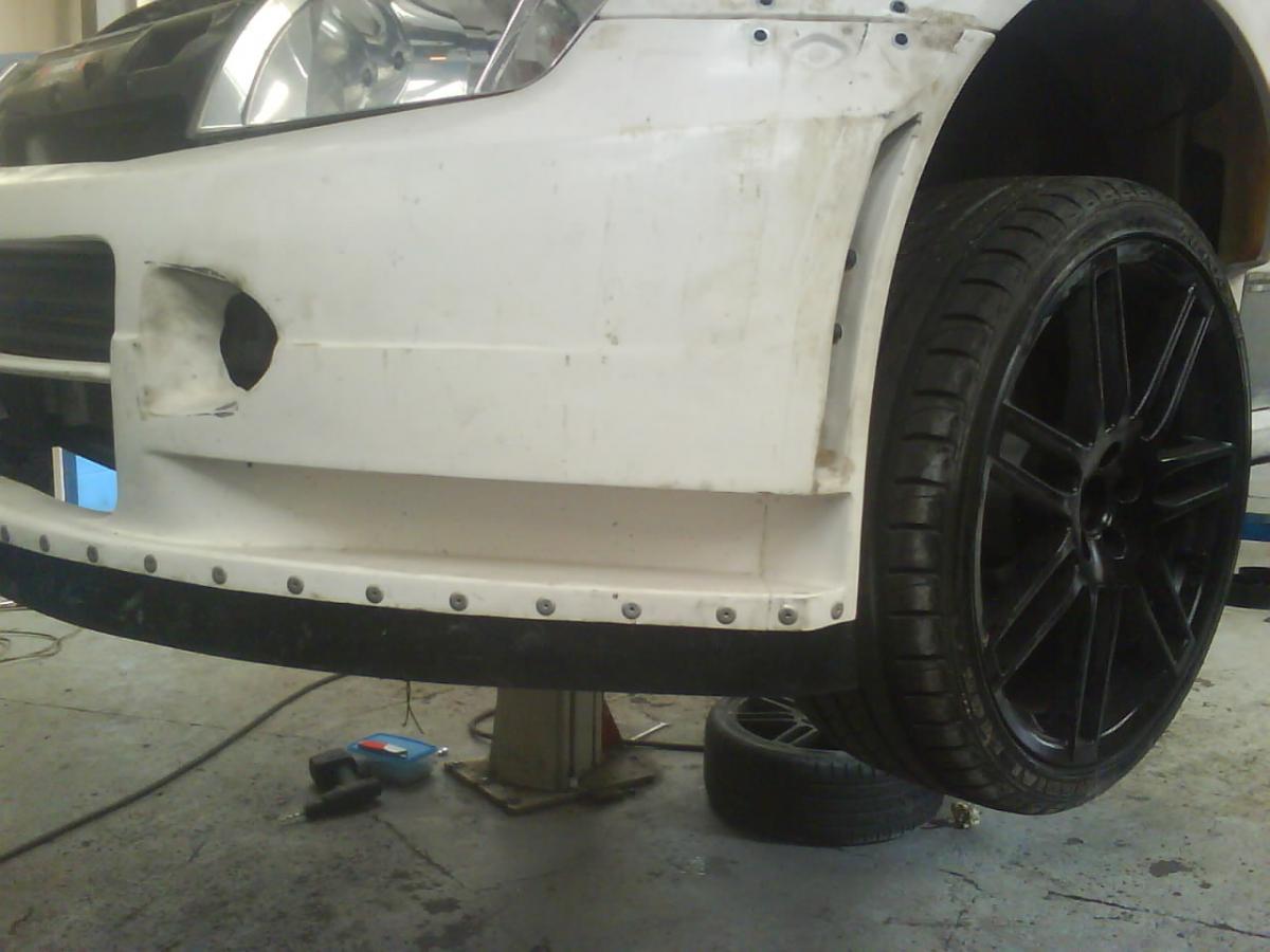

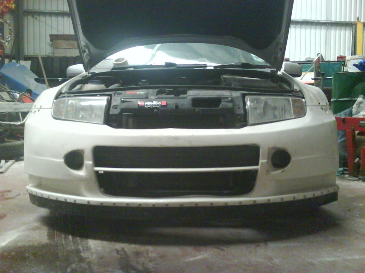

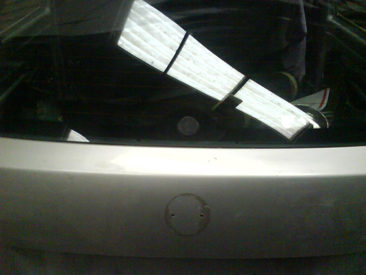

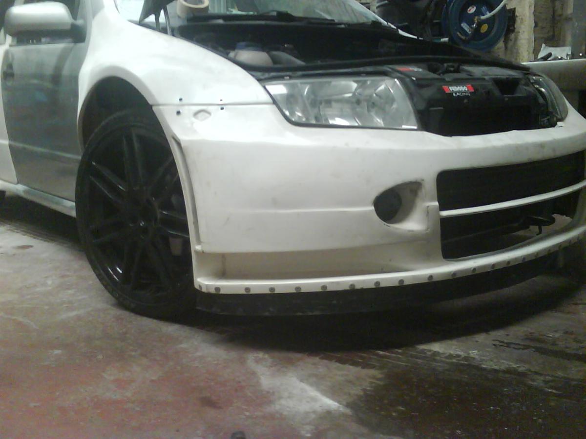

My painter has gone away for 2 weeks  :doh: on the plus side it gives me more tinkering time here's some more pics from todays work
De-wipered

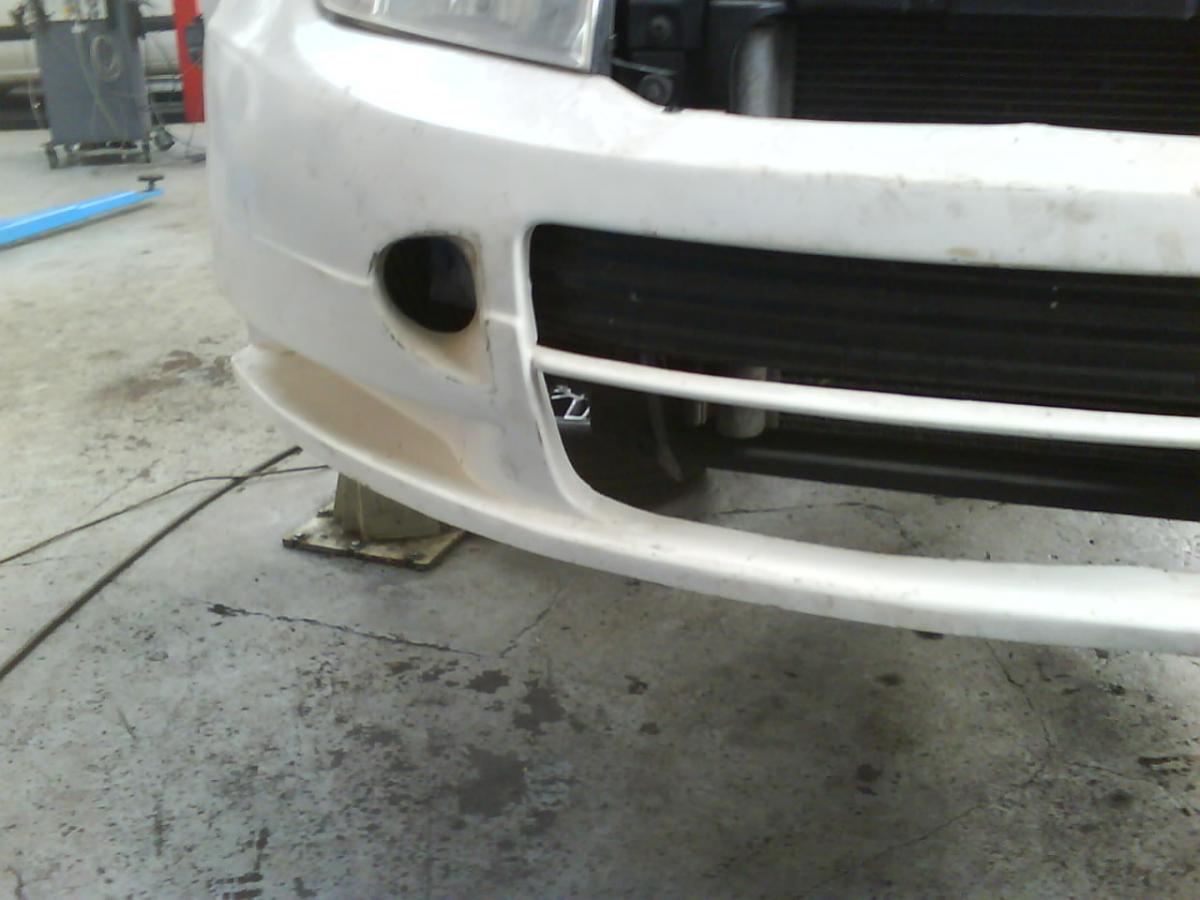

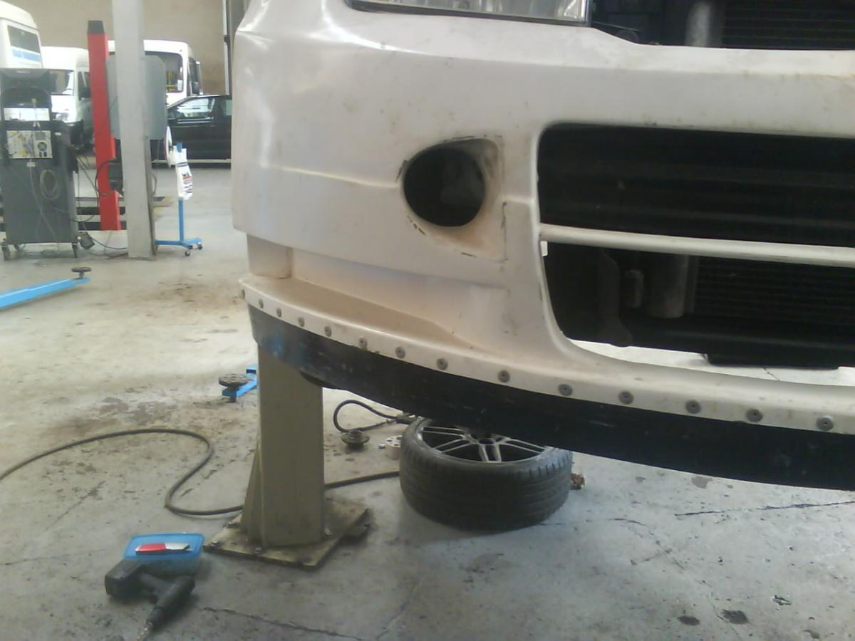

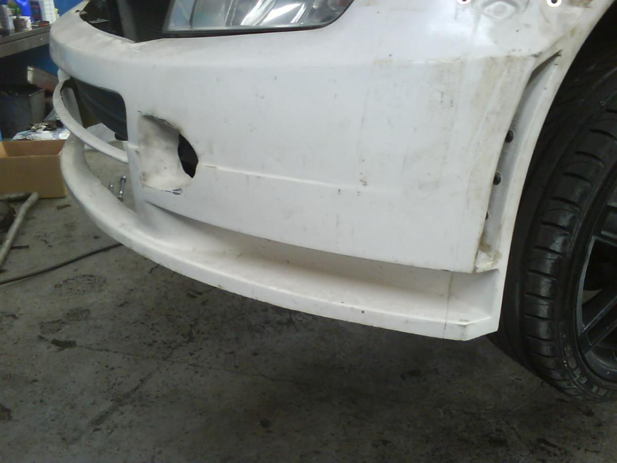

Before and after fitting the front bumper skirt

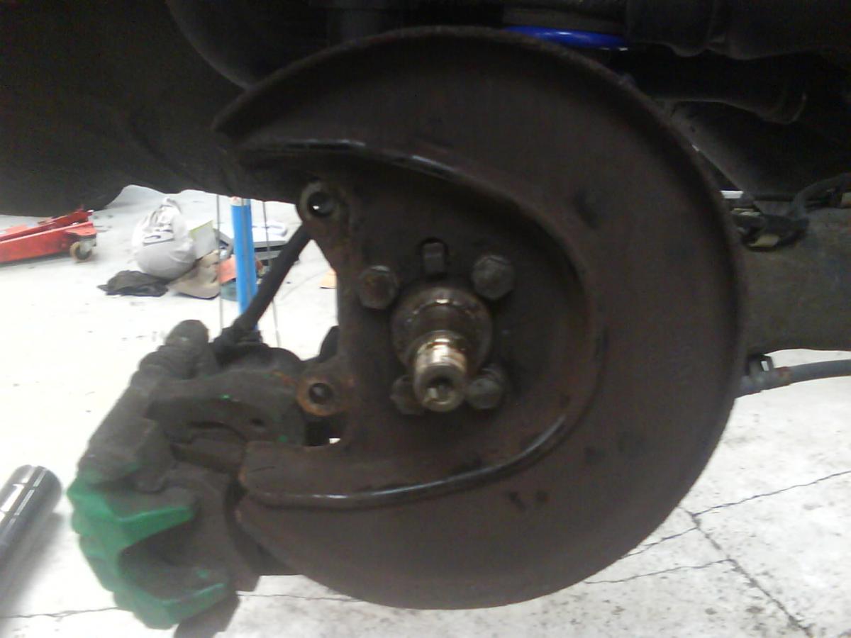

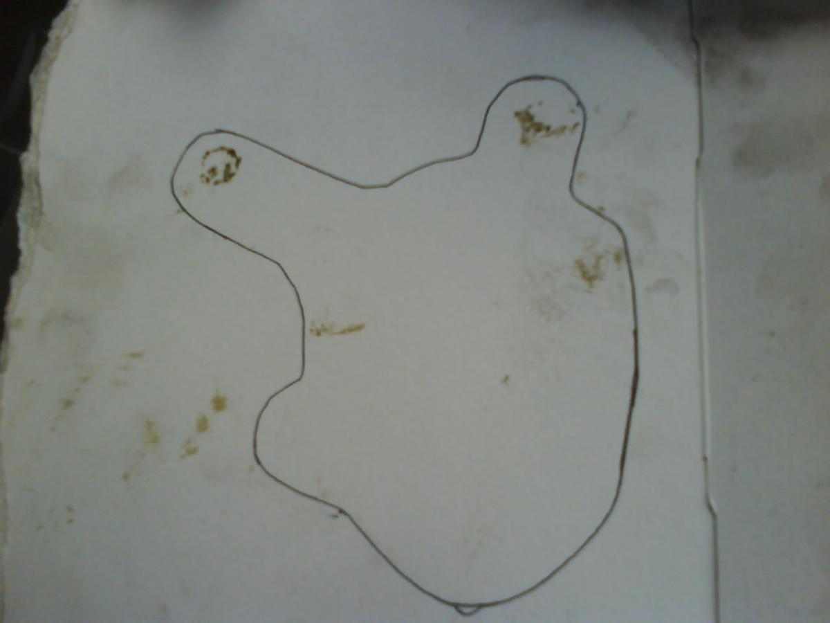

Template made for axle to stub axle spacer, will get this laser cut out of 20mm steel this week hopefully then drilled so I can bolt it inbetween the two
sorry for the poor quality pictures, they were taken on a 2mp mobile phone which I'm currently having to use due to me pooring all my money into the car :D
What you going to do with the ABS sensor when you fit the spacer?
Abs sensor is bolted to the hub so its position won't be any different
Looking mint already. Very very jealous!
If you space the rear stub out, the wire will need extending to the abs sensor :)
abs sensor wire has plenty of excess length to play with so no extending is needed luke
ABS sensor is located to the bearing seats. When using the pad will not change the distance between the sensor and the ring.

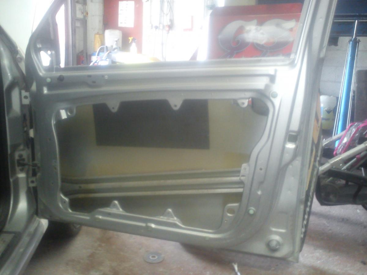

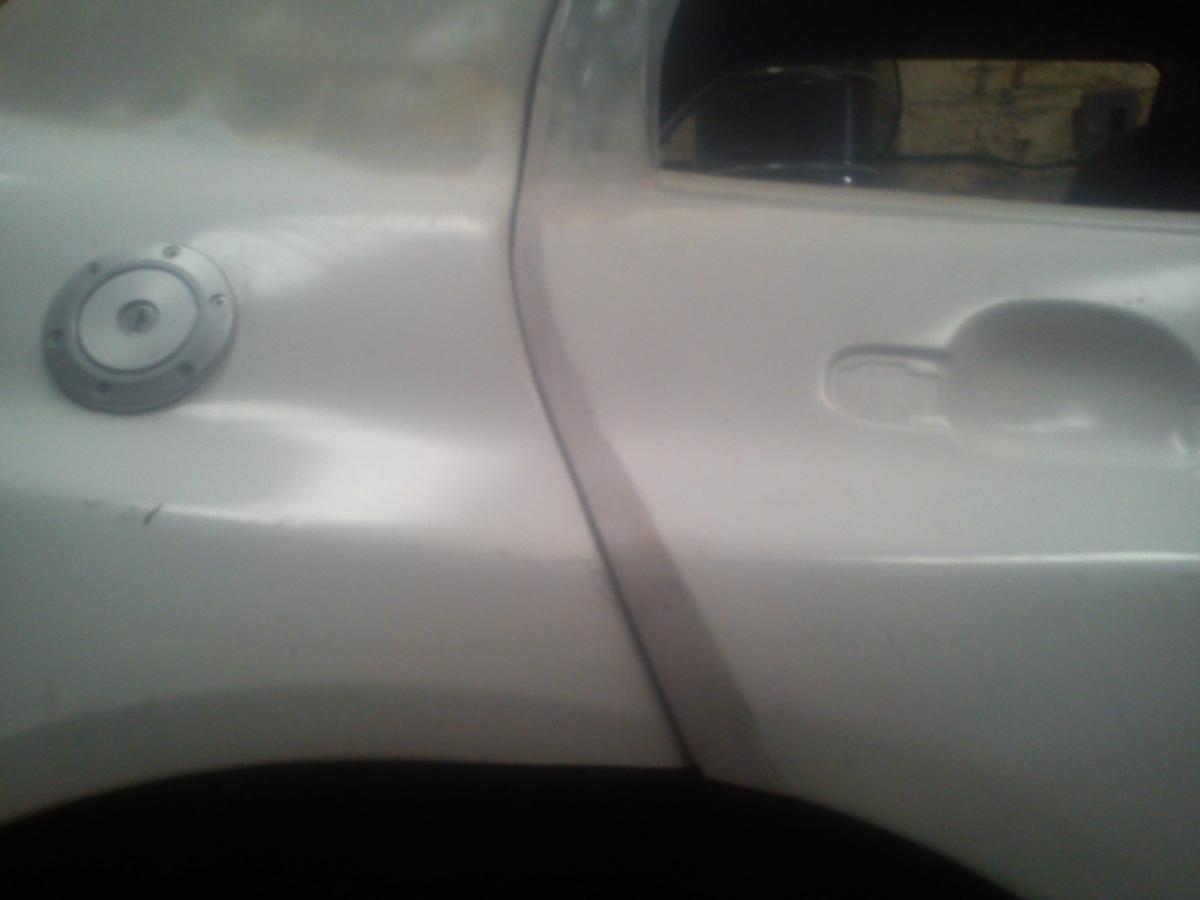

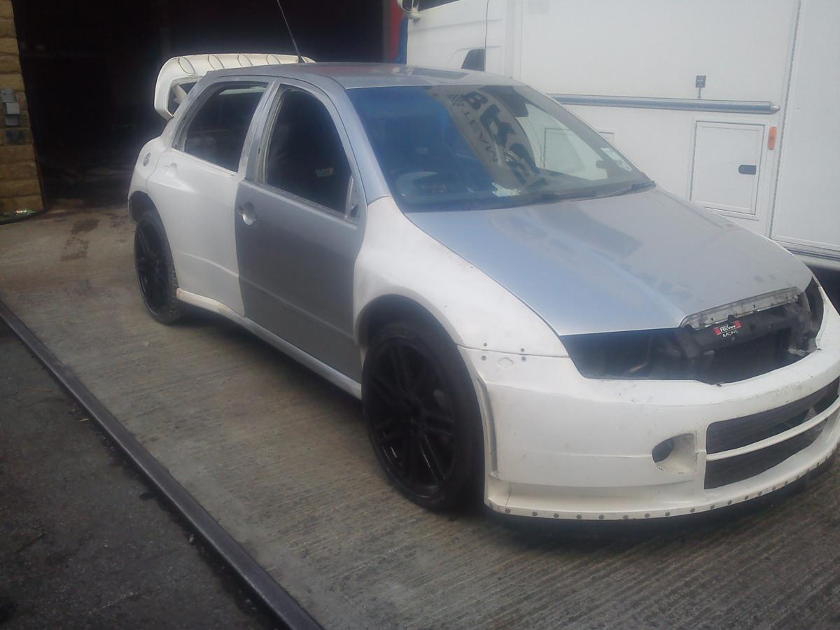

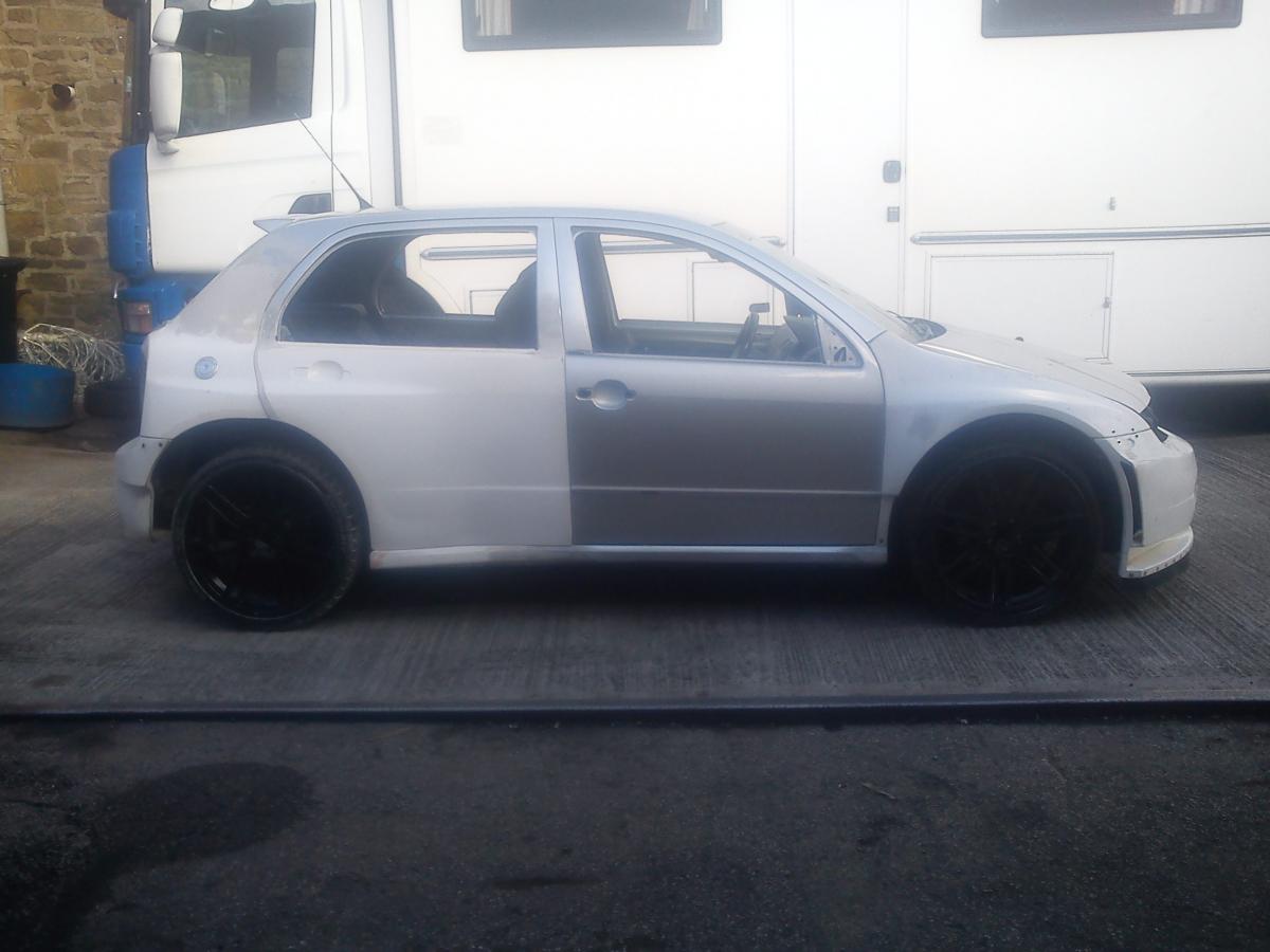

A few more pics, 1) door gaps on the rear were very large so managed to get them alot closer by adding a piece in. 2) front doors fully stripped out
Ready to go to piant next saturday

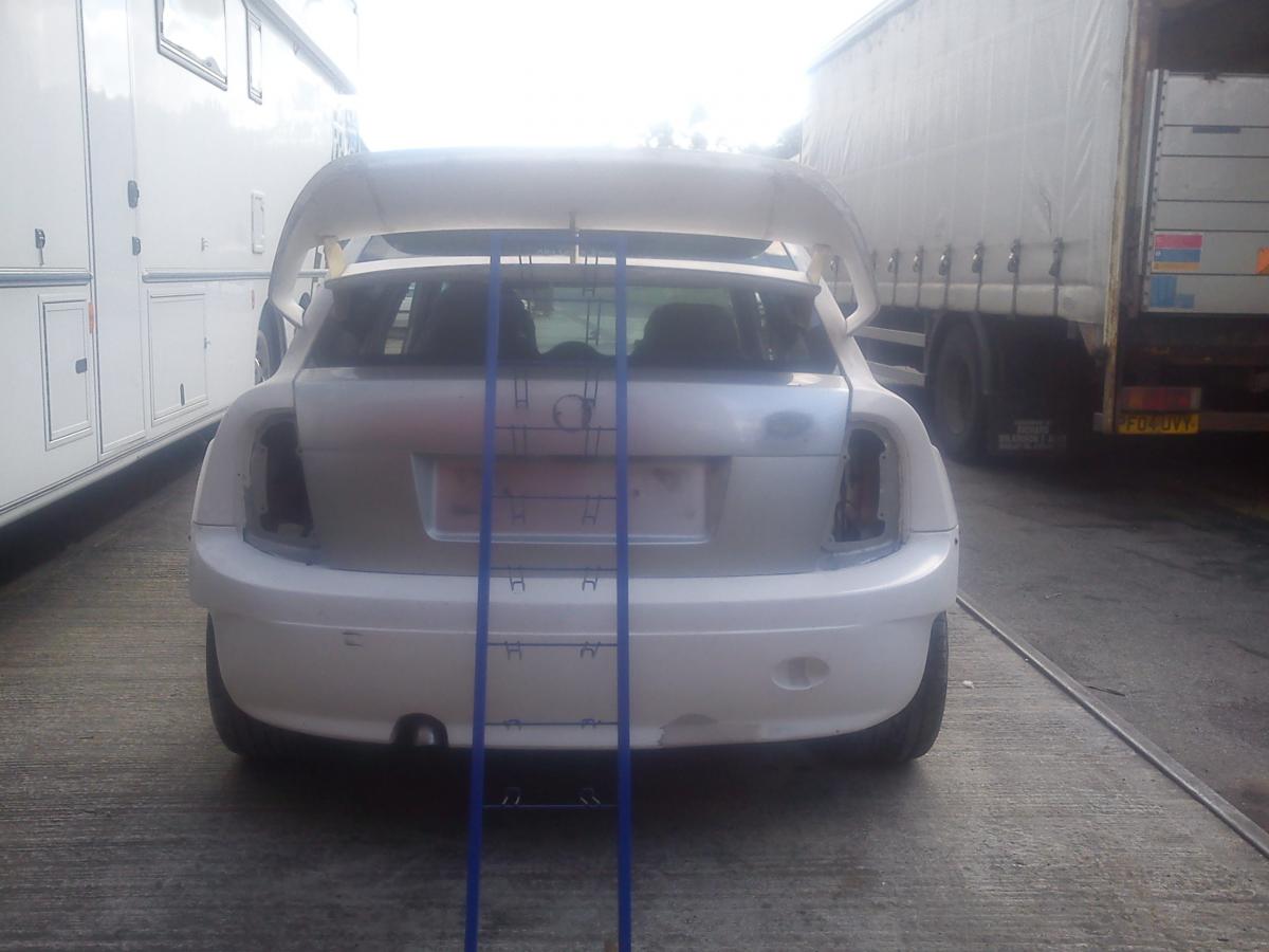

Couldn't help myself lol
