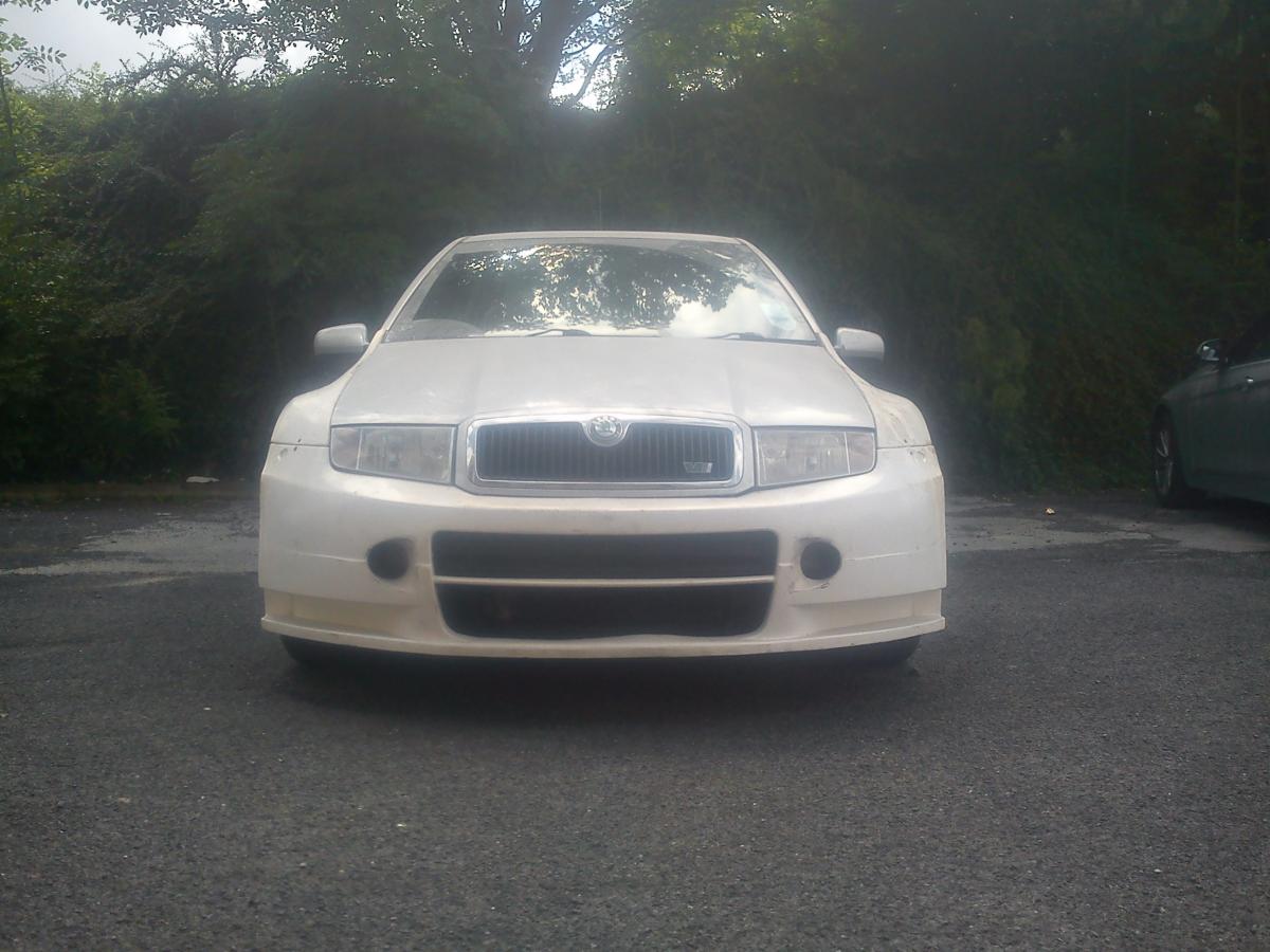

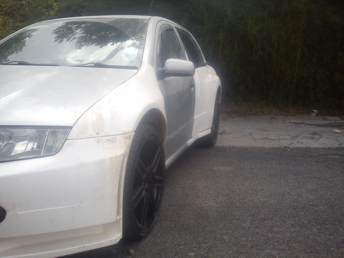

I don't understand why the bumper dips inwards? Looks strange to me. Anyone know why it does that?
The dip above where the exhaust originally is ? Looks like that's where the tow eye goes on the rally cars

Because its made like it?
It will look right when the wheels are spaced out.
http://www.ewrc.cz/ewrc/show.php?id=10344
Some have mud flaps too but i like the exposed look like in the link above.

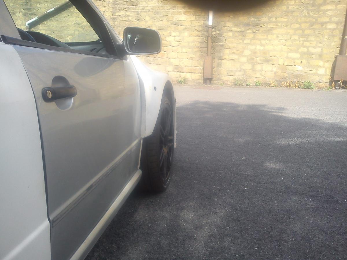

Your right. That looks better lol. I forgot the wheels hadn't been spaced yet.

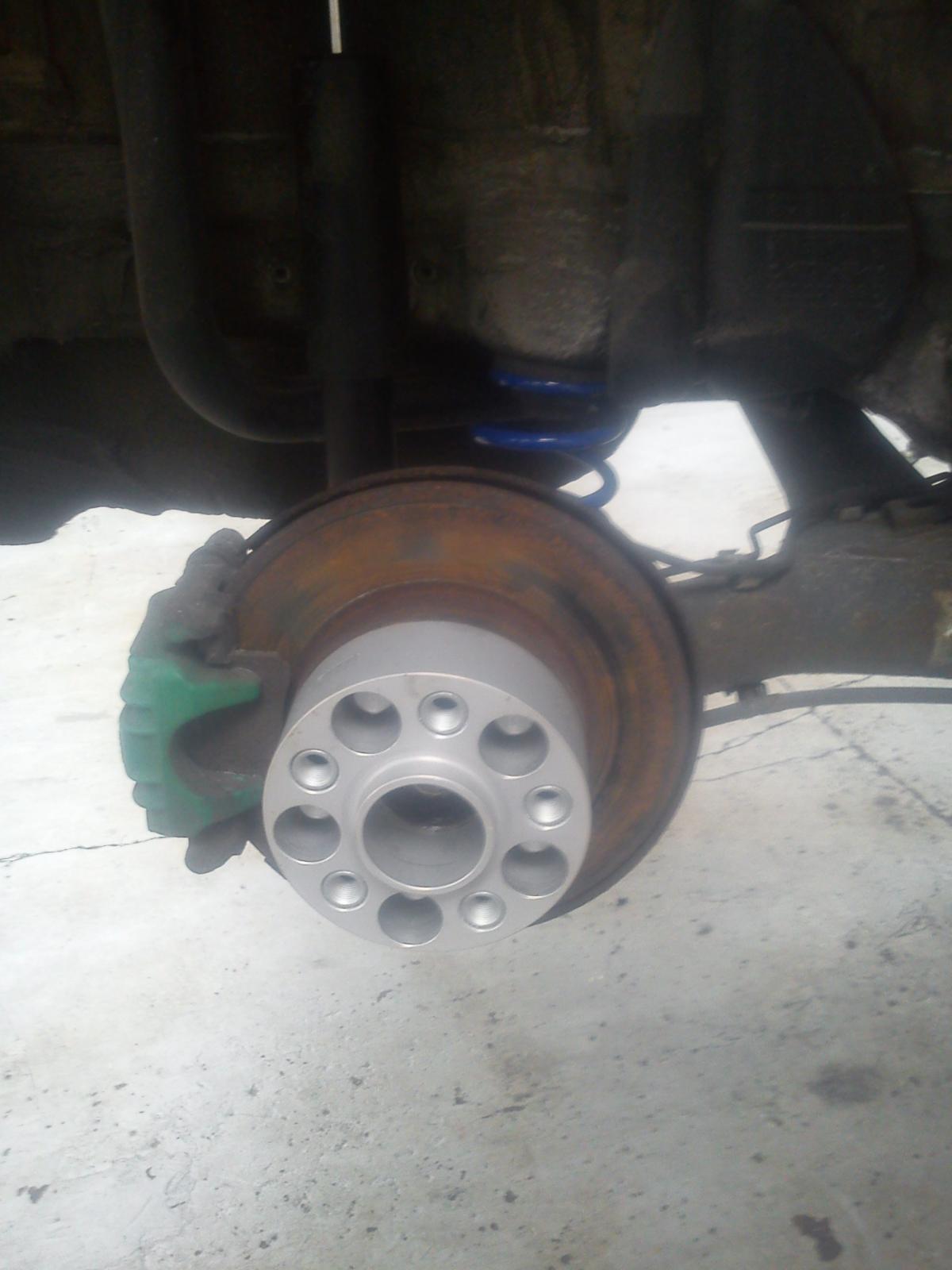

The spacers are 50mm per corner so 100mm widening on each axle mark
Been keeping an eye on this project and looks like it's really coming together, can't wait to see what it looks like when finished  :rock:
Spot on iann, I filled mine in though as I didn't want to fabricate a towing hook
I'm sceptical how the car will perform with those spacers.
There hubcentric on both sides so should be ok. can't handle any worse than it did befor ( very understeery )
The suspension should now be softer with them fitted as the distance between the spring and wheel has increased.

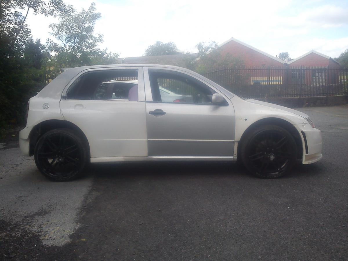

coilovers and spacers fitted
The result

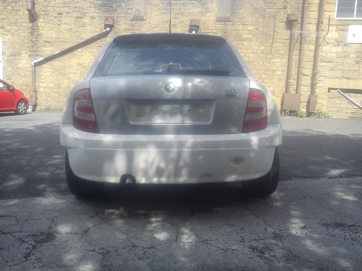

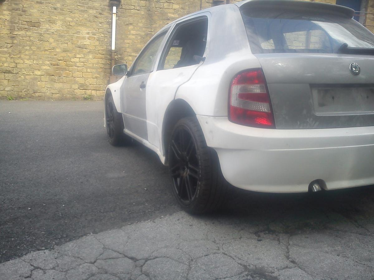

Looks good but if im honest i would get a wider wheel and a very low offset on the rear as its just not enough in my eyes.
Rear new more bigger spacer lol front cooo though
I already have a plan for the rear to space it out abit more

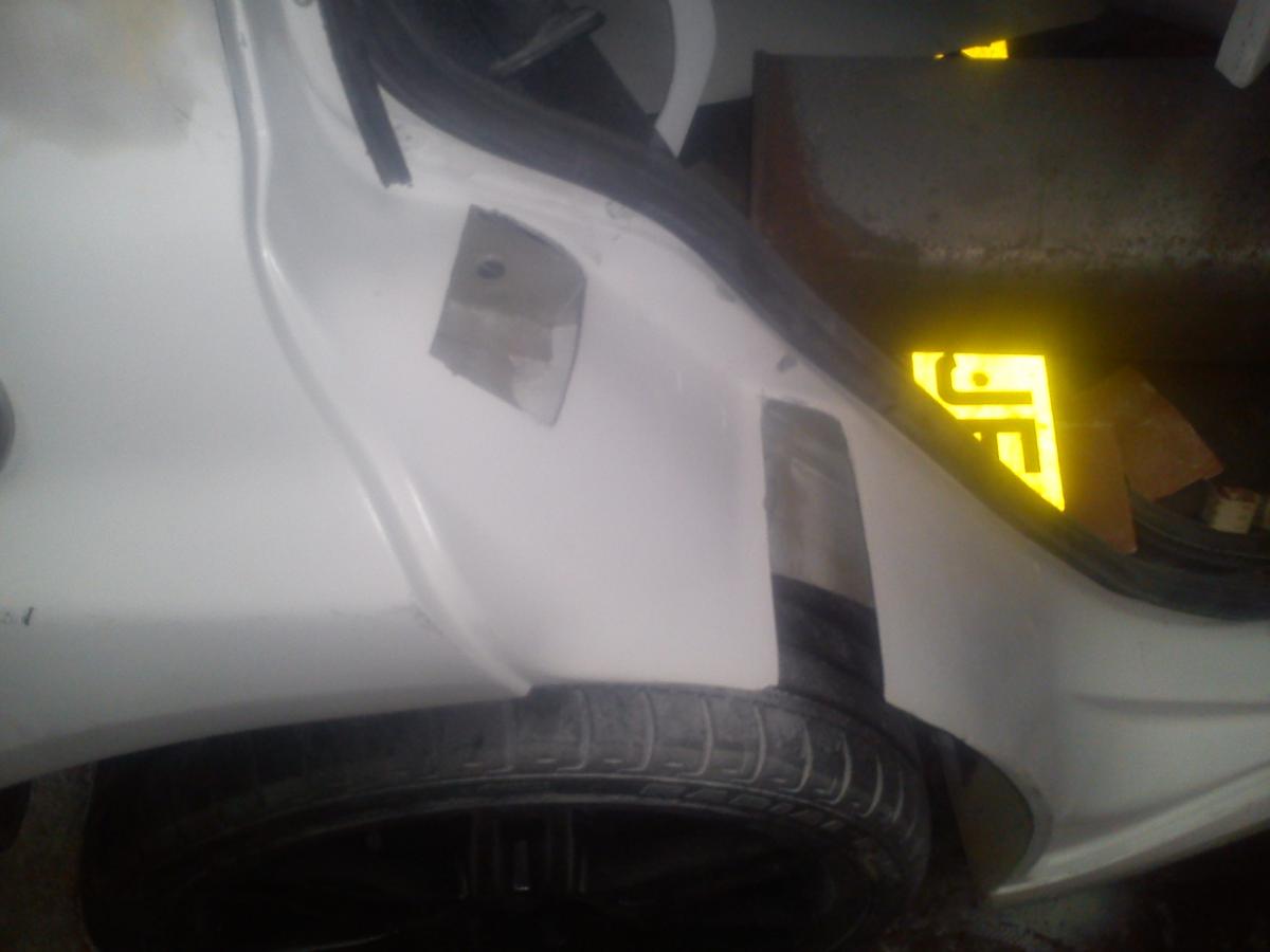

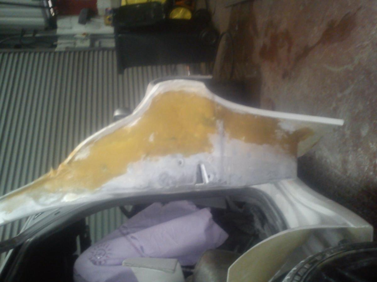

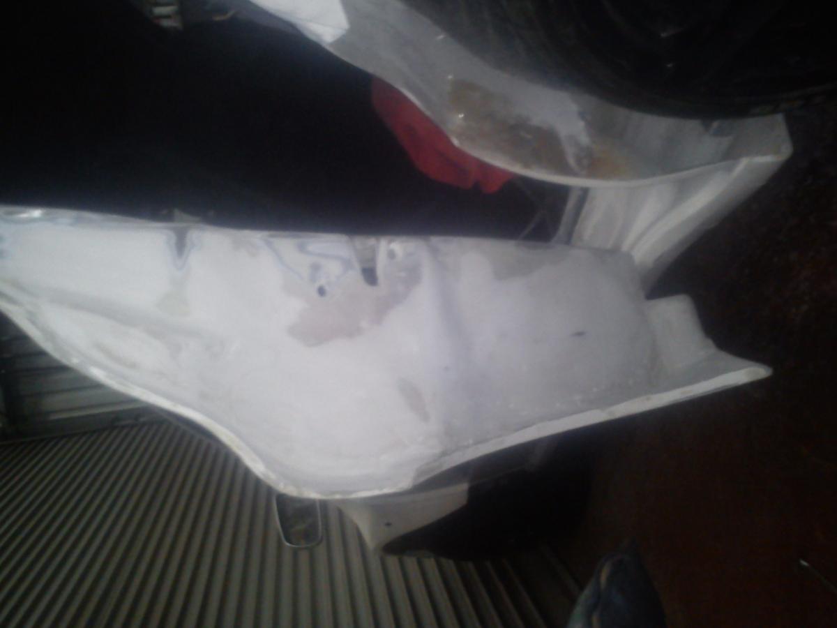

Had abit of a family trouble over the last few weeks so not got that much done but heres some pics of the things I have been working on
