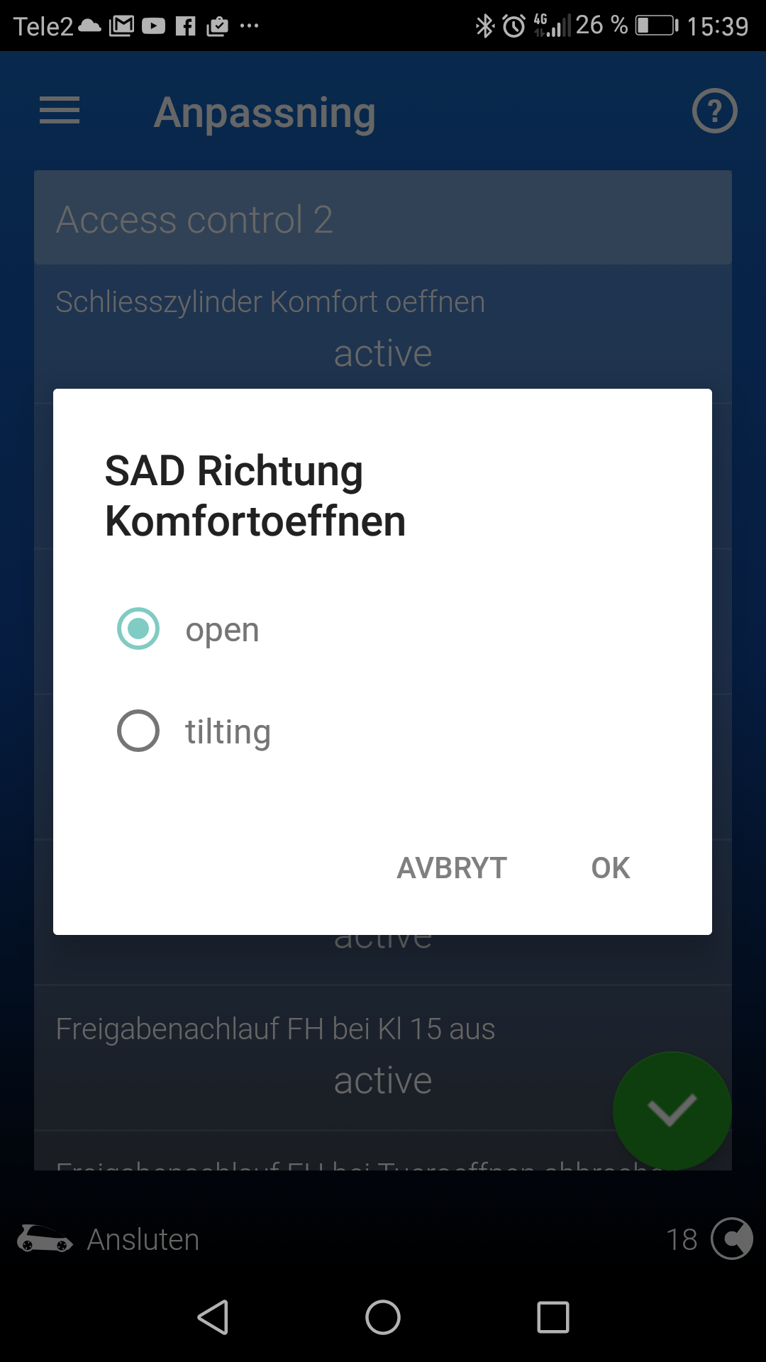

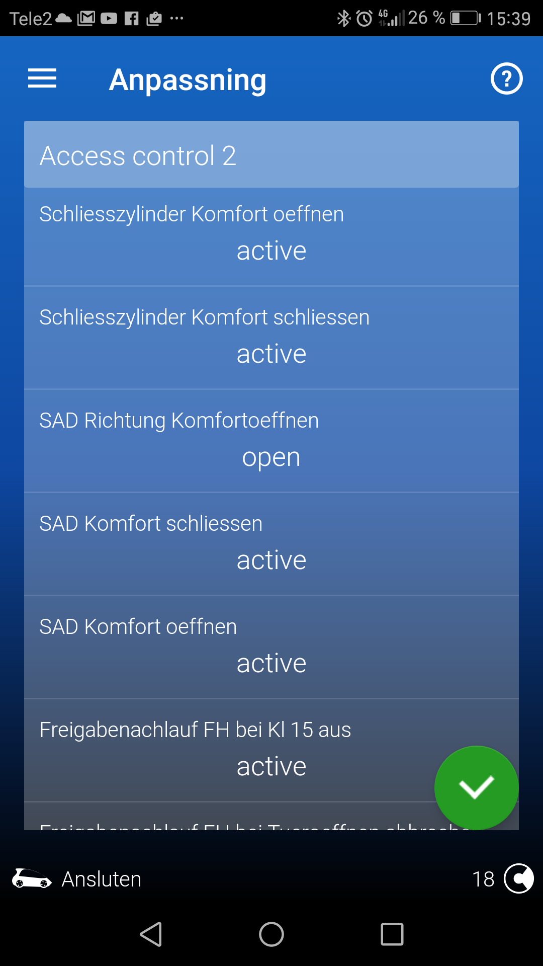

Hello! Yes, #1 is working now (fully opening the panoramic sunroof when long-pressing the keyfob).
This is how I did it:
Select Control unit 09 (Central Electrics)
Security access > Access Code : 31347
Adaptation
(9)-Access control 2-SAD Richtung Komfortoeffnen
Select:Open

  • Select Control unit 09 (Central Electrics)
  • Security access
  • Access code 31347
  • Adaptation
  • (14) Zugriffskontrolle 2-Regenschliessen auswählen
  • Value: Permanent
  • (26) Zugriffskontrolle 2-Menuesteuerung Regenschliessen auswählen
  • Value:Aktif
  • Control unit Long Coding
  • Subsystem: Rain / Light Sensor (RLS)
  • Byte 0
  • Bit 1-Bit 2 DeActivate
I get as far as to the bold points above. If I select Long Coding, I can either choose the Rain/Light sensor sub objet OR get the bits and bytes. I't doesnt behave as in the instructions.
BR/Riolux
