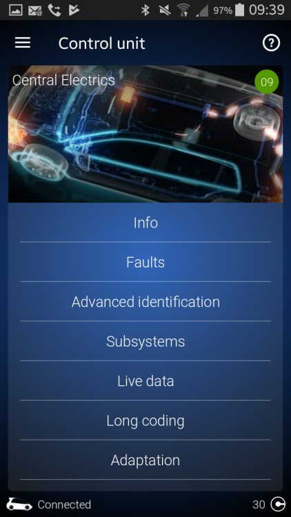

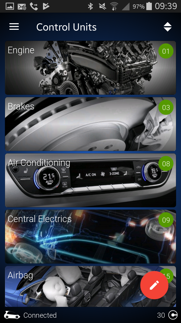

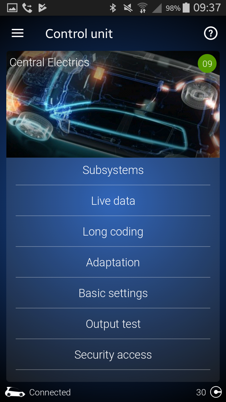

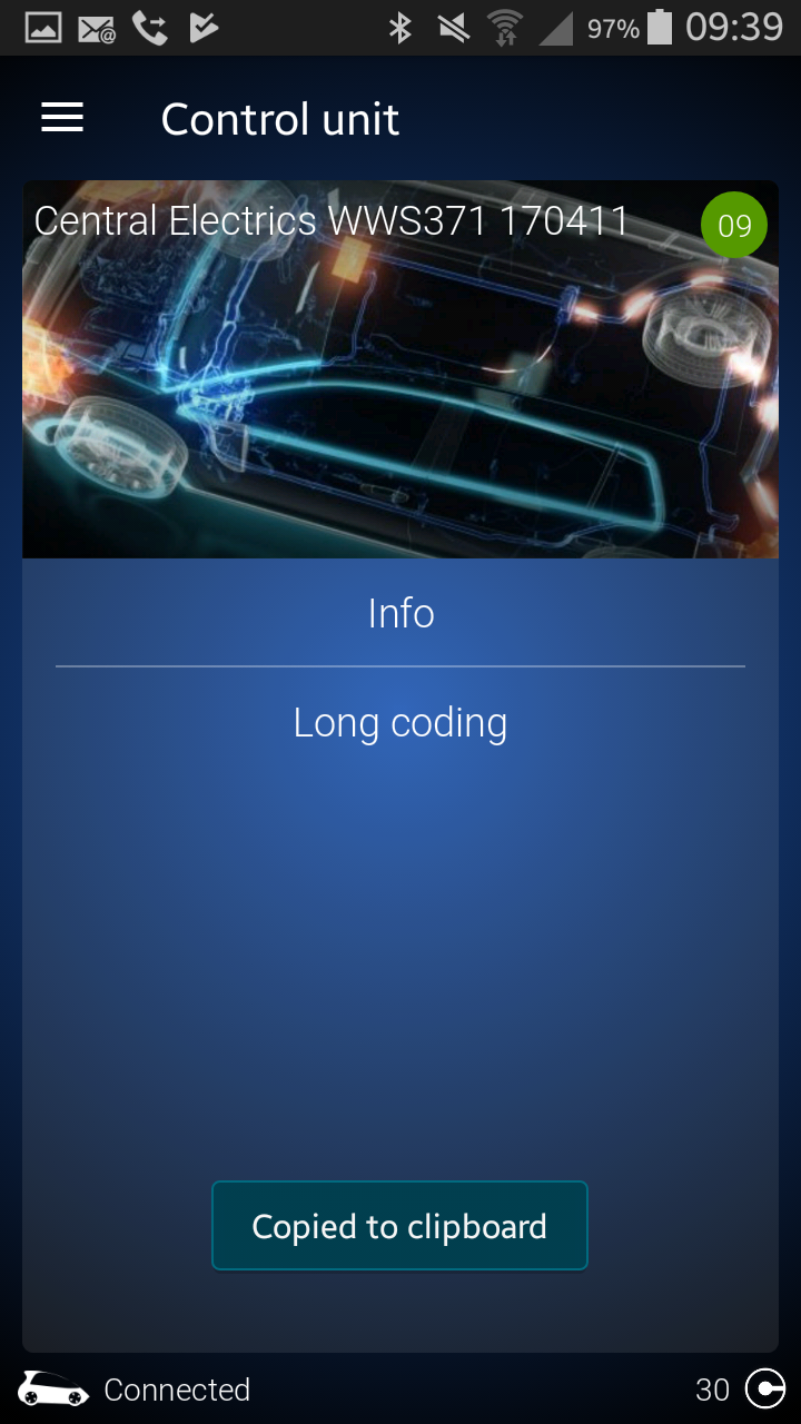

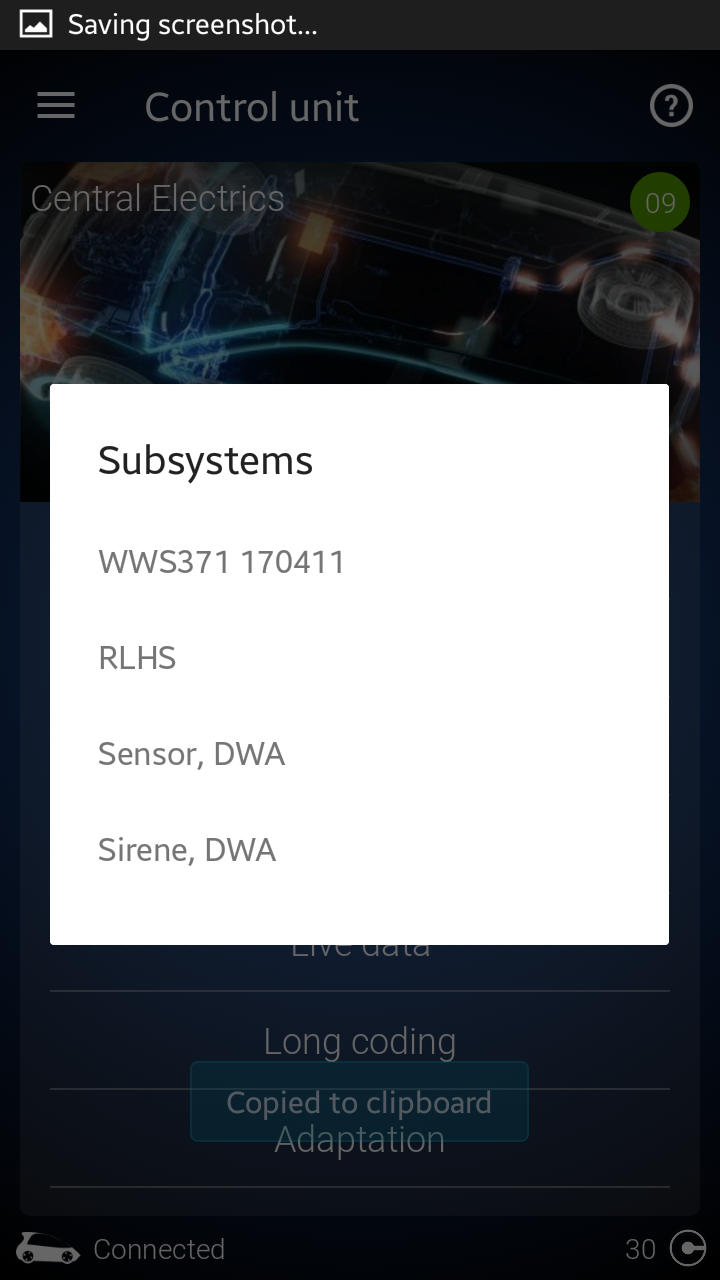

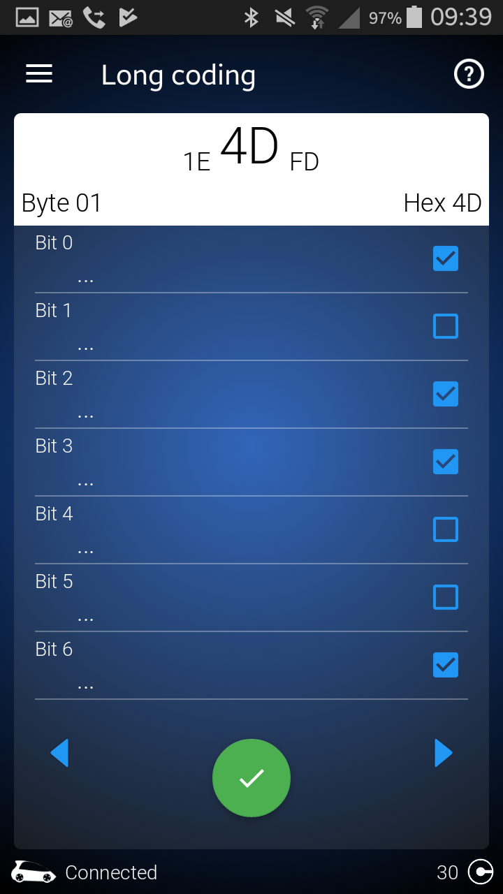

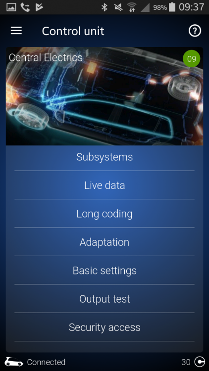

Hi. Sorry this took ages for me to reply. Here is the steps you need to take. (Hopefully the images upload in the correct order haha).
1.  Click on 09 Central Electrics
2.  Click Subsystems
3.  Click WWS371...
4.  Click Long Coding
5.  Scroll along to Byte 1 and untick Bit 4.
6.  Click green tick to confirm.
That should be you.

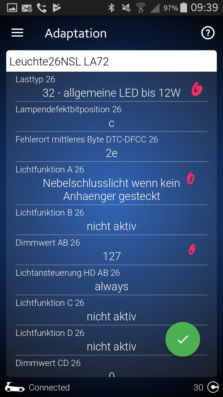

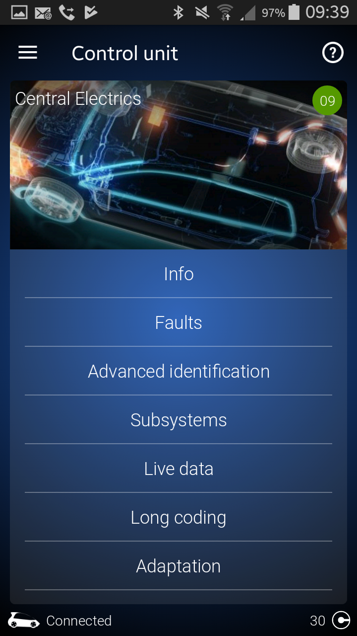

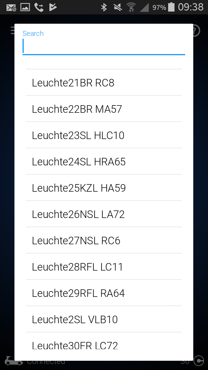

Hey. As above, apologies for the delay. Here are the steps required.
1.  Click Central Electrics
2.  Click adaptations.
3.  Scroll to Leuchte26NSL LA72
4.  Change values marked in red
5. Green tick to confirm
Run through my instructions alongside the VCDS sticky just to be sure I've not made an error. But that should be you.
