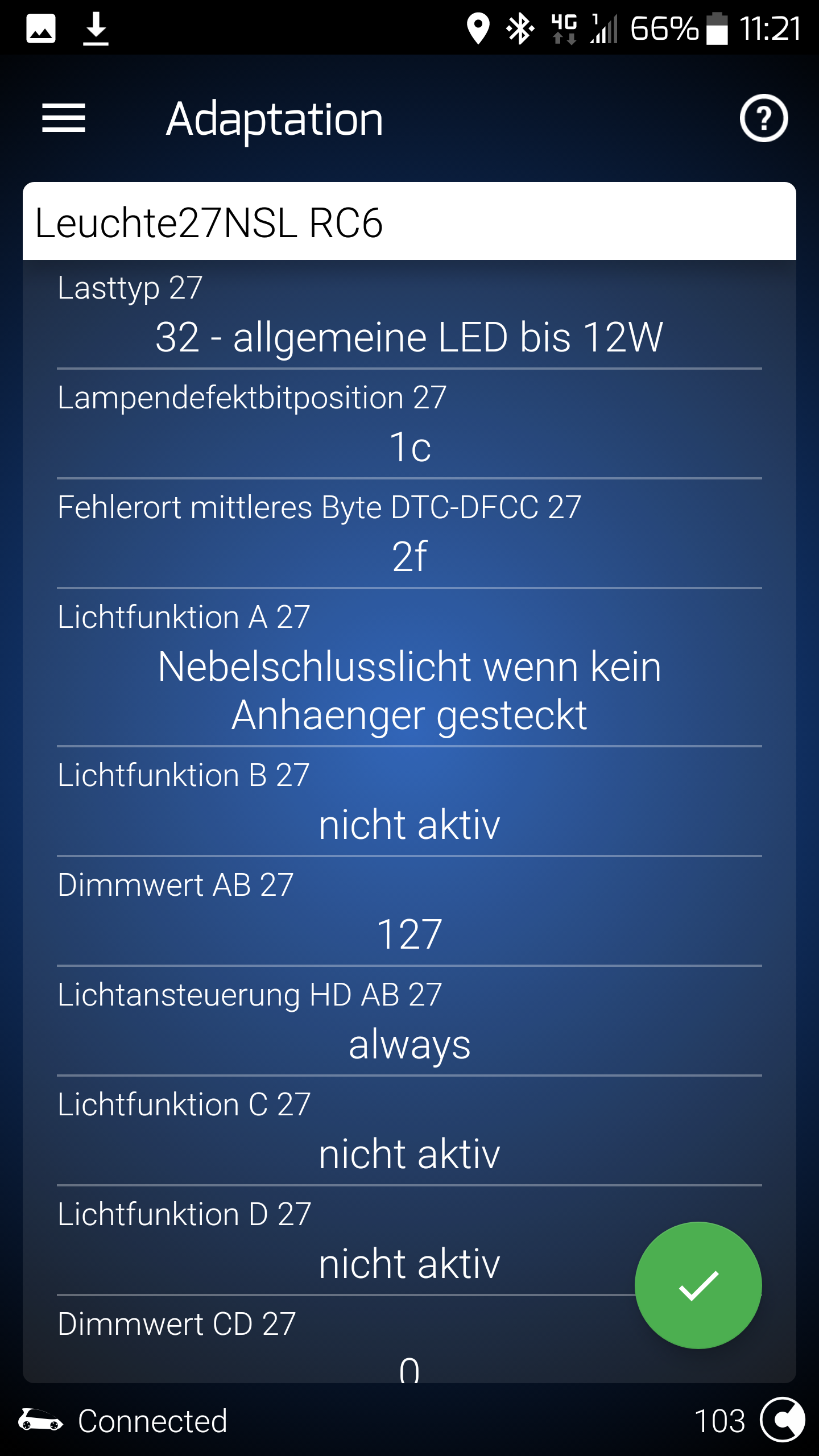

My vrs is LHD (MY18) so I did this:
But the right rear fog didn't light up
And I got this error :
I guess maybe there is no led bulb in the rear right side.

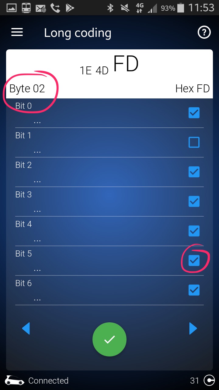

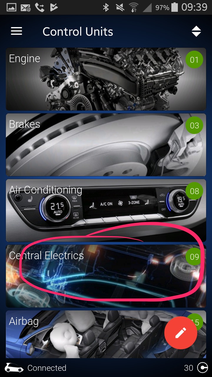

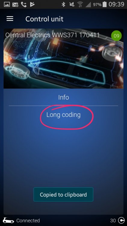

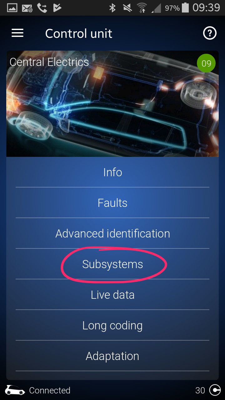

10 hours ago, SC03OTT said:

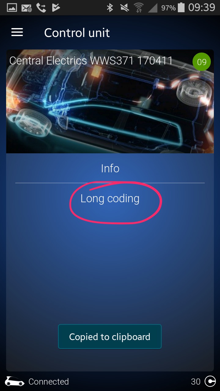

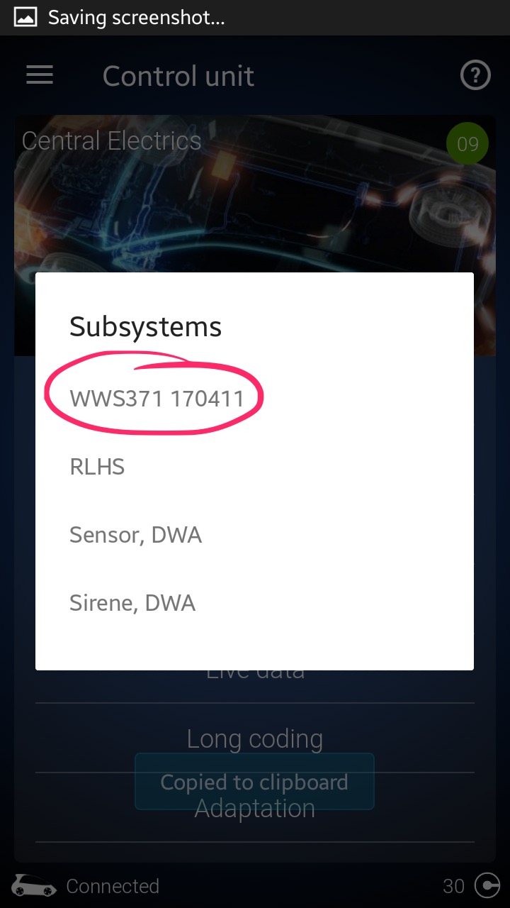

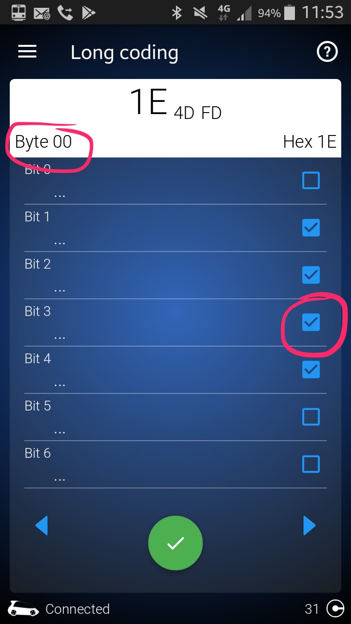

Hi. Sorry this took ages for me to reply. Here is the steps you need to take. (Hopefully the images upload in the correct order haha).
1.  Click on 09 Central Electrics
2.  Click Subsystems
3.  Click WWS371...
4.  Click Long Coding
5.  Scroll along to Byte 1 and untick Bit 4.
6.  Click green tick to confirm.
That should be you.

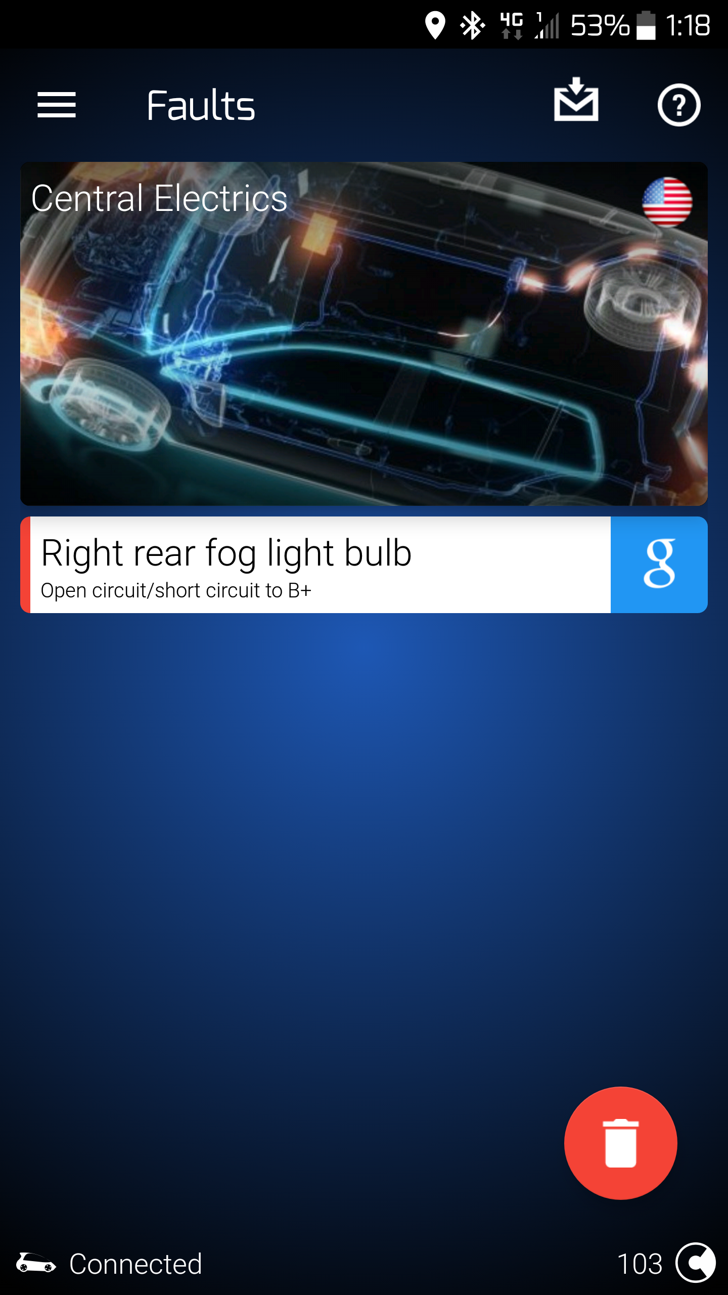

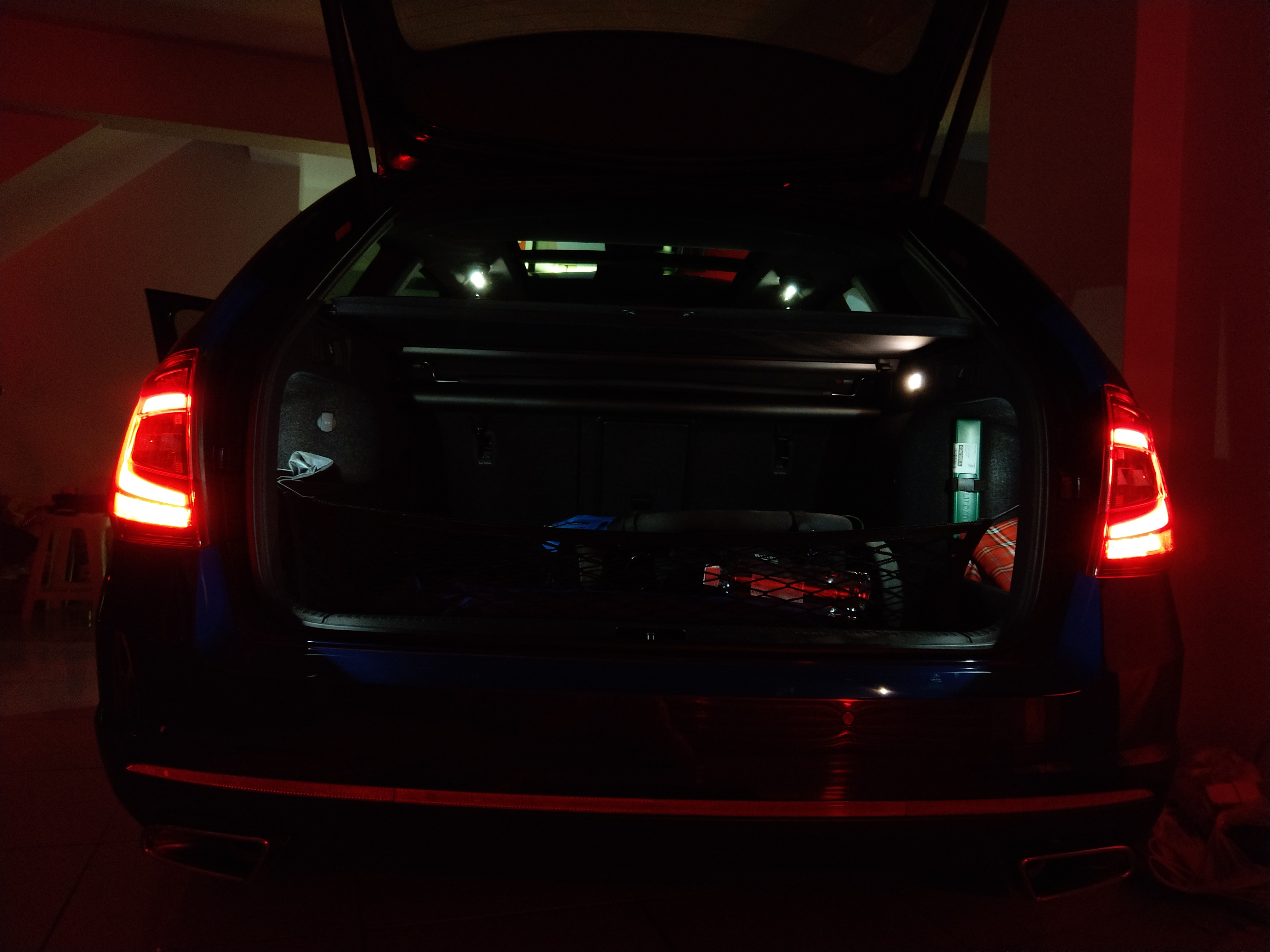

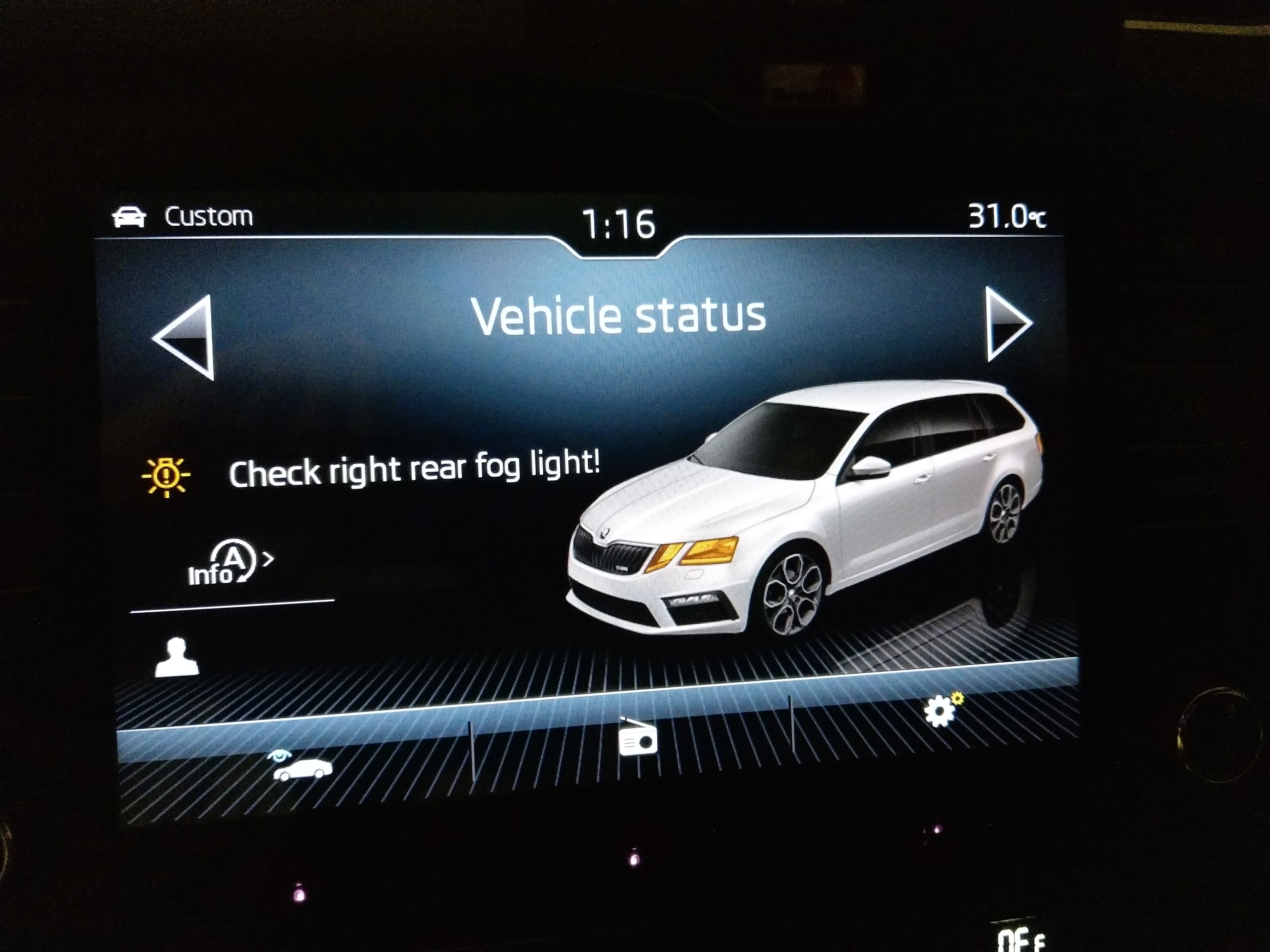

15 hours ago, ebwmcs said:
Thanks sc03ott
Did you compare the L/R clusters? I am sure the small LEDs are visible if you take a closer look.

On 2017. 08. 24. at 20:23, ebwmcs said:
Thanks sc03ott
Just checked the rear clusters on my colleague's FL (also LHD). The small LEDs are visible on the left side but they are missing on the right side. The 'funny' thing is that the circuit board for the LEDs is also exist in the right cluster, I saw the solder pads for the LEDs). Bad news. :S
How bizarre.  Can't understand the logic behind that. I just assumed the light clusters were all ready to go with coding to decide what works. Certainly how it is in the U.K. as mine are both now operational. I'll probably never use them right enough haha.
I ordered a uk spec rear right cluster (part no. 5E9 945 712 A, 5E9 945 208A)to try to complete this project:cool:.
Edited by ebwmcs
You get bonus points for commitment :)

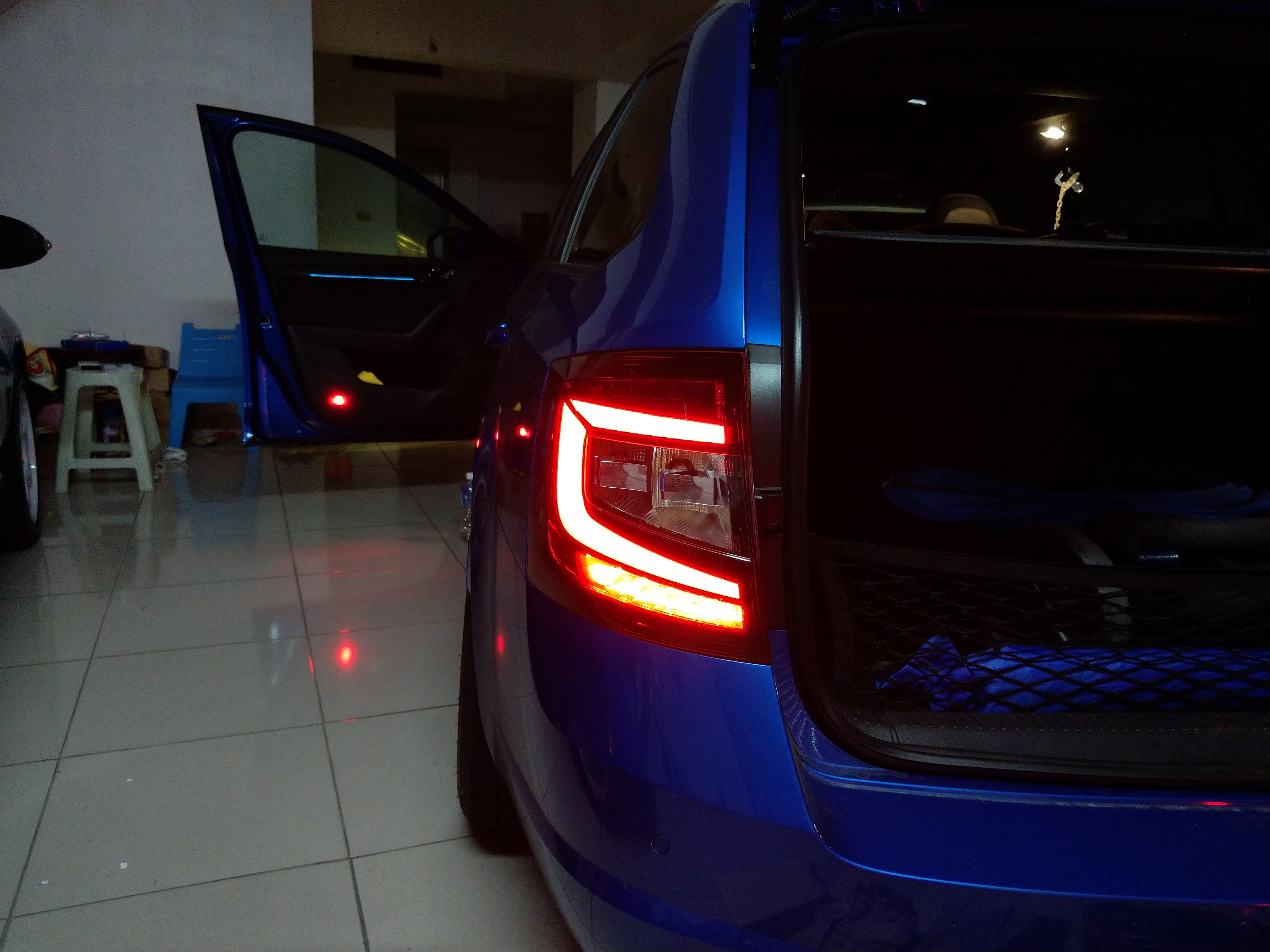

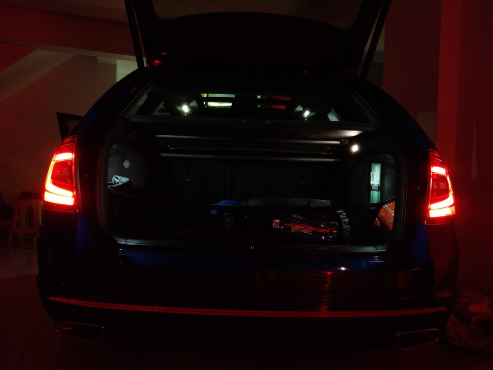

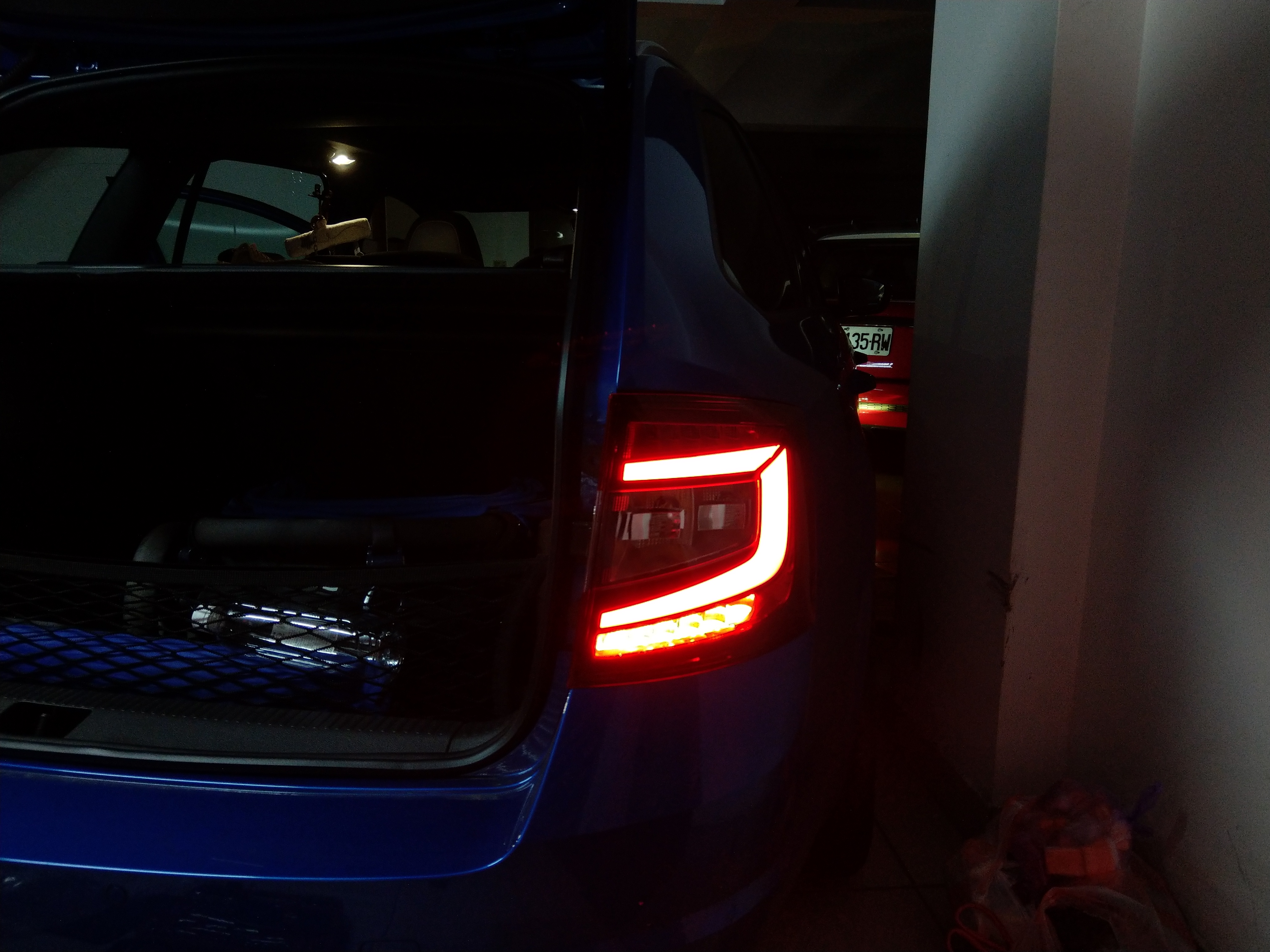

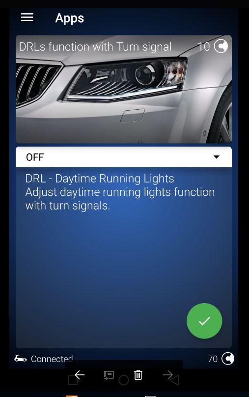

Ok,both lights up.IMAG0301.thumb.jpg.3ca31e0fba5e5c0a150b6f09dc0448f5.jpgIMAG0297.thumb.jpg.e95e79419bd075a0c7aab4b358225a36.jpg
DRLs function with turn signal...can anyone tell me what does this function mean?
Is Audi throttle response possible in Octavia?
It will dim (reduce the intensity) the DRL strip light when the indicators are on.
