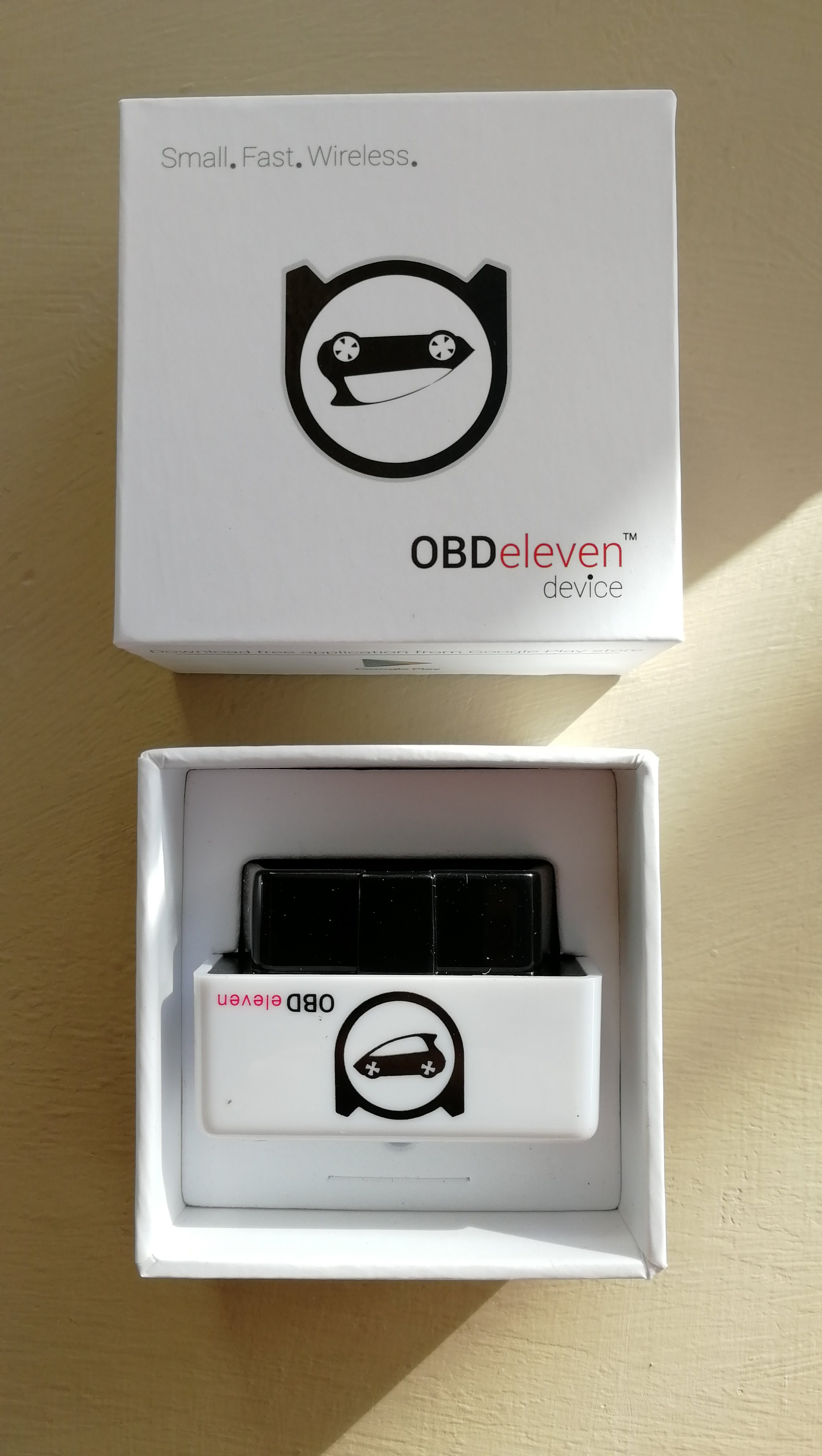

Arrived this morning.
How long did it take for you? I've ordered one from their official site yesterday.
Took 2 weeks from ordering to arrival from the official site.
