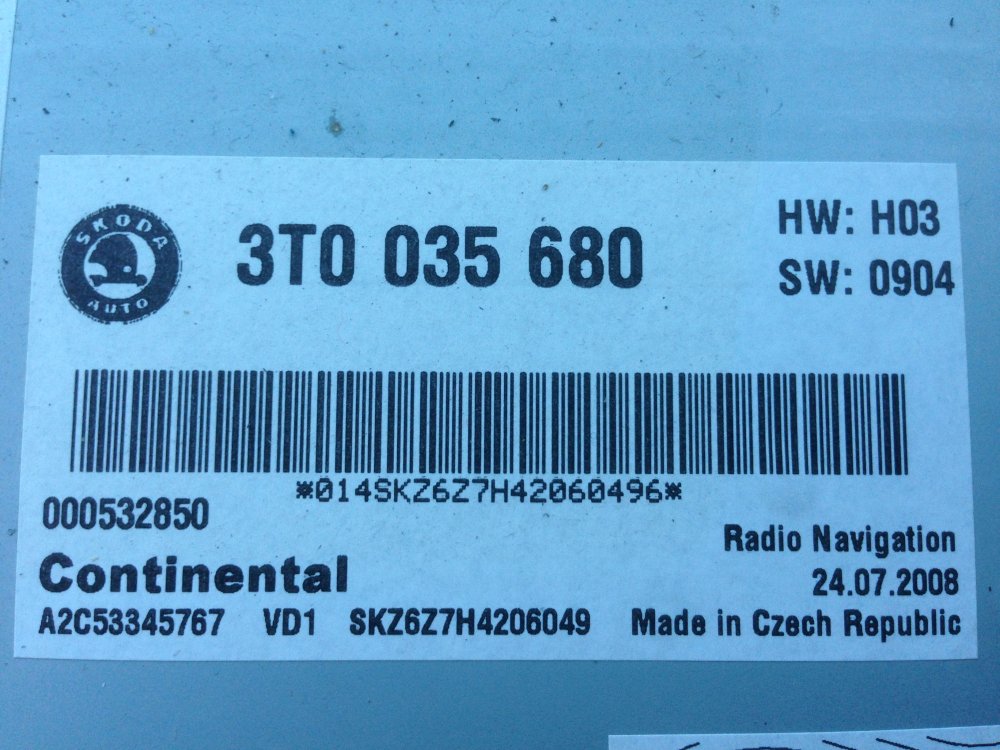

It's not uncommon. Can you take a pic of the data label on top of the unit for me please? Then I'll be able to tell a bit more.
OK. I'll do that but not sure how to go about getting it out. Might take me a while but I will get back to you.
I appreciate your help.
Pop the trim off which surrounds the unit then there are 4 torx t20 screws holding it in. No need to disconnect anything, and certainly don't disconnect the wire to the airbag light on the trim, otherwise airbag fault light will happen.
Morning Rustynuts,
Pics of the data label you requested..
Aye, that's what I thought.
It's one of the earlier LCD screen units, and not something I spend a lot of time repairing usually. There's no spare parts available anymore, I'm afraid.
However, the particular fault you have is probably a software fault so I'll message you with some possible fixes. I just sent you a message anyway, but you appear to have sorted the pictures issues, so disregard that.
