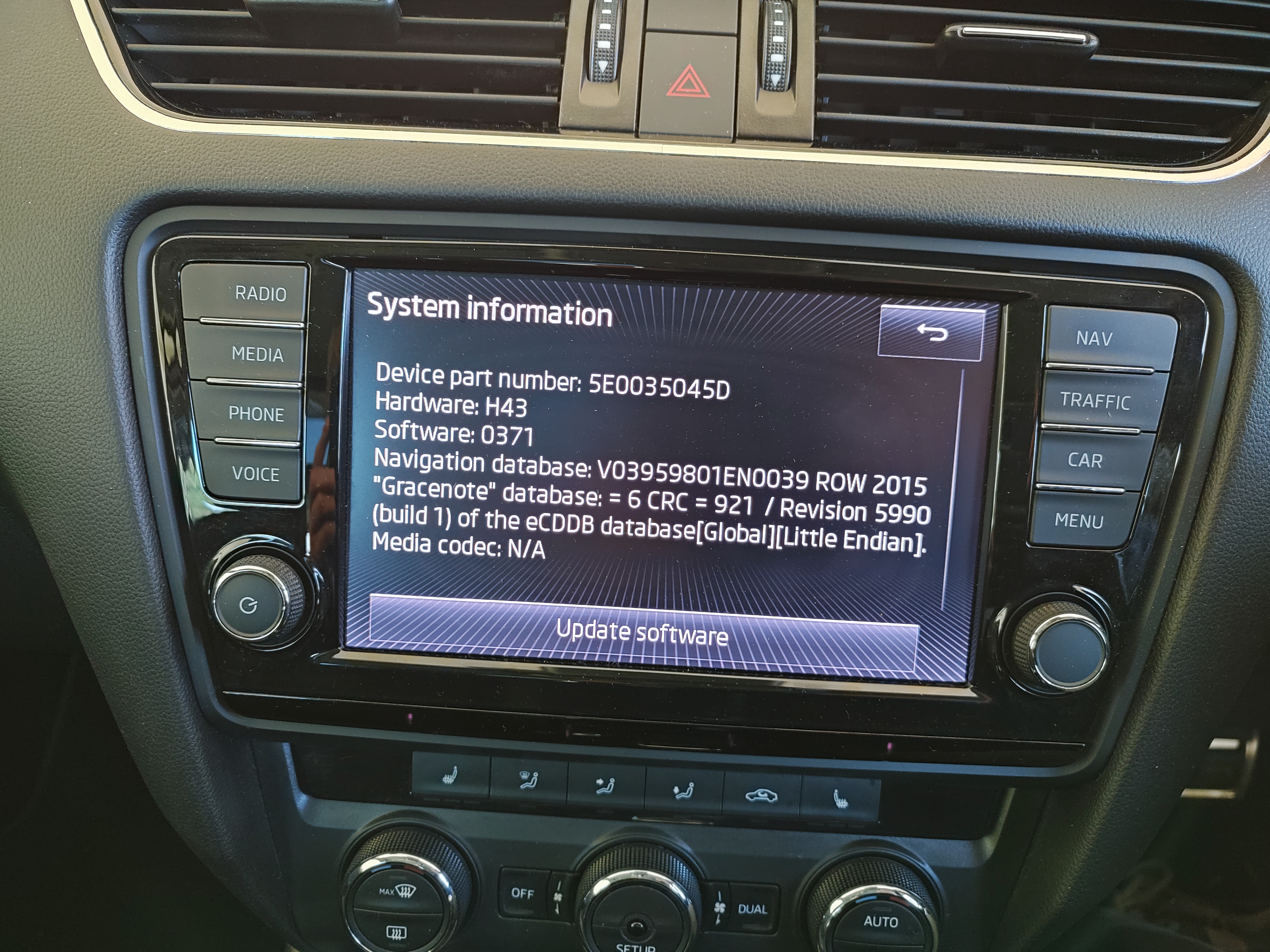

Hi guys,
I'm new to the forum and new to Skoda and I notice you all seem to be very knowledgable.
We recently aquired a MY15 Octavia Scout Premium.  Love the car but I'm very frustrated with a couple of things.
Firstly the Navigation maps are very out of date and I don't seem to be able to find an update that works for Australia.  Skoda Australia don't seem to have a solution although there are ROW maps available on the Skoda Portal.  When I try to install these my unit simply responds with "Error: no data available ....".
I'm using a 64gb exFAT SD card, files extracted with Windows 10, files are in the root directory.  I've made many update attempts but no success and I've considering getting an Android head unit from AliExpress but I assume it would need to be coded into the car.  Coding it into the car would be additional complication so I don't know what to do.
Pretty sure it's Columbus MIB2.

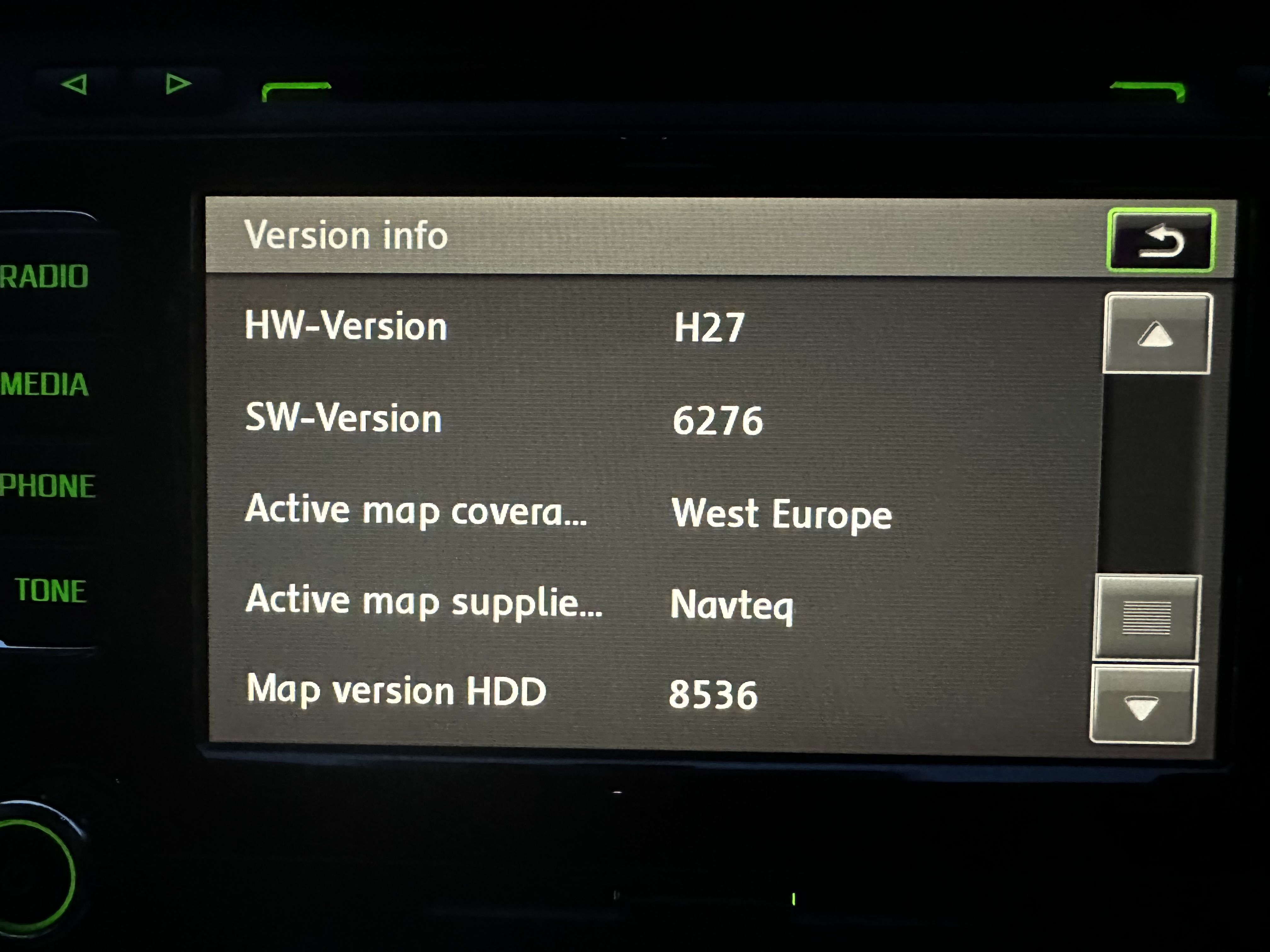

My Columbus has just started having issues booting up when first starting the car. It's random and can take anywhere between 2 and 10 reboots/loops before it finally starts up so I'm thinking that there has been some corruption of the firmware on the SSD?
As per the images below my HU is running firmware version 6276. @varooom  @pab567  Do either of you guys have this firmware available for me to burn to disc at my end?
Also are there instructions when just replacing the existing firmware with the same version rather than updating it to a newer version? I'm also assuming re-installation of this firmware won't result in the loss of my maps?
