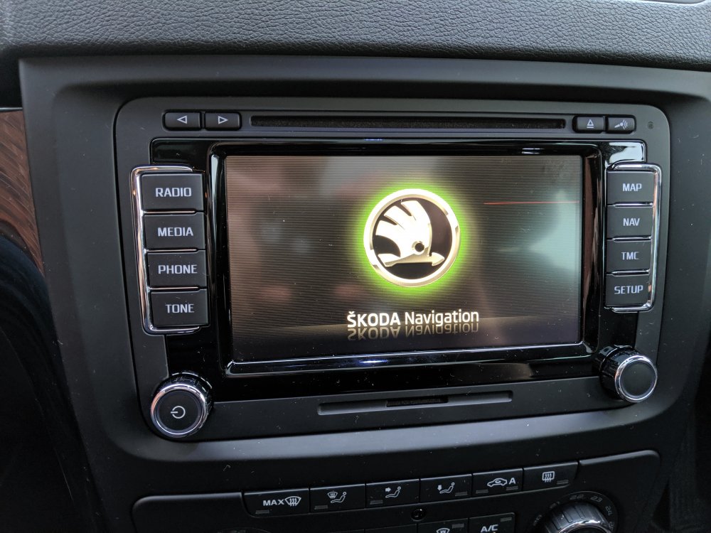

I just had the car in for service and asked for the latest map update which they said they'd check on.  My service bill says no change required as the maps are up to date.  I'm slightly skeptical.  I have a 2014 TDI Combi which is technically MY 2015 but built/delivered in October 2014.  My Columbus has no DAB, but has Bluetooth/HFP.  Short of sliding things out mechanically is there an easy way to tell if this is the case?
You don't say specifically what car you have and what version of Columbus is installed. A pic of the unit would help.

Do you just need the unit photo or the screen turned on?
Edited by Rumbeard
Just the unit itself mate
Yeah. that's the right unit for this thread at least.

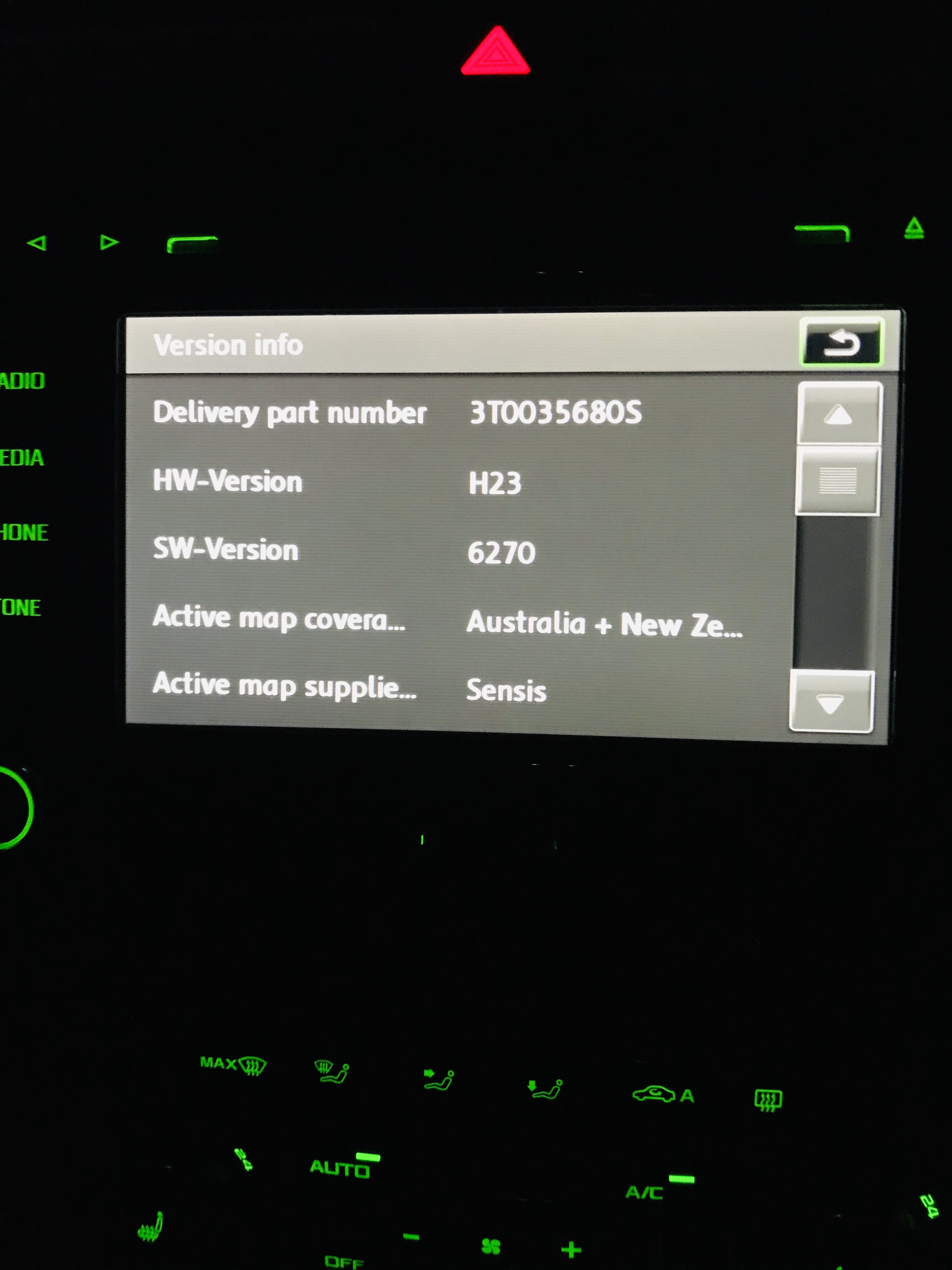

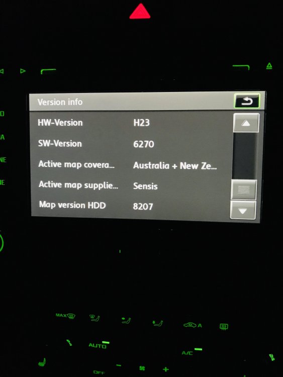

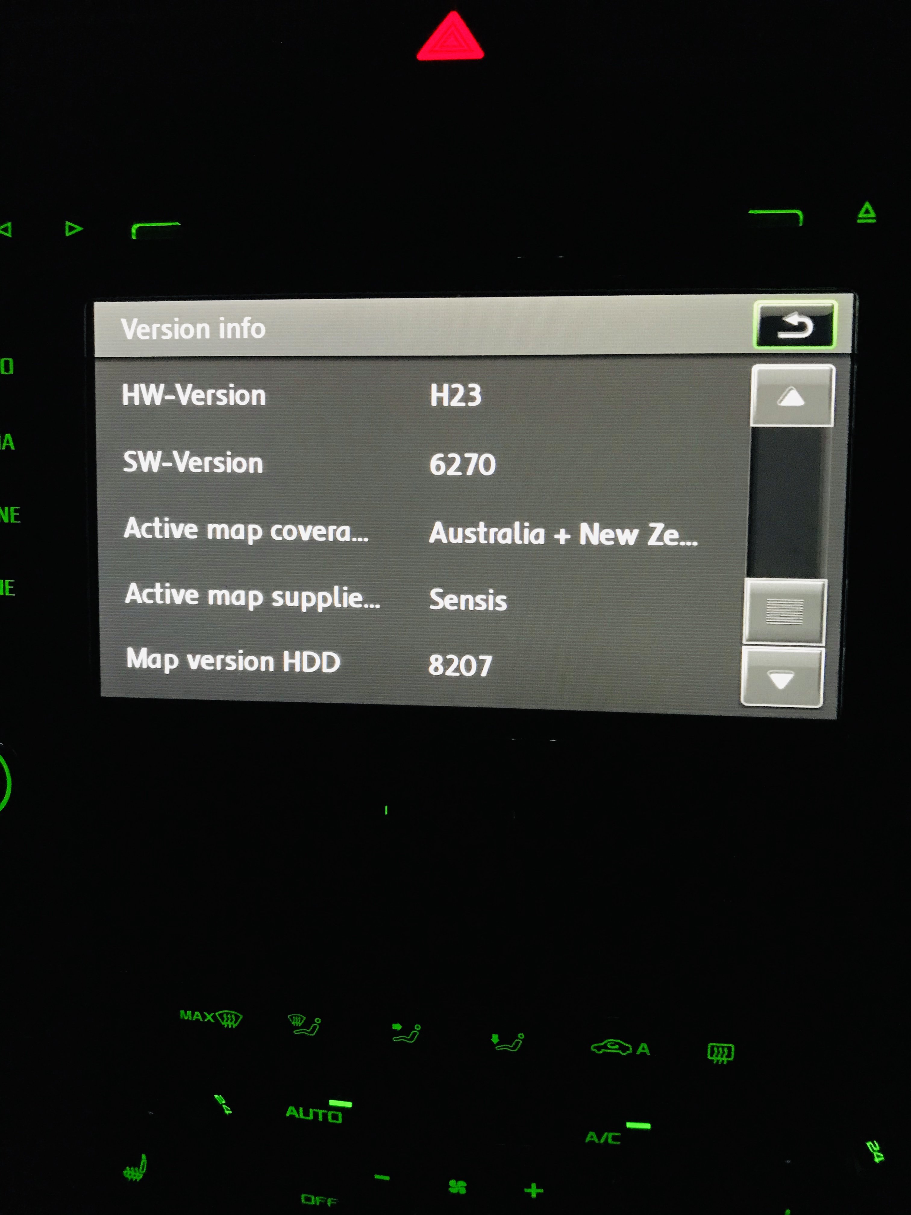

If you press and hold "Setup" until it cycles to the screen where it says "Version Information", touch this, and then scroll down to the bottom where it'll have the maps version listed, take a photo of this and pop it on here so at least I can see what you have. I'll try and find out what updates are available, but I'm not certain I can help much.

Yes. Attached
I think 8207 are known as V8 from around 2014/2015?
Some sites claim the latest Aus/NZ version is V13 although they are pretty expensive and I expect a dealer may be even more.
That would mean the original owner never updated it.
V9 was the last official version of RNS510 maps for Australia, since then VW haven't released any updates.  The updates available to buy online (up to V13 apparently) are generated from BMW maps and converted to run on the RNS510, there's a requirement to downgrade from V9 to V8 prior to installing the later hacked versions too. The same BMW hack was used for Eastern Europe maps for the past few years until VW released a genuine version this year.
