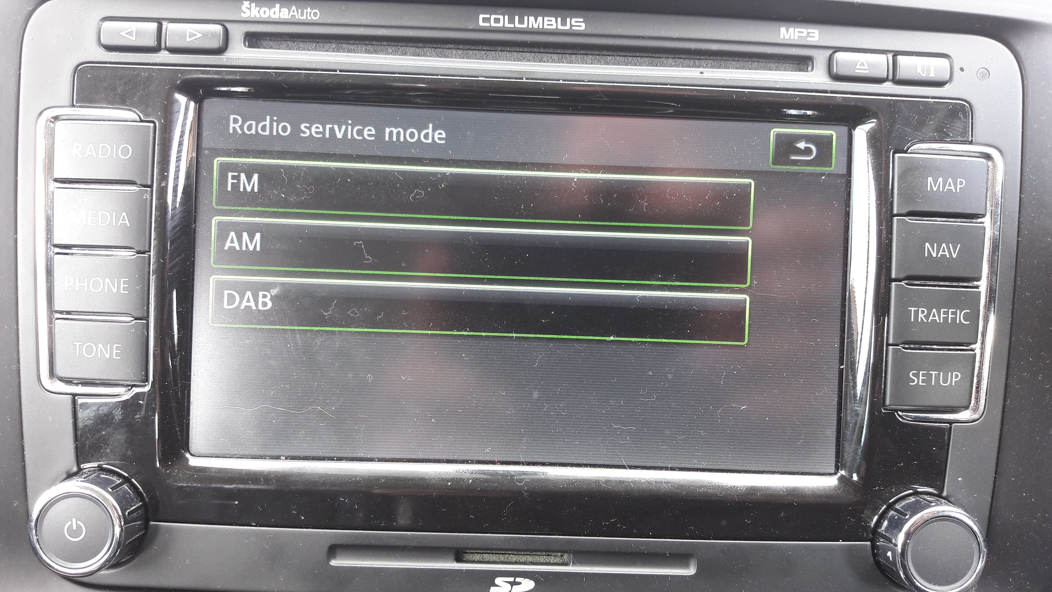

Hi Rusty nuts.
On my columbus I have this screen after holding settings button for a while....
Does this mean the unit is Dab enabled?
It would appear so.

Ah, cancel that. I'm back home now looking on the computer instead of the mobile. The top right button is a speaker / i button. If you had a DAB unit you'd have a small microphone, so you've got an old unit which someone has updated the firmware to include the DAB software, but you have no DAB hardware.
So I will need to buy a whole kit no worries.
