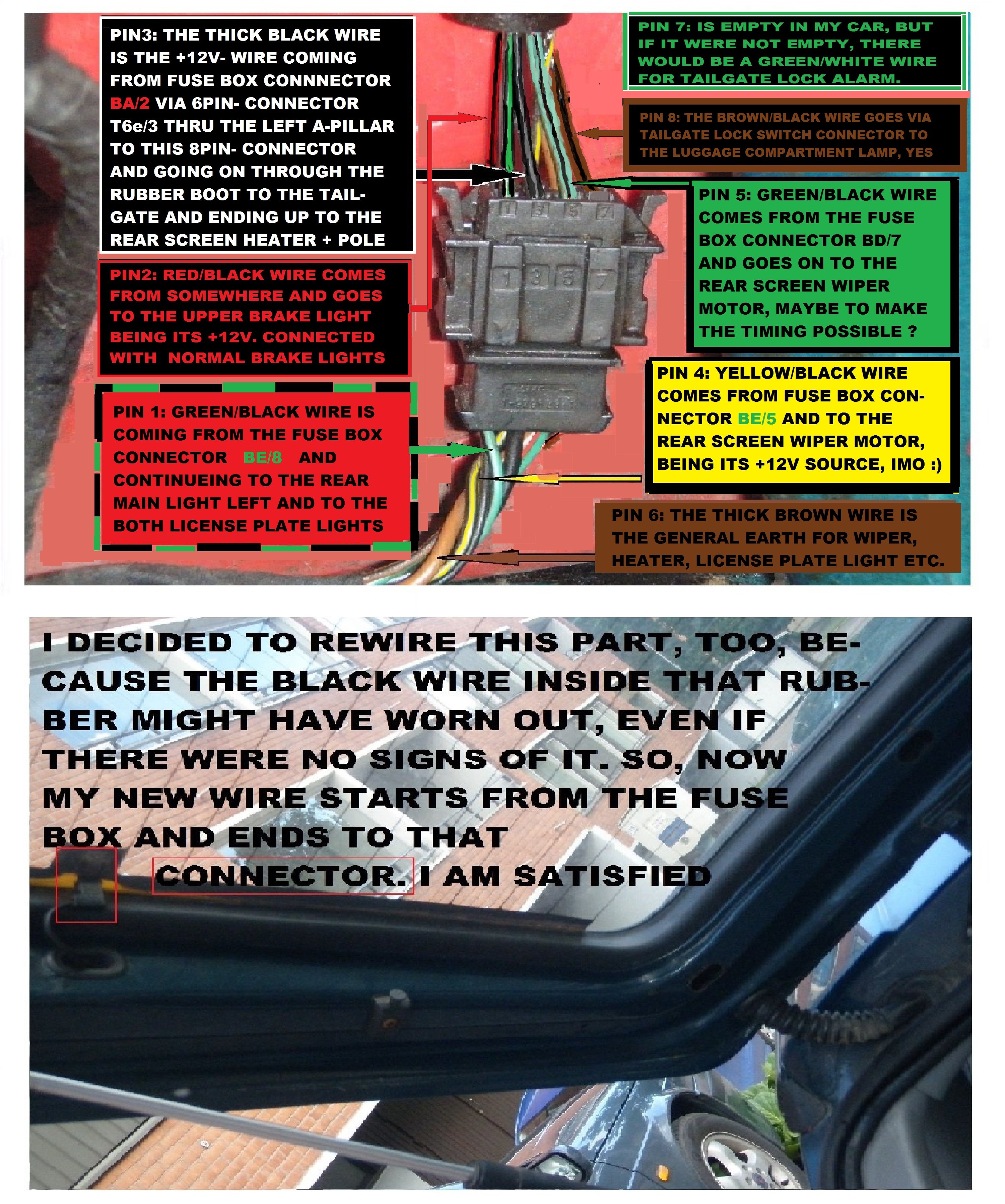

This illustration I've drawn should clarify things even more.

The biggest difference with my LX-Felicia wires is the lack of alarming system, which leaves the pins 2 and 7 empty in my 8-pin connector. Neither do I have even CL in my tailgate. It is good to know that I can get inside my car even if the CL-system stops working in -35C degrees :)
The pin1 in my car goes to license plate lights, pin2 is empty, pin3 gives +12V to rear screen heater, pin4 goes to the pin1 in wiper motor, pin5 goes to extra brake lamp, pin6 is a general ground wire, pin7 is empty and finally pin8 goes to pin3 in wiper motor connector.

Nope. A green/black wire goes from pin 5 of T8l to rear wiper connector (T3d pin 3) like in my illustration. See proof below from factory wiring diagrams for Skoda Felicia LX Mk 2.

Nope. A brown/black wire goes from pin 8 of T8l to tailgate lock switch connector (T3d pin 3) for luggage compartment lamp like in my illustration. See proof below from factory wiring diagrams for Skoda Felicia LX Mk 2.

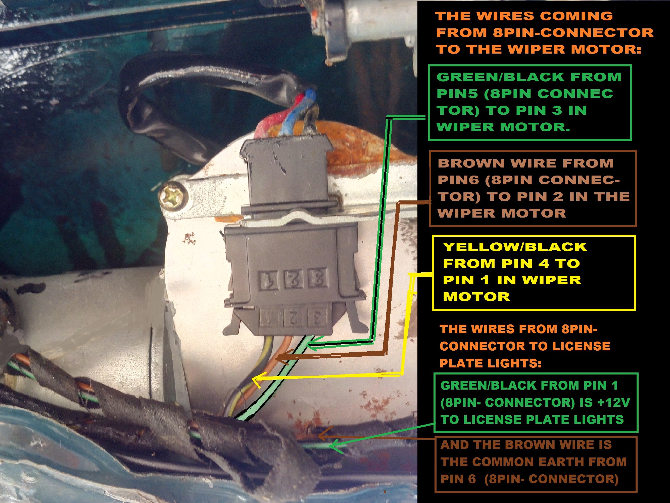

But it was about the time to give the tailgate a proper cover against rust, and the same time to  check all the wirings in the tailgate and leading to the tailgate. And I have to admit, that Ricardo was right about the colours and the meanings of the wires all the time. So, I corrected my own photos and shall send here also a new photo about the wiper motor connector. Hope, it might help somebody :)
