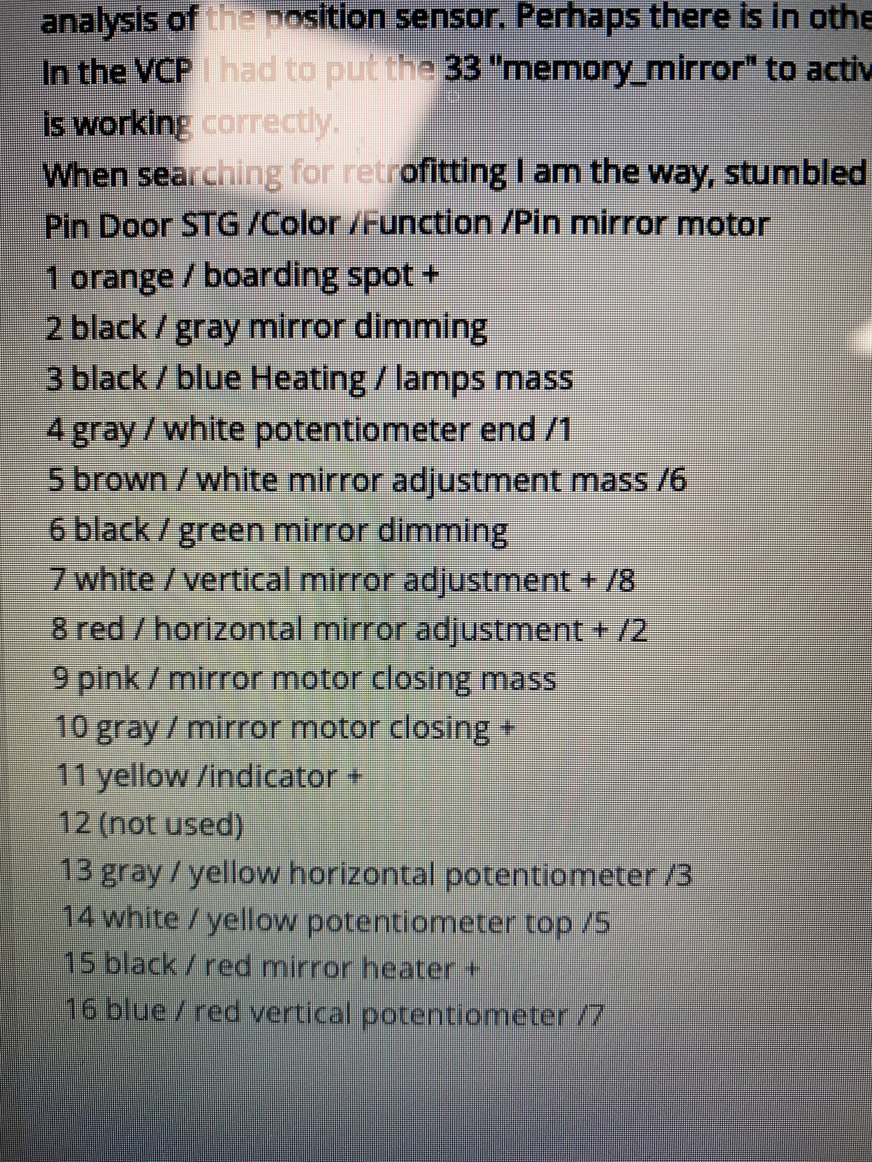

I was wondering if you have a copy of the wiring diagram you used for the new wiring for the mirror motor?
Picked up a motor, but now need to add the extra wiring to the door controller.
I didn’t have one per say, as I didn’t have to modify my wiring but this is what I have found
Perfect. Thank you.

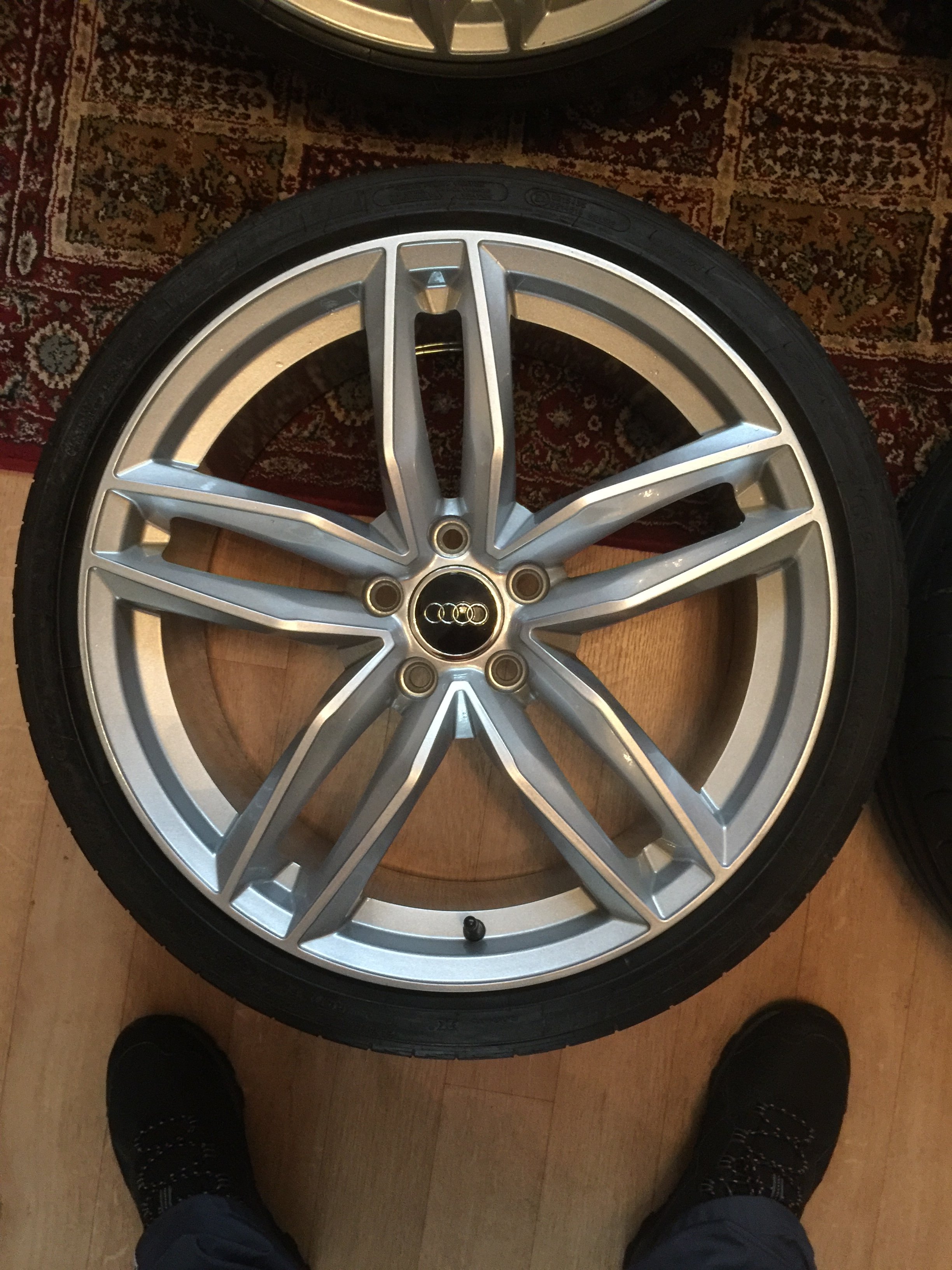

Copied you Sasha and just collected my gravel rash RS6 replica alloys silver powder coated. Thanks for the idea and they look great.
Edited by shyVRS245
Picture added
Look great! I need mine doing again, job was crap last time so 12 months in and the lacquer is peeling. Excuse to change them to something else locked and loaded 😂
