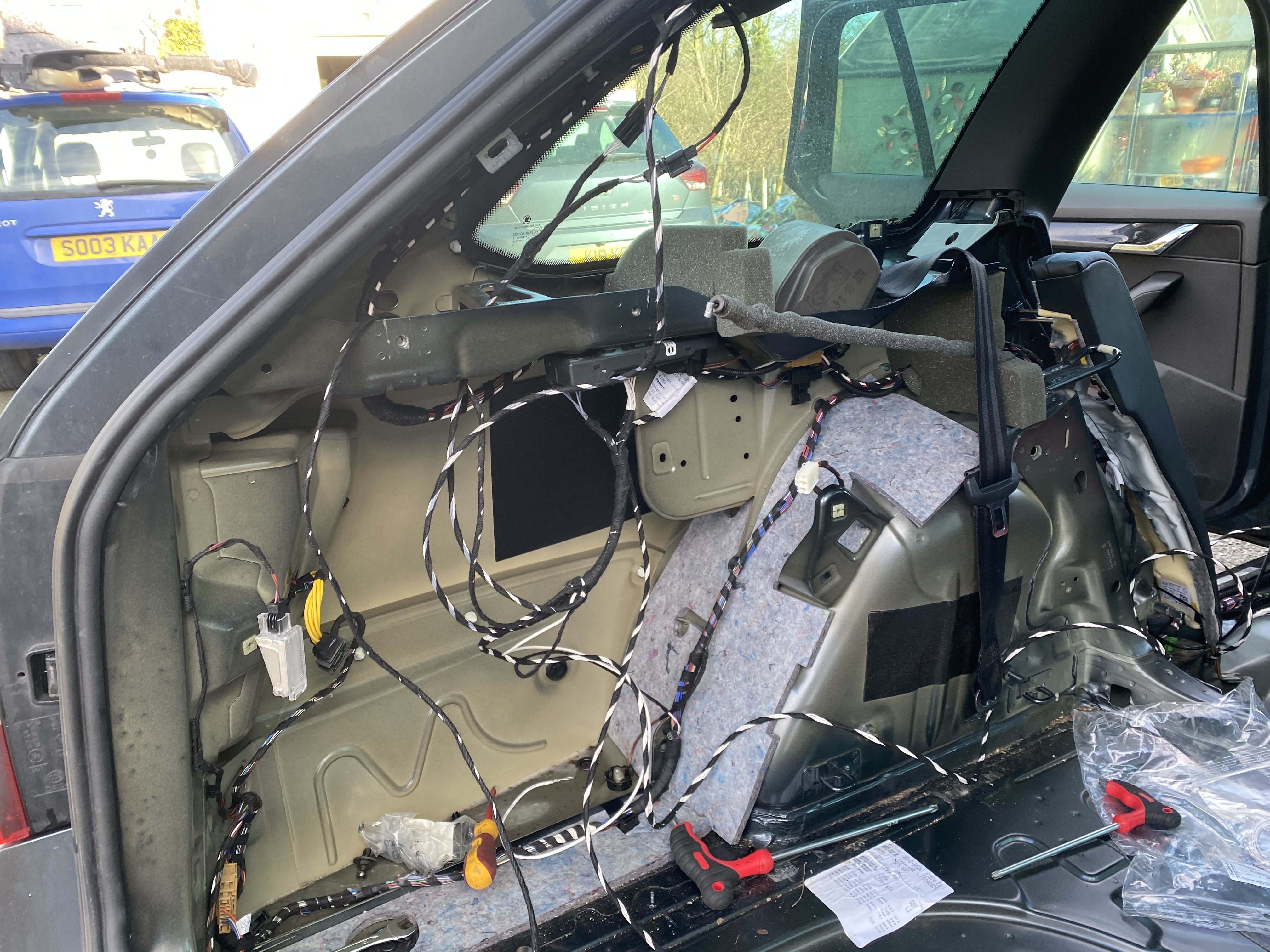

Getting somewhere but had to stop for today as I ran out of light, got to insert the pins into the fuse box and connect to CAN and then boot button wiring in the front when that arrives and we should be done :)
Crikey glad I just have to press a button rather than install the wiring loom.
It’s not as bad as it looks, just time consuming routing the cables.
Wow, that’s a lot of wires.

The control module needs to connect to the BCM, fusebox, CAN hi/lo, boot buzzer, boot button, boot lock, soft close boot latch, 2x strut connections on each side, drivers door and button in the centre console. So yeah, there is quite a bit 🤣
HA!! rather you than me. You must have the patience of a saint to start taking all those panels and whatnot off. I'd be employing a crow bar and hammer to yank them off and it would frustrate me to have to take time and be so delicate.

I’ve done it all before on this car so nothing new for this which helped massively getting to this point so quickly and the loom is very intelligently designed; it is built to be fitted much more quickly and with less intrusion than the factory loom. This threw me for a while as I was expecting to route the cables as a factory installation and the instructions which are good, but are translated quite literally from German and leave a little to be desired caught me off guard until I had it all laid out in the car. It’s not how I thought it would be, but it’s getting there.

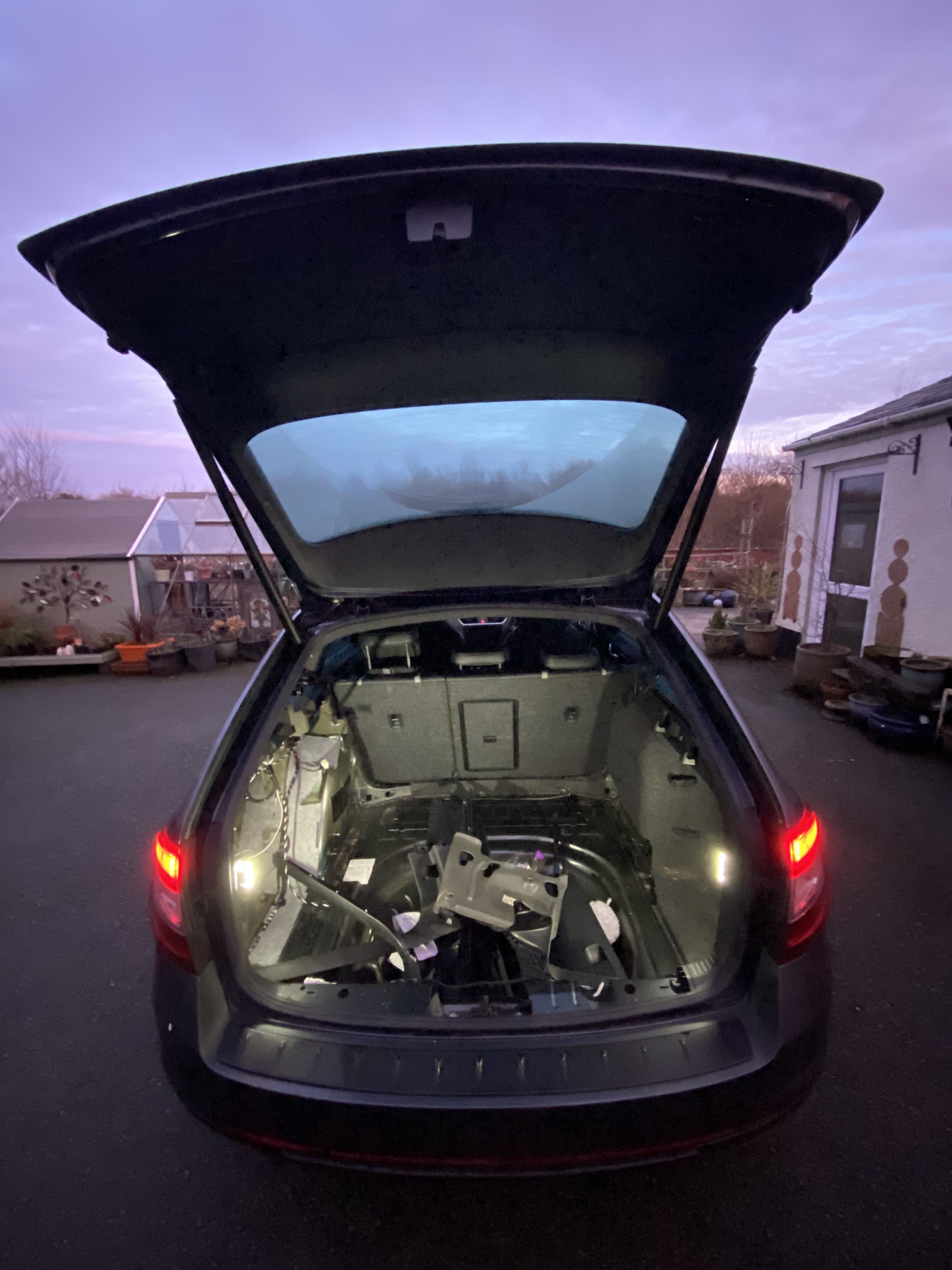

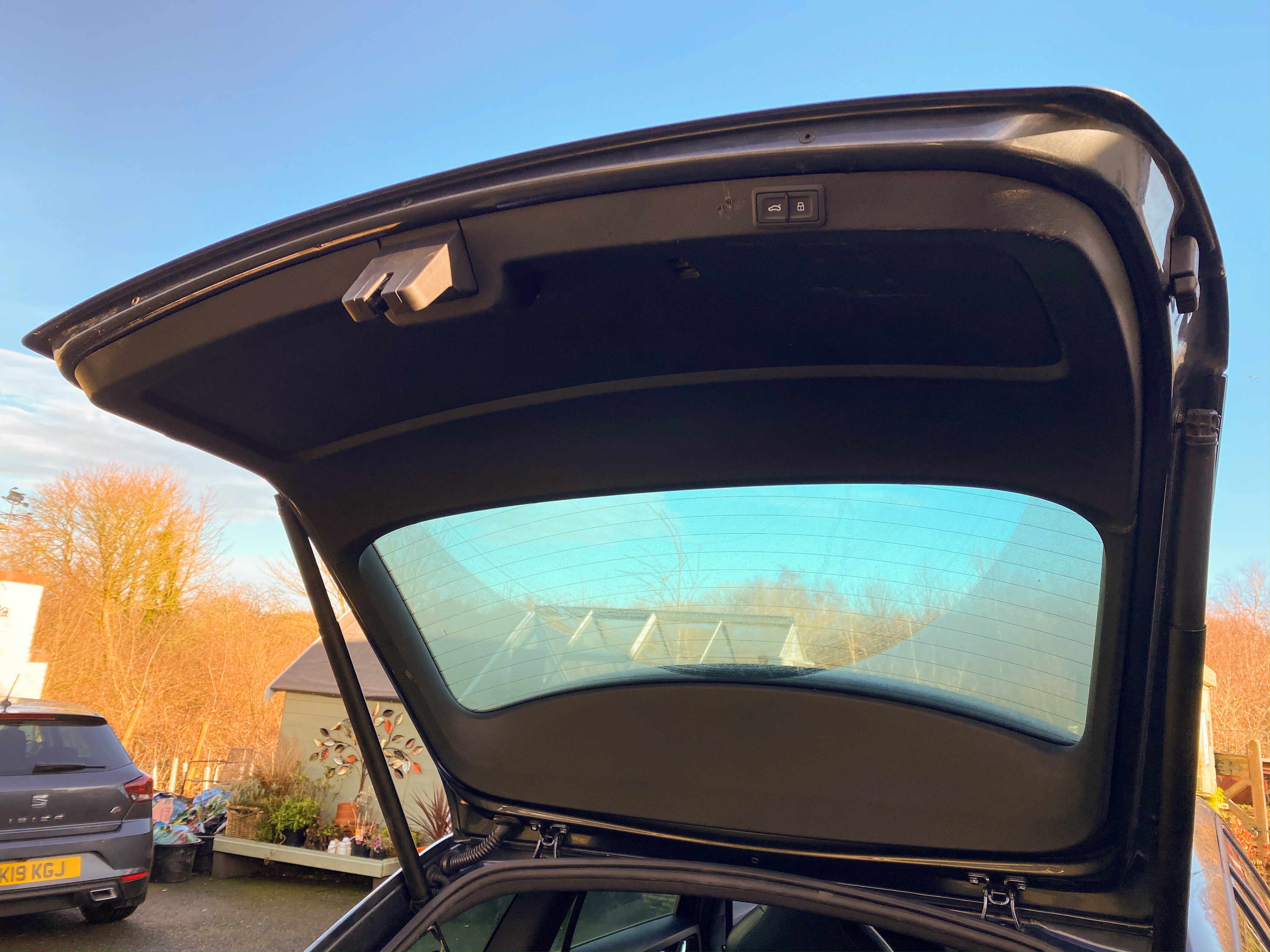

I enjoy these projects but yes, having the end result work is what I’m after. I’m patiently awaiting the next free day I have to work on it and finish it so I can test the operation of the boot lid.

Still waiting for the button but it doesn’t seem essential with this kit, as above it’s not like a factory loom, it’s built to be retrofitted so it’ll be interesting to see how this all plays out. I’m hoping to make it work just from the key and tailgate buttons until the dash one arrives unless it comes this week and then I’ll fit it at the weekend.
