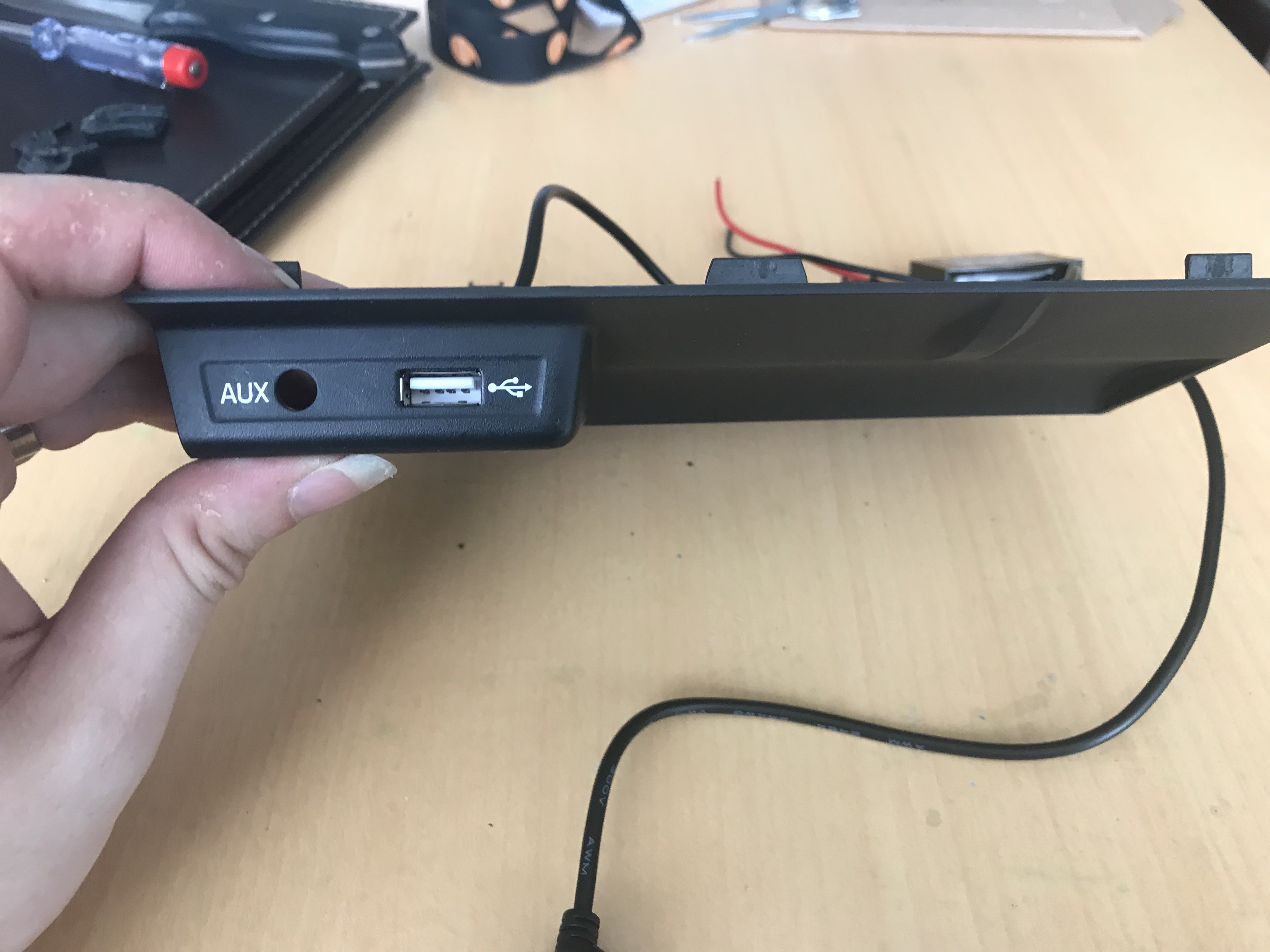

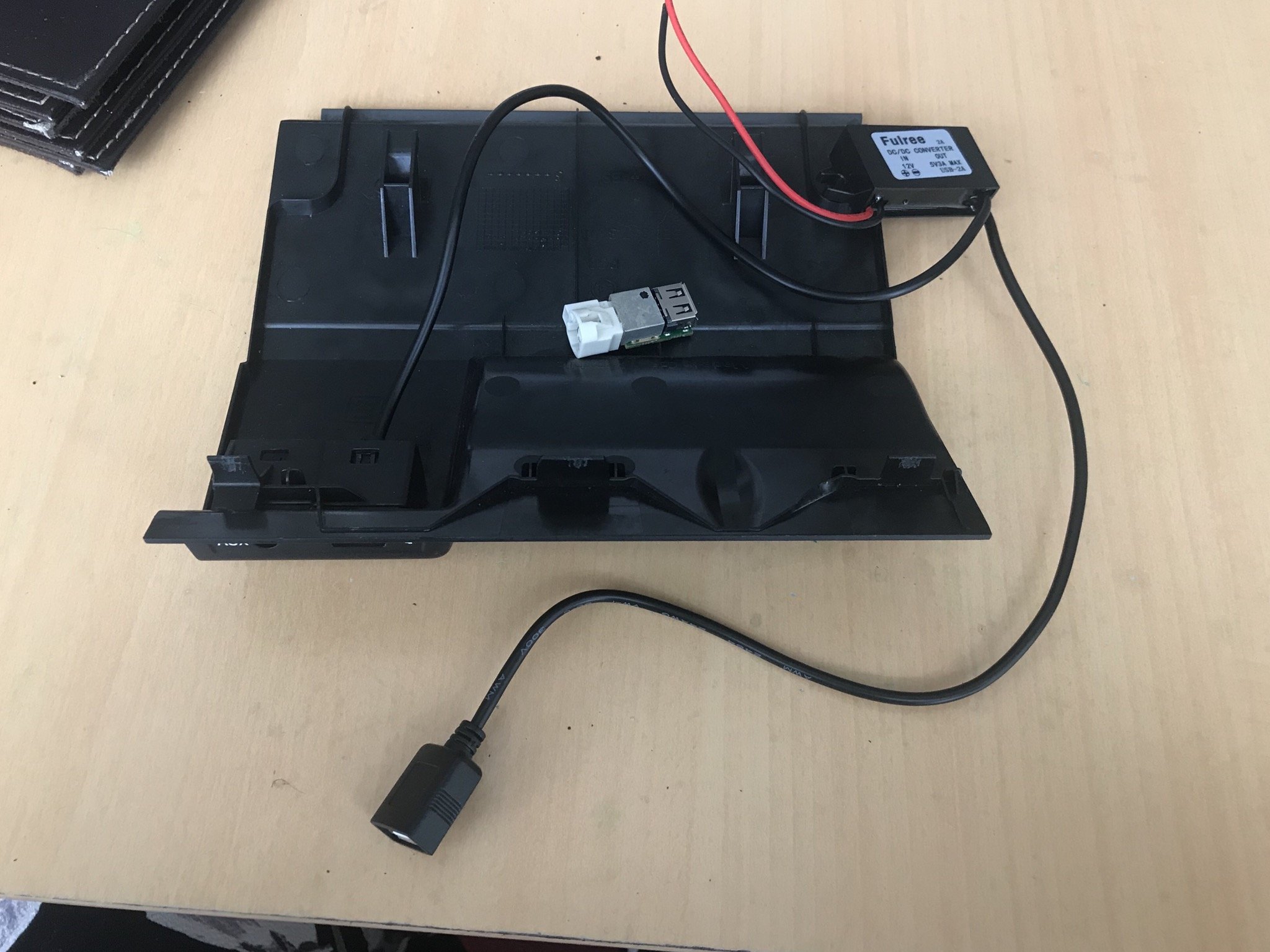

A long time ago I made this USB charge socket and routed a lightening cable below the trim to the centre console. So I’ve just plugged the dongle to the factory USB and hidden it away.
Nifty bit of kit. Looks like it's available for around the same (non discounted) price on Amazon.

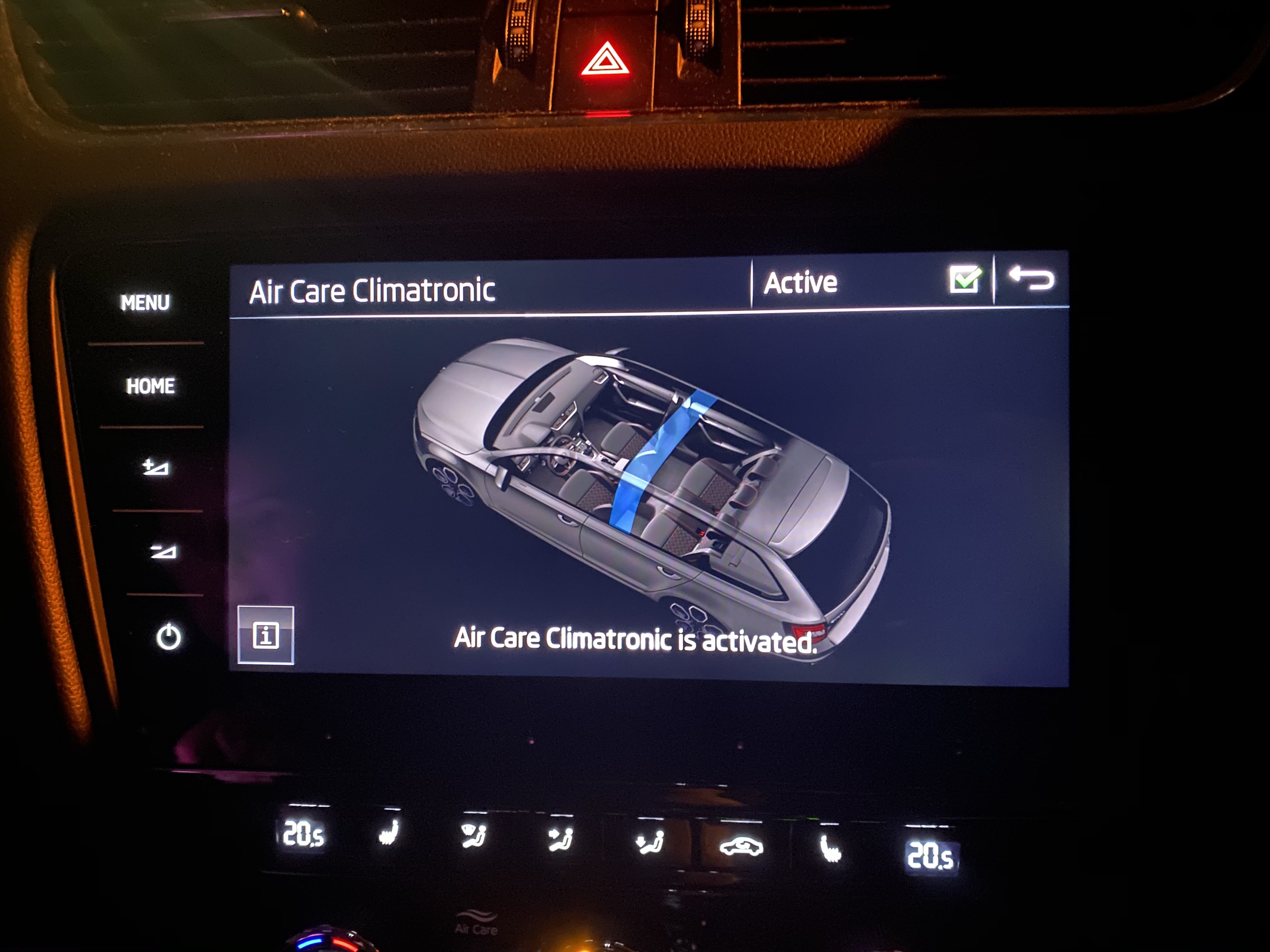

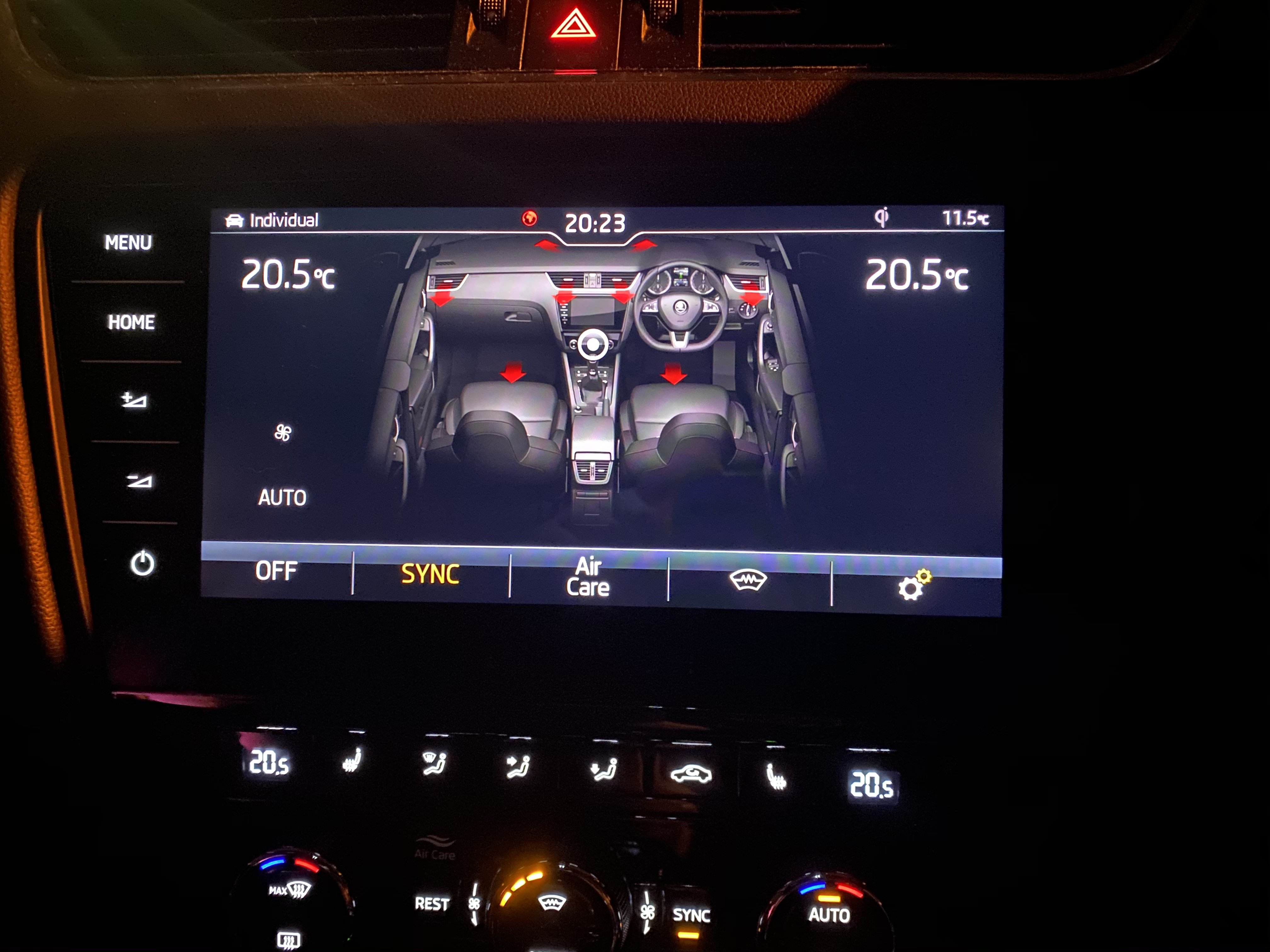

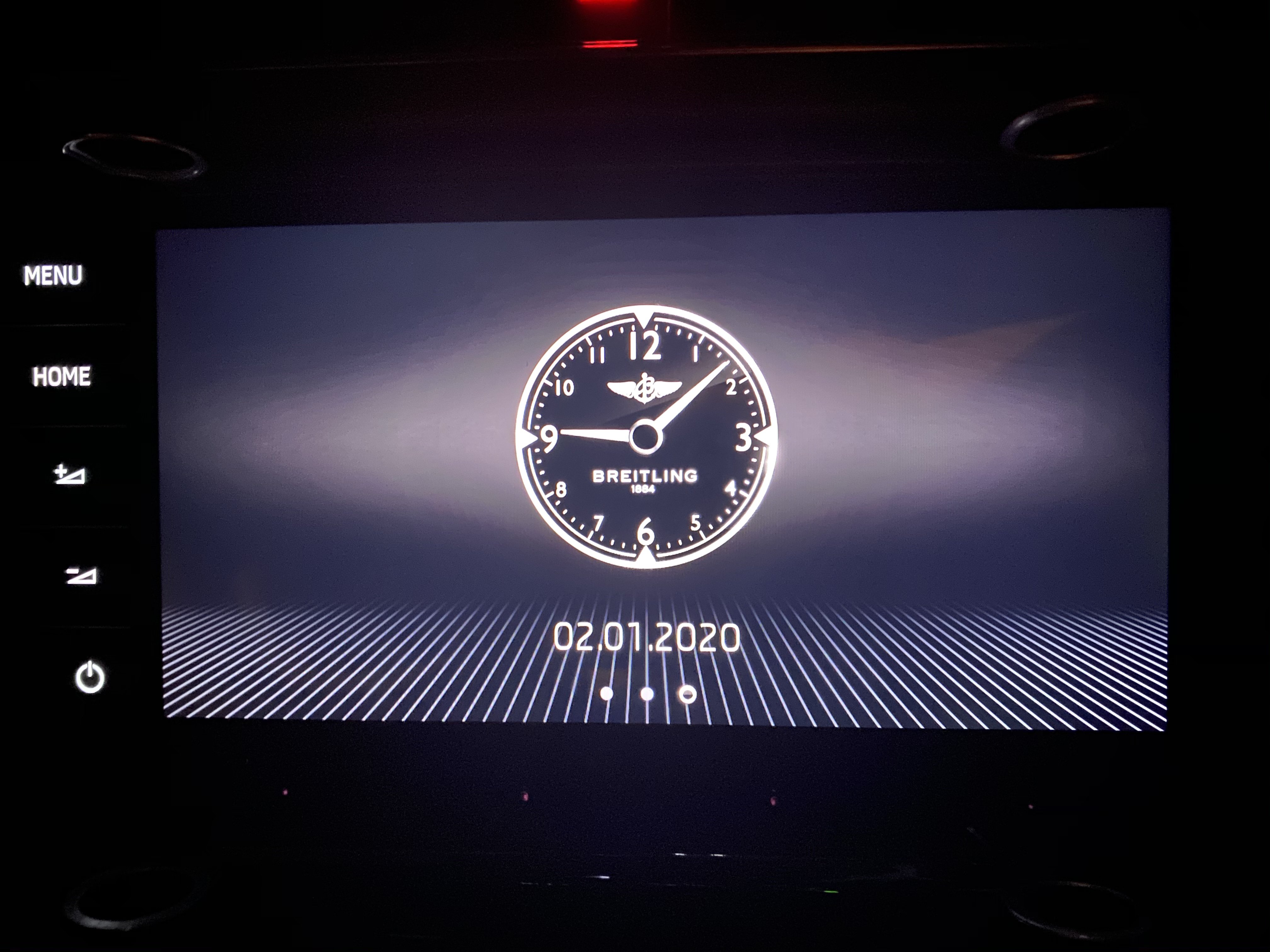

As many of you know, I have a Superb FL Climate panel among other retrofitted items but my trim is an Air Care branded one and I’ve never had Air Care. Until now!!
Thanks to the genius team at MQBCoding for the Instructions for DIYers!
Required setup:
-> new hypoallergenic
cabin air filter ( coated yellow!) -> MIB2 (Std2 + High2) infotainment system with MJ17 firmware
(High: VW from 0687, SEAT from 0674, Skoda from 0702)
-> Automatic climate control with a software
version of min SW1401 (there is only ONE version for all derivatives (except A3 / TT).
-> Gateway min. On index AJ SW1244 / 2244.
If all requirements are met, you have to code in the climate control unit STG08:
-> Activate byte 15, bit 5 ->
(alternatively via VCP TXT Coding -> Activate filtering, recirculating air!)
Then, if the AirCare is not displayed in the air conditioning control panel under SETUP - simply do a short bus rest!

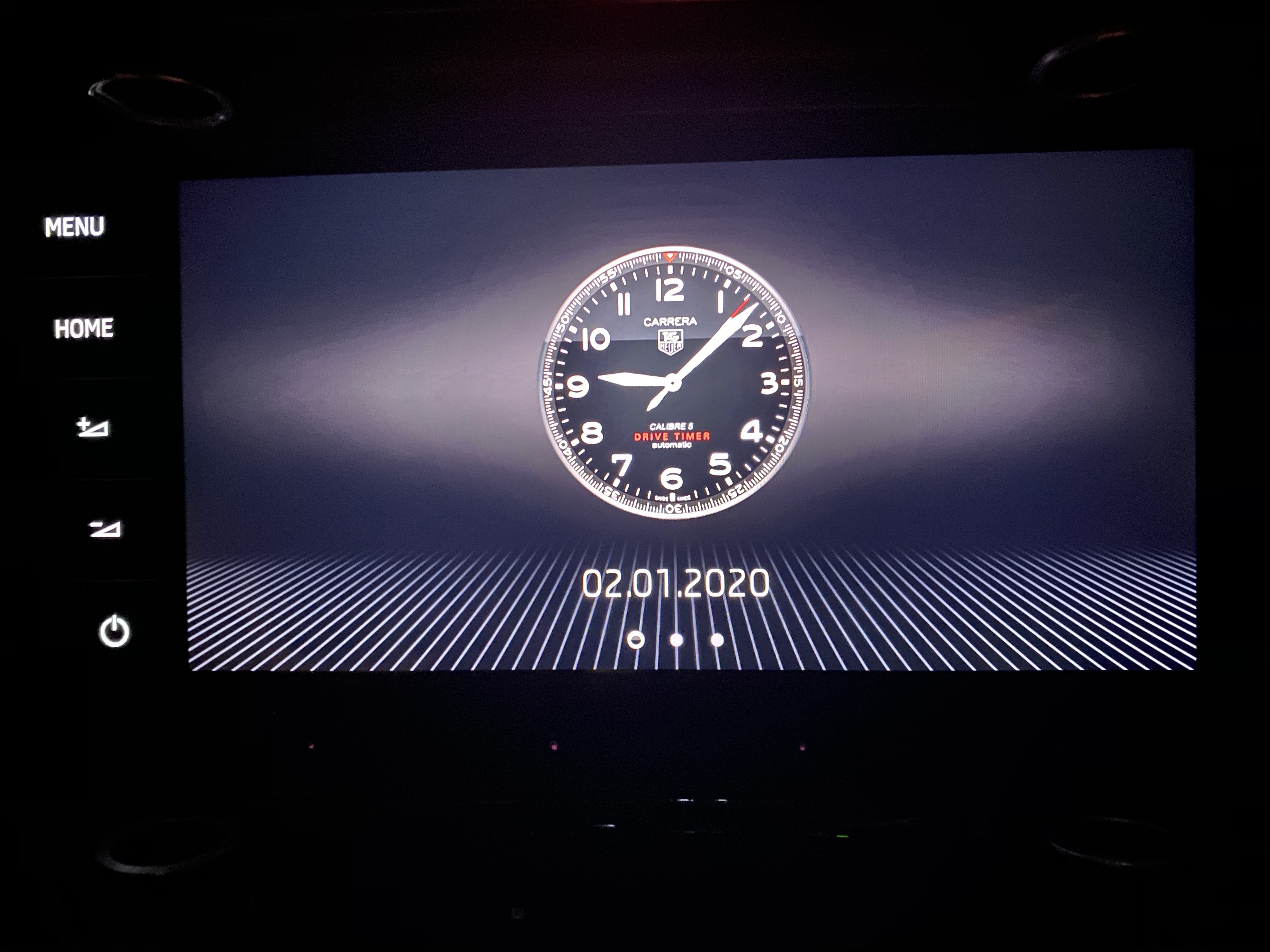

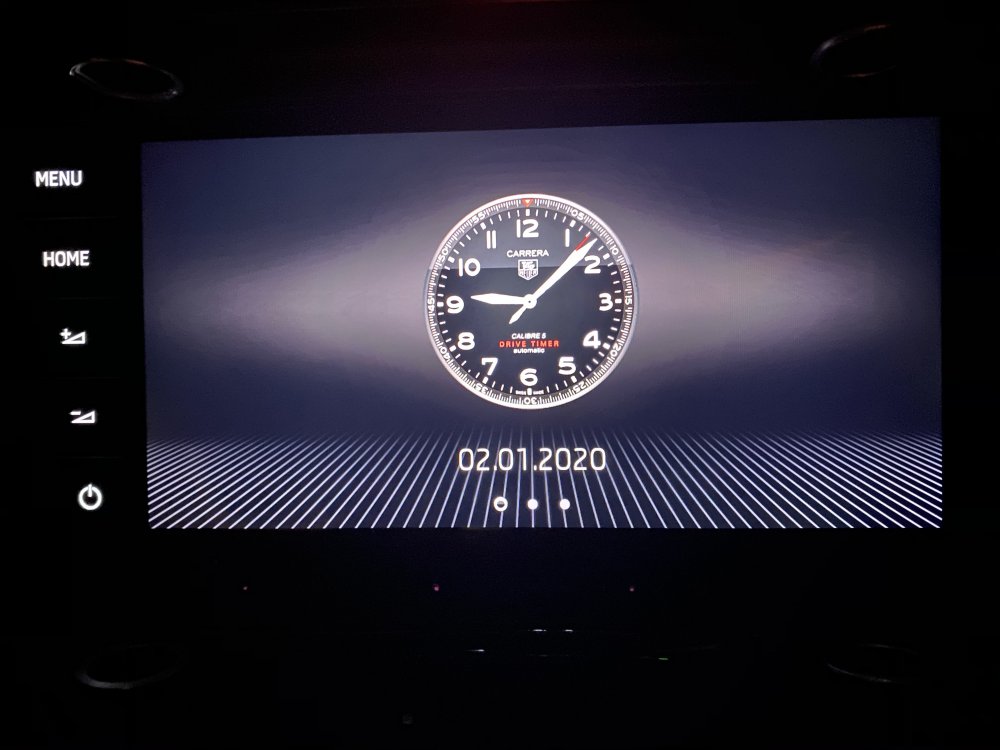

And the more exciting tweak thanks to the super duper geniuses at MQB Coding are these new clock faces, made possible by the MIB Toolbox for MIB2 and 2.5 Columbus radios tested and working here on 1163 firmware. This toolkit can do so much with MIB’s but it’s very easy to brick the unit so please play carefully. Next job is to change the colour of the car in the menu to Quartz Grey and maybe do some more custom icons but for now please enjoy the Bentley Breitling and TAG Carrera clock faces. I’m just glad to have been along for the ride to test it on a Skoda 🙂
Link https://github.com/jilleb/mib2-toolbox
