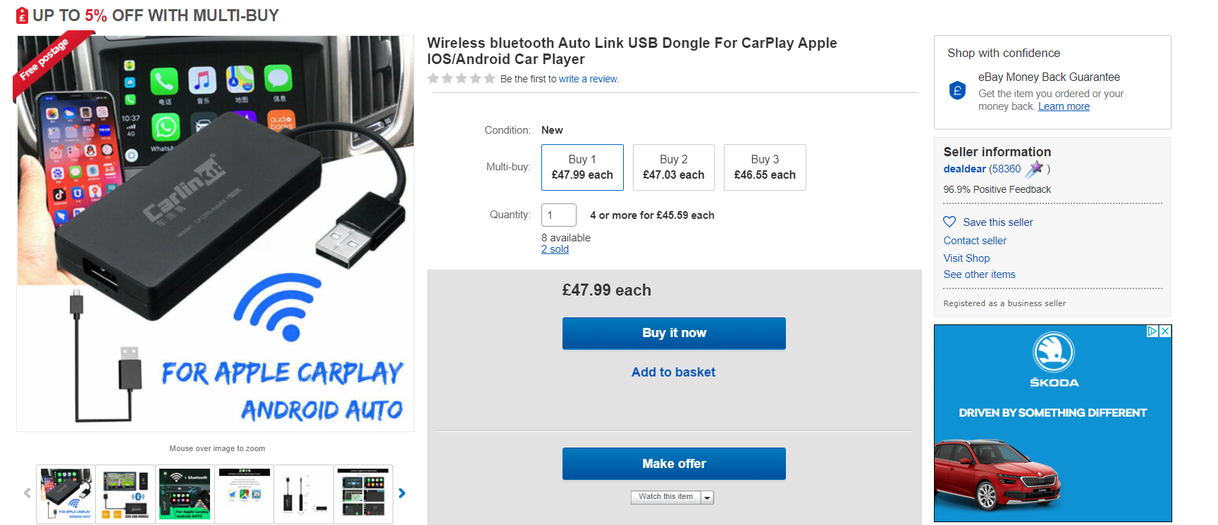

No specific model number - or is there just one type?
Only looks like you can get same think on ebay from UK.. for less... which is UNUSUAL...
THANKS
It needs to be for a VW/Audi radio, the one on eBay could be for a WinCE/Android radio and they are much cheaper. Make sure you get one that is meant to work with a MIB radio.

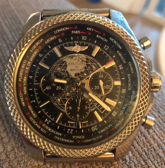

Now that doers look cool, This being my daily wear I wonder if this Bentley Breitling could be displayed
Edited by Auric Goldfinger
2 hours ago, Badlammy said:
Did you do the adaptation to keep the aircare always on too? Otherwise, you will notice that the default is off if you check the climatronic when you next start the car.
Not yet. Not sure I want it always on but I do have the adaptation :)
If you could make the watch face into a png then yes, you could.

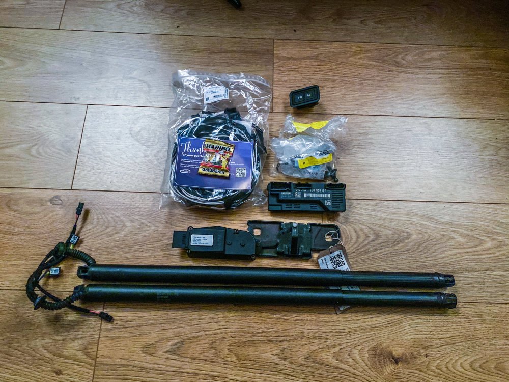

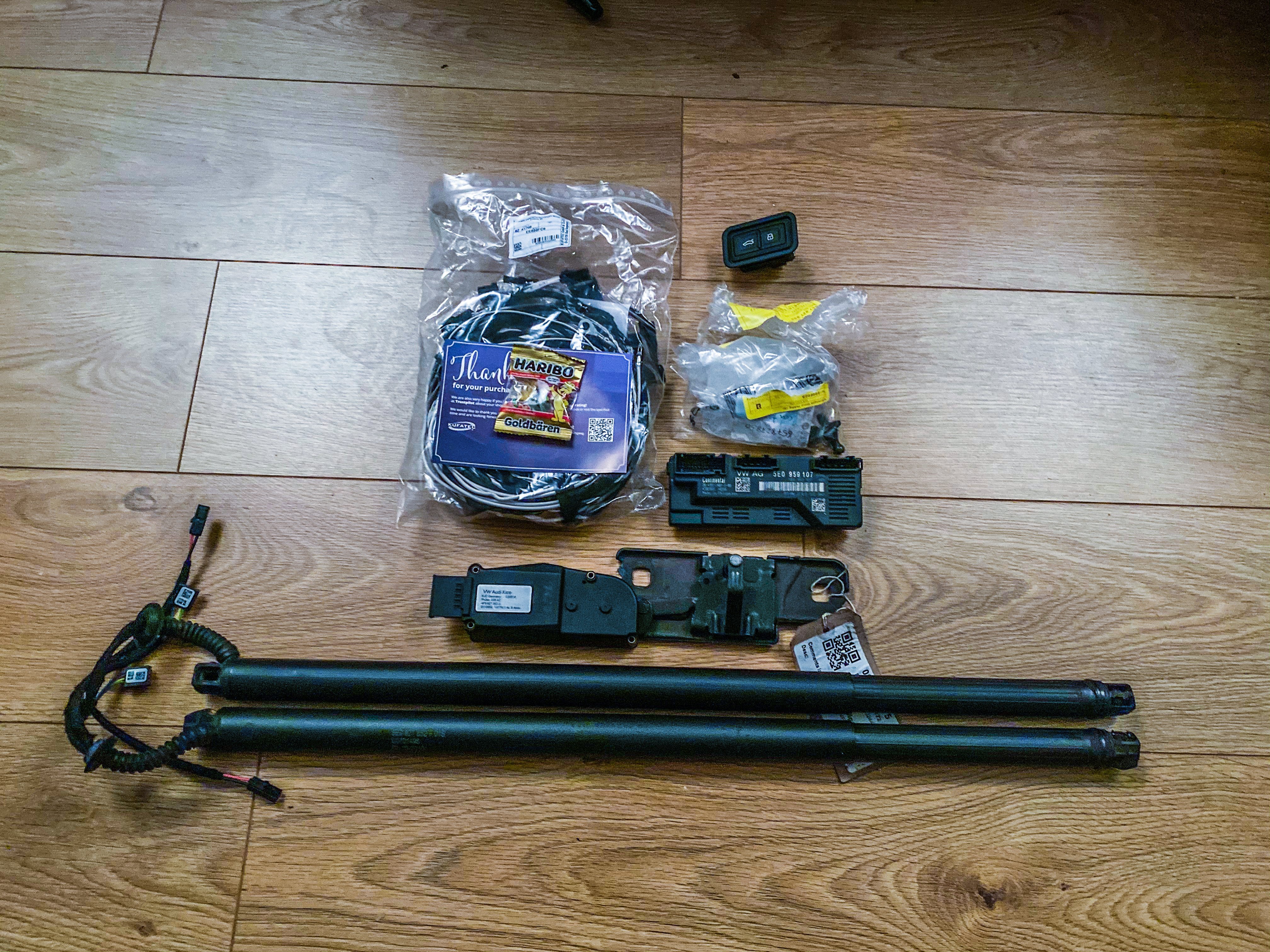

Got almost everything for the power boot now, just waiting on TPS to supply the button panel for the dash and the blank for the tailgate trim as I no longer need a pull handle and I don’t have the warning buzzer but I am 99% sure it’s a park sensor one and I don’t really want to fit it anyway. I think I’ll try and make a start on this tomorrow, lay the wiring and see if I can test it, hopefully it’ll all work 🤞👩‍🔧👩‍🔧
Bonus of retro fit, I don't think factory comes with the Haribos!!!
Love the flooring
