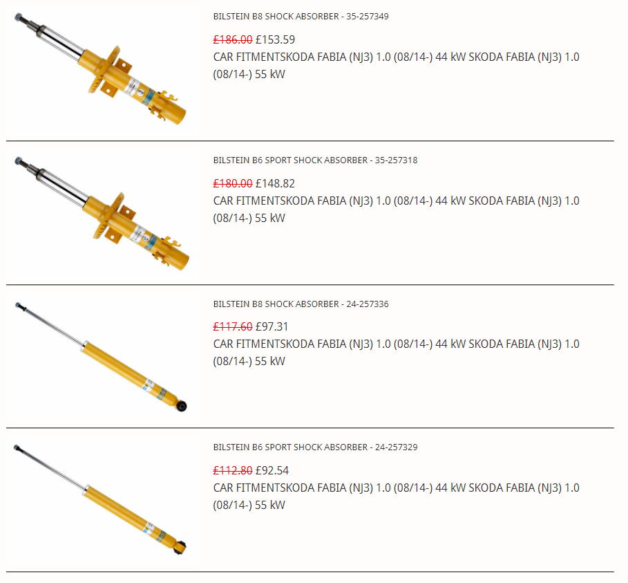

I've been looking at Bilstein's website, having a dumb moment and couldn't work out what I needed. Looks like you buy them individually and one of the B8s listed for the fabia was more expensive than the other. With the springs I had to get the front pair for the diesel as I've got the 1.2 tsi with dsg.

The B4's (not listed on that picture, but they're usually just black like OE shocks), are designed as OE replacement parts.
The B6's are slightly stiffer (don't know any exact number but supposedly somewhere between 15-25% stiffer than standard), but same length as the standard shocks, these are designed for people who want sportier shocks but standard (or very tiny drop) ride height.
The B8's are the same as the B6 in terms of stiffness, but are shorter, and are designed for lowering springs, you still get the same amount of compression travel before the bump stop, but the unloaded travel is reduced, stops the springs coming off their perches if you get some "air time" over a bump or something.
Because the Eibachs aren't a huge drop (though not minor), you can get away with either, but at extremes of suspension travel (usually when unloaded, i.e after coming over a small bridge at speed and you get a little "air time") the springs can potentially become unseated from their perches, this becomes more of a risk the lower you go, but the B8 shocks are designed to eliminate this.
I also read that the B6 and B8 shocks both have built in bump-stops, so there's no need to transfer them across from the standard ones. Might be worth contacting them though to make sure though, don't take my word for it.
Edit: The FRONT shocks do indeed have built in bump-stops, so no need to transfer them over there, however the rear don't, so it'd probably be worthwhile to maybe get new bump-stops and see how much gap there is, and maybe cut them down a little. Hitting bump-stops is the worst.

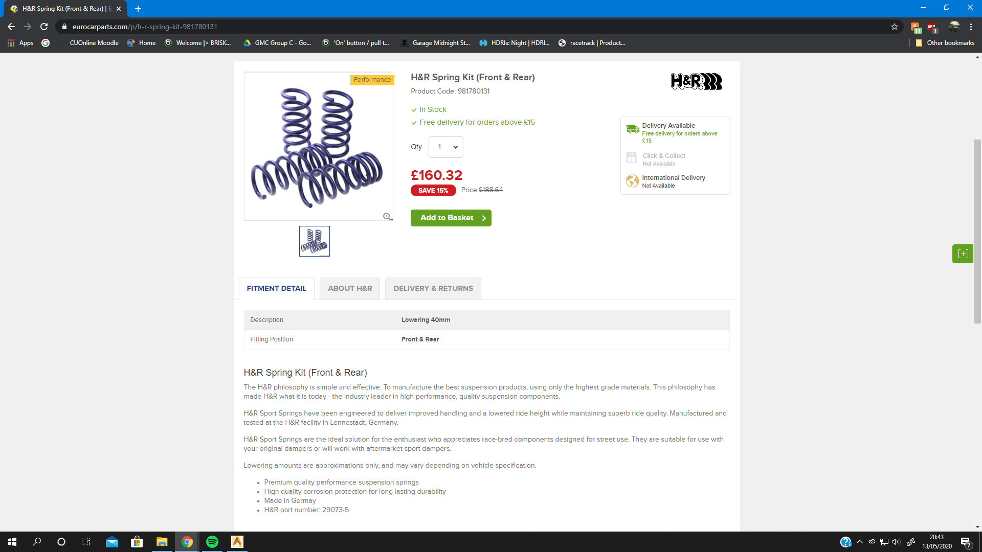

Are H&Rs any good? It's saying that these are 40mm are for front and rear.
H&R springs are linear, so they'll be slightly stiffer under normal driving, but will provide slightly better initial turn-in and more consistency through corners.
Eibachs are progressive, so they'll be closer to stock in terms of normal driving, but stiffen up when loaded (heavy cornering etc).
Both provide about the same appearance in terms of ride height. If anything, the Eibachs are a tad lower.
