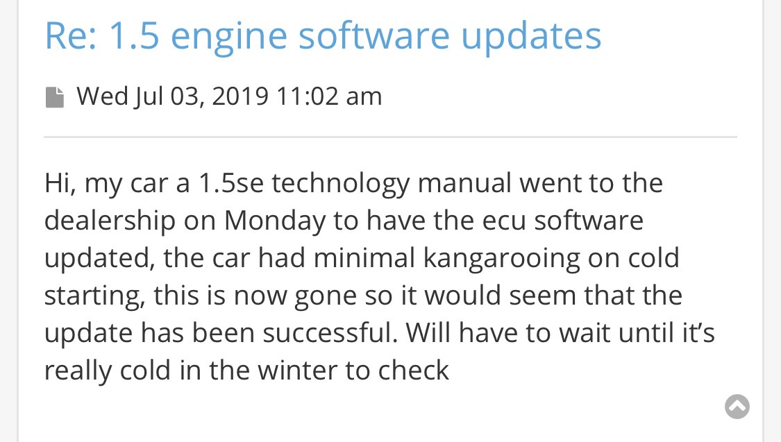

My fix for the first gear issue is still working 3000 miles at having it applied. I have got faith again to pullout quickly at junctions without the fear of the car not responding. It is quick off the line just like I had expected when I bought it.
I need to chase up the separate fix for the kangarooing as it should be out soon.
I got my issues sorted by going to Skoda UK directly - my dealership was did not know the fix was available.

I’ve  also gone direct to Skoda but still waiting for a fix for my MY18. My issue is engine dying when moving off. Not so much the kangarooing.
 Mine was built late Dec 18 & registered Jan 19 (1,5 Manual Karoq).
I had the moving off issue (couple of scary moments when the car failed to pull away -  almost like stall protection had kicked in which happened to Max Verstappen at the start of a recent F1 race  when his car bogged down).
The fix has solved this. If you pull away the engine appears to no longer let the revs drop below 1000 rpm and they bottom out around 1200 rpm.
