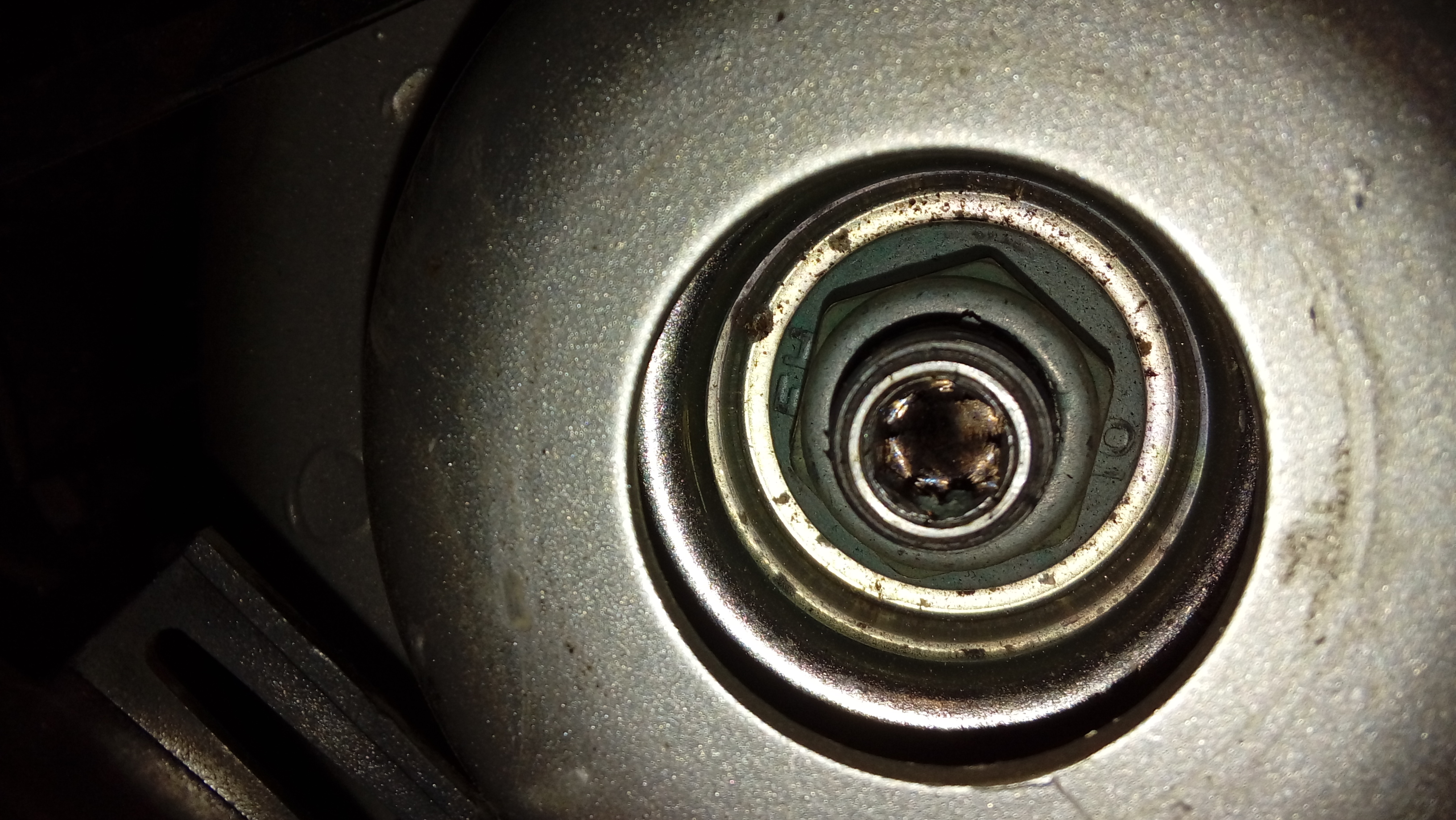

Top mount nut accessed from under bonnet 21mm socket and 7mm Allen key - checked sizes myself.
My question - does a swan spanner actually fit. The nut is quite deeply recessed. I could buy a 21mm just for this job. All images of products show that there is no particularly deep swan spanners.
Other option is a 21mm socket with the side cut out, like used to remove oxygen sensors. Again the nut is quite deep in the top mount. Allen key might be obstructed.

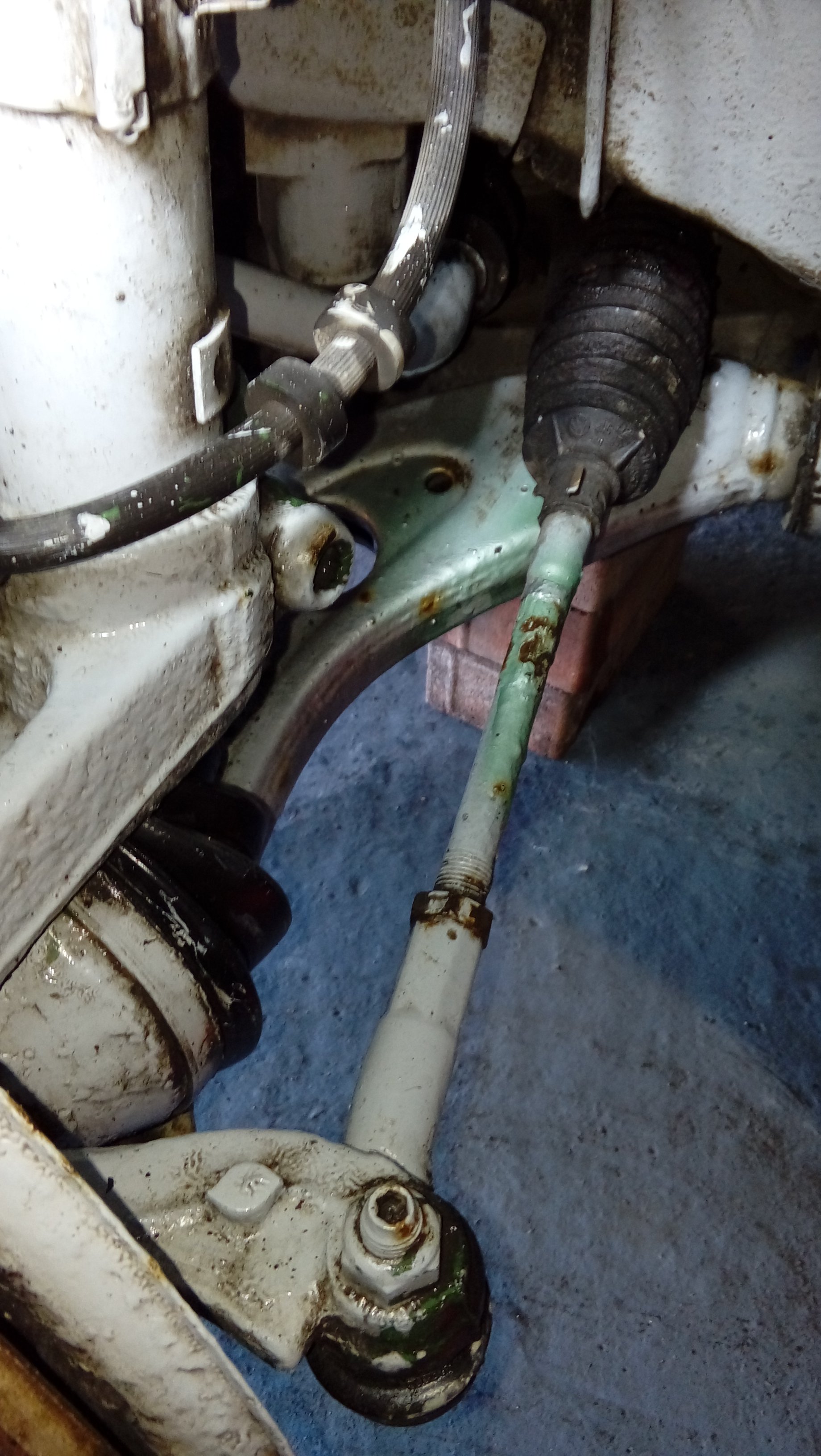

Finally, there is mention of making the job of dropping out the strut easier by removing the nut on the tie rod or ball joint on the lower suspension arm. Apologizes if this is wrong term. It is connected to the steering. See image. The part , rod, on the bottom middle.20180317_153032.thumb.jpg.a9fccca7c2985c4b1bfe76a632d61c90.jpg

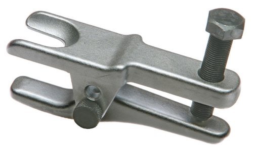

Tool needed is a ball joint separator tool like a pitch fork or less destructive tool in like this ball joint separator.
What size is needed, or better to buy the set of 3?

Strut top nut, I was lucky first time and had a spark plug deep socket that had a hex pattern on the top, and with that you can either use a long allen key or a long hex bit.  Second time round I used a Vortex drive through socket, very handy tool kit to have.

Getting the top nut undone can be tricky, especially if it's been there since the car was built. (21mm) Spark plug sockets can be a handy way to do the job, as they tend to have a hex on the outside that you can get a spanner on, whilst leaving the square drive hole free to get a 7mm tool through for the counter-holding (example here, if you don't already have such a thing).  Big force will be required, use a sturdy vice to hold things if available (or (just) loosen it while still on the car, prior to undoing the three top-mount bolts).

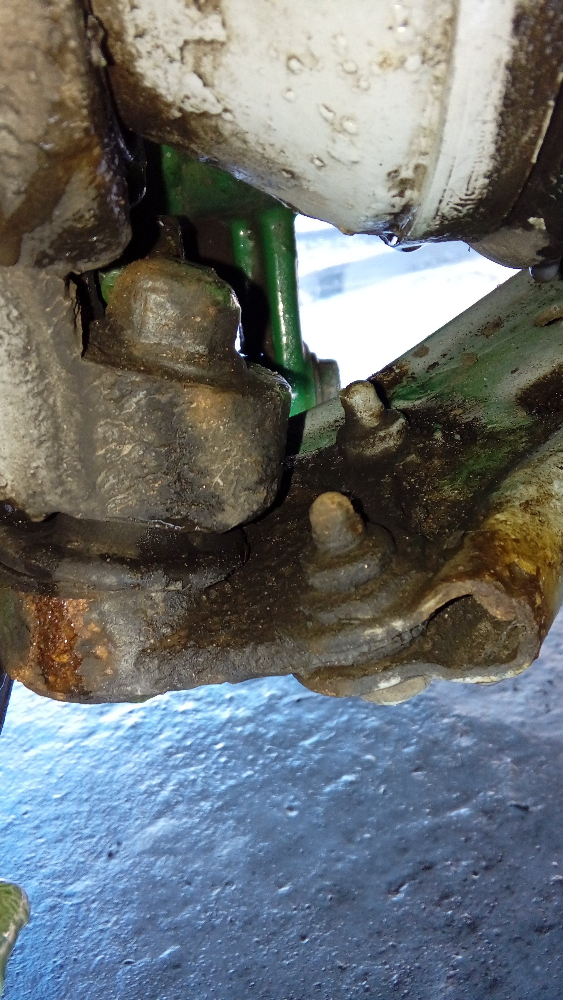

With the lower swivel / track control arm/ also called 'wishbone' or 'A frame'? So many terms out there. Are these the bolts I need to loosen ? See image please.
Image is front left side looking forward behind wheel hub etc. CV joint is to top right of image just out if frame. Does this contain the ball joint, middle left of image? Is it worth replacing at 75k?

Yeah, either the three M8's (which should be replaced when removed) or the 19mm nut that holds the joint to the bearing carrier. Popping the joint out of there after the nut is off may/may not be straightforward though due to access. Ball joint only needs replacing if the boot is torn really.

A 21mm spark plug socket works brilliantly for the strut damper top nut because you can use a spanner on the flats of the socket and insert an allen key down the middle to hold the rod.
Slightly loosen the nut while the strut is still on the car as it makes it easier once the strut is off.
On reflection, I can't think of another use of go through / Vortex sockets. Unless I was going to do this job on a routine basis I think a spark plug socket with a spanner is an excellent idea. I'll try this first. Thanks.

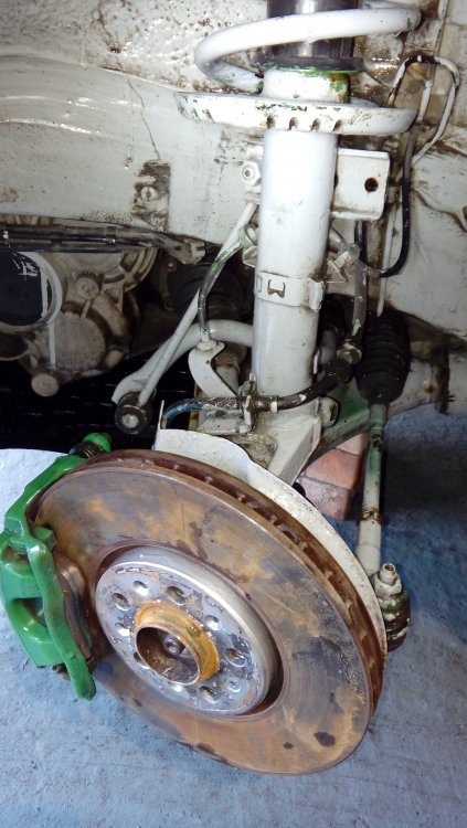

This is how I did mine, I didn't have all the necessary tools so had to improvise.
Jack car up
Remove wheel
Remove TRE nut, hit hub with a hammer to pop it out, one precise hit is all it should need.
I then removed the bottom ball joint from the wishbone leaving it in the hub.
Undid the nut on the strut securing bolt, it stayed still so I could slacker it off but I had to grip the bolt head woth mole grips as it started to spin.
Unhooked the ABS wire from the strut.
Removed the drop link from the strut, I used a hex key and crank spanner as it span.
Put spring compressor on the spring and tighten to compress the spring.
Undid three top mount bolts.
Pulled it up, had to tickle the hub down with a hammer as the strut was stuck in well and truly. Ideally you would have removed the driveshaft nut and removed it from the hub but I didn't have a big enough socket so I wiggled the strut around until I got it out.

View from engine bay of top mount 21mm socket with 7mm Allen key. Laser sell a brake caliper 7mm key that is larger than the DIY sets. Also the common DIY sets don't have 7mm size.
