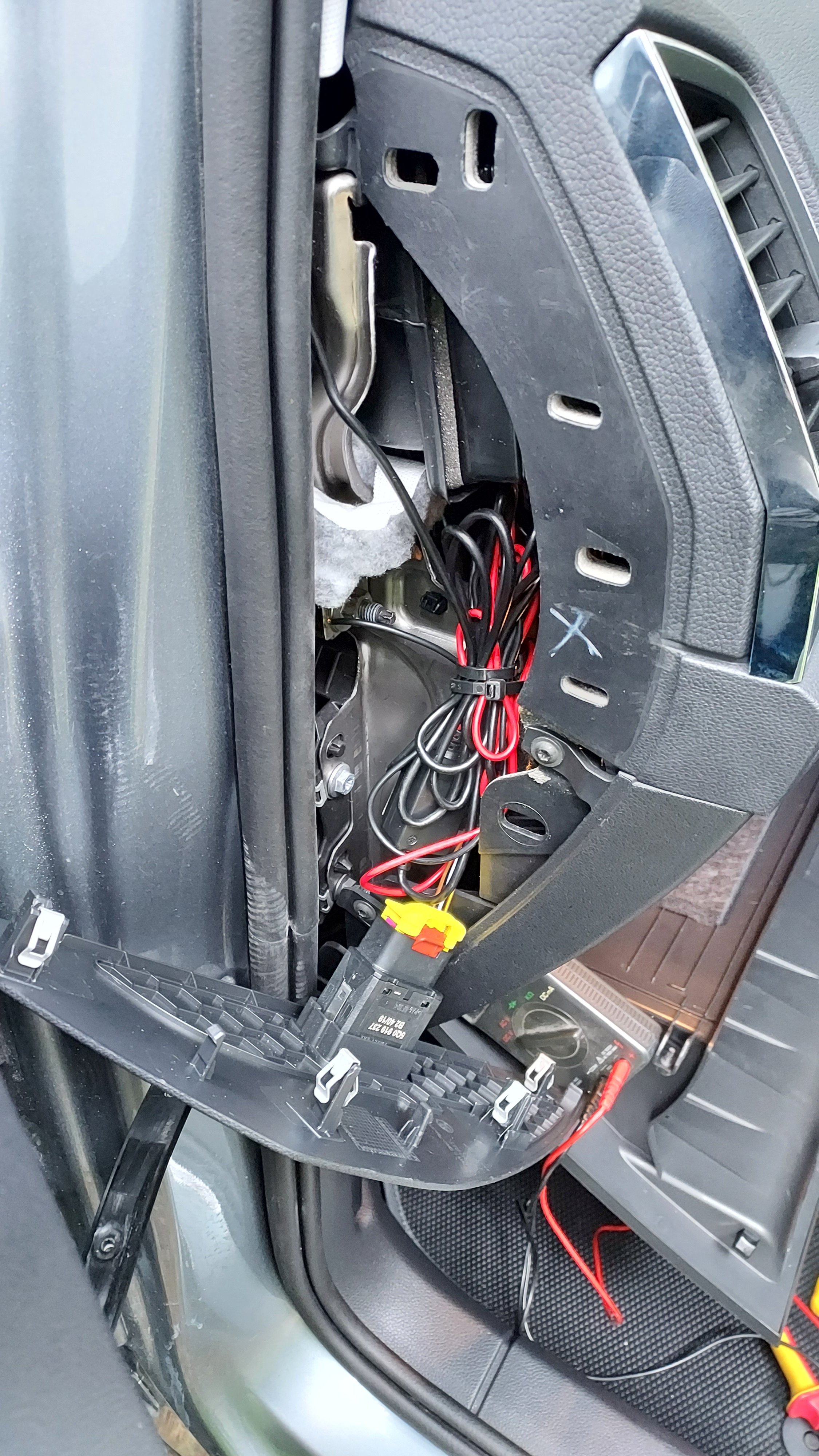

Got the job done - a bit fiddly but not too difficult. Much as I tried I couldn't get the A-pillar trim all the way off, managed to get it off enough at the top to be able to push a length of thin plastic rod down from the top. Didn't want to force the trim any further in case I broke something - it's very tight against the dashboard at the bottom so I guess that doesn't help things? I then taped the dashcam plug to the rod so I could pull it up through again with the cable, making sure it was behind the airbag that runs behind the trim. Was just then a case of tucking the cable behind the headliner, making the connections at the fusebox end & tidying up the excess cable. I used an unused fusebox slot that is ignition-switched.
Job done - very pleased with it.

    Hi all, popped the panel closest to the door and it came away easy enough. You can get to the fusebox through the side here and there's two points into the frame you could use to ground. Just thought

    Pull towards you not push away https://www.dropbox.com/s/9e5w02f7nwbnhh0/VID_20190302_174557_01.mp4?dl=0

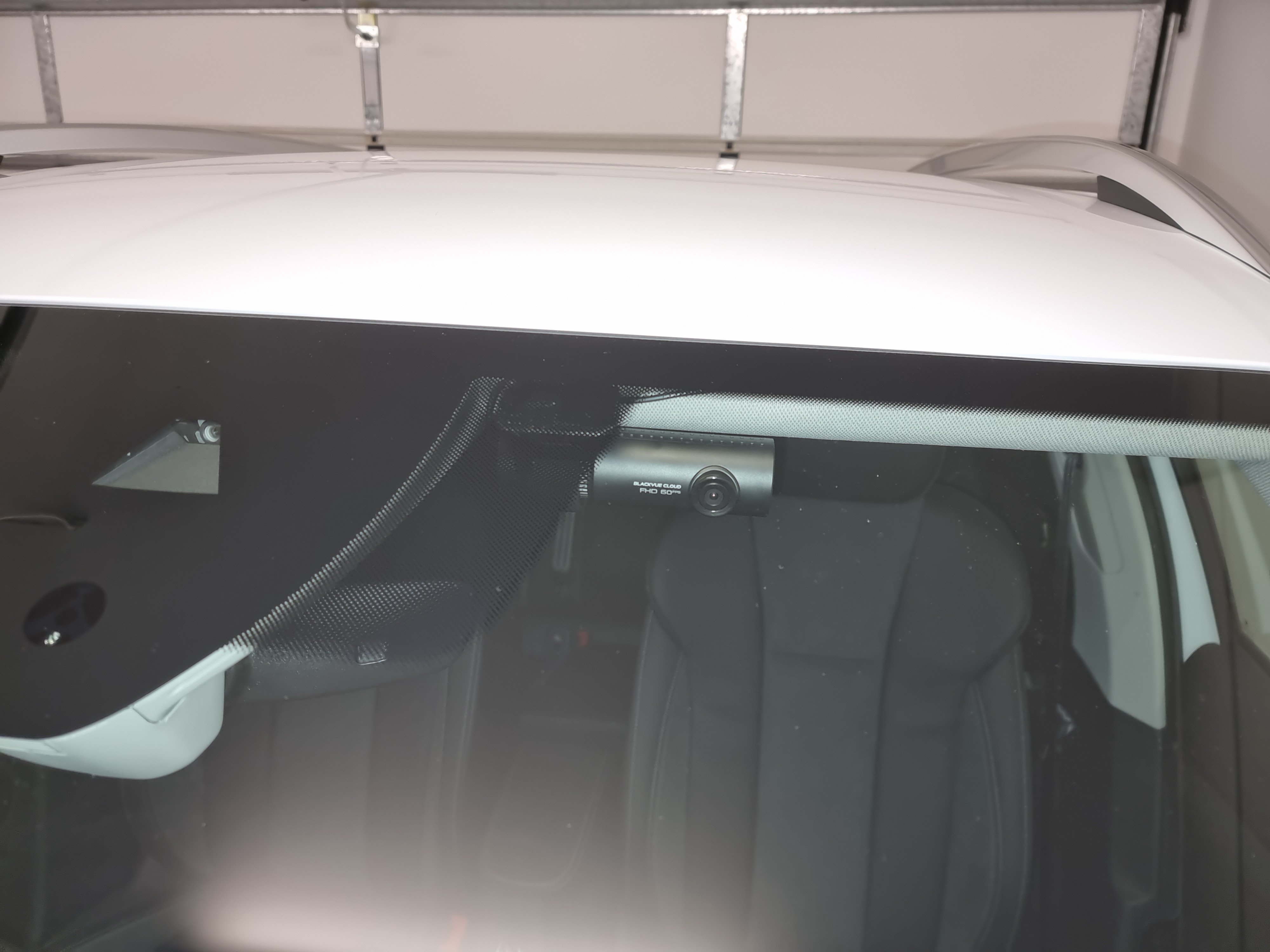

There are a few posts here and, I think, on the Octavia 3 forum, about having the cable between the screen and the A pillar to avoid the airbag bringing the cable with as it goes off.
The issue is probably about what's likely to happen to the dashcam cable if the airbag actually goes off.  Does it pull the cable with it, possibly pulling the cable out of the headlining and pulling the camera towards the passenger, or would the airbag direction not have the cable in its line of fire?  My (admittedly non-professional) view is that whichever side of the pillar trim, the risk is about the same.  No two accident impacts would produce the same result.
So rather than remove any pillar trim I've got the cable tucked just under the edge of the rubber trim that runs down the pillar and therubber edge is just over the plastic pillar trim.  The cable is actually not under the trim, just next to it.  There's enough flexibility in the rubber to allow space for the cable.
I think it's possible to tuck the cable down the windscreen edge too, and get it hidden enough from inside the car.  From the outside, the black edging on the glass would hide any visible cable.   There'll be a few more suggestions from other forum members later.

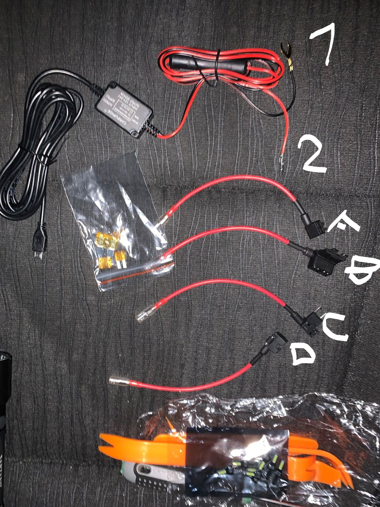

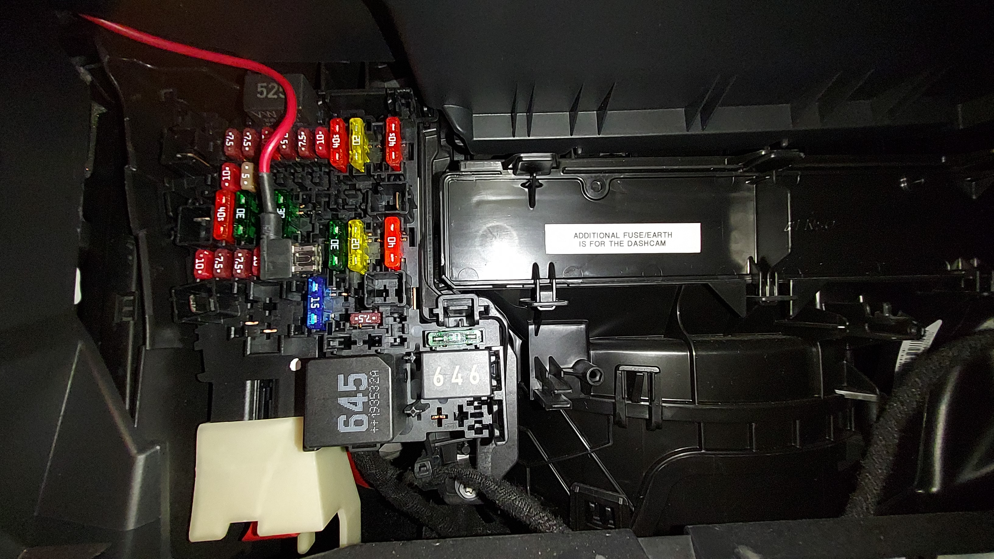

So... I got my package with the wires and everything.
And i can get the wire from the cam all around the windows, down the door and under the panels and then up into the fusebox.
Now my question is ;

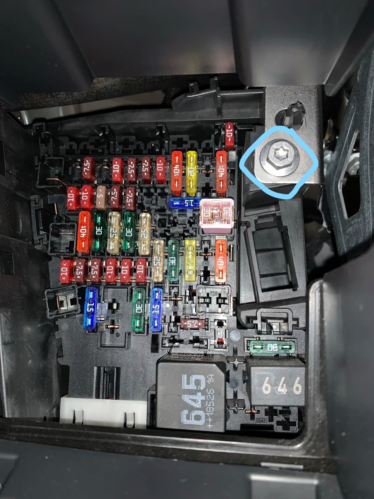

The wire A, should that go on to the blue cricle?

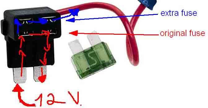

And i can not figure out what cable to use for the fuse box and which fuse insert i should use.
English is not my mother language and theres alot of technical i dont understand.
Can anybody guide my a bit ?
The black wire (1) goes to the blue circle, No.2 goes to one of the other red cables that correspond to the type of fuse you have.
Hope this helps.

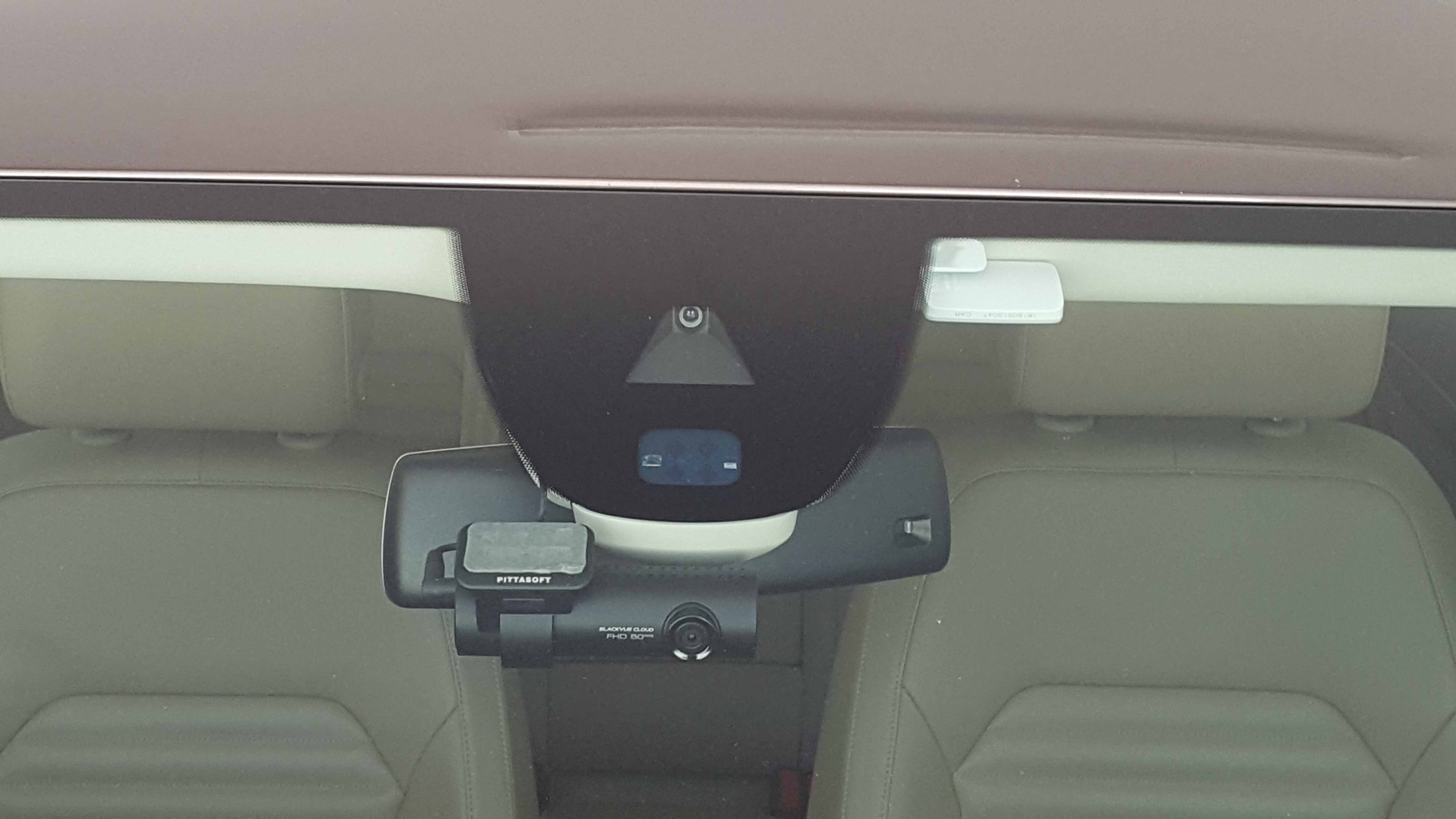

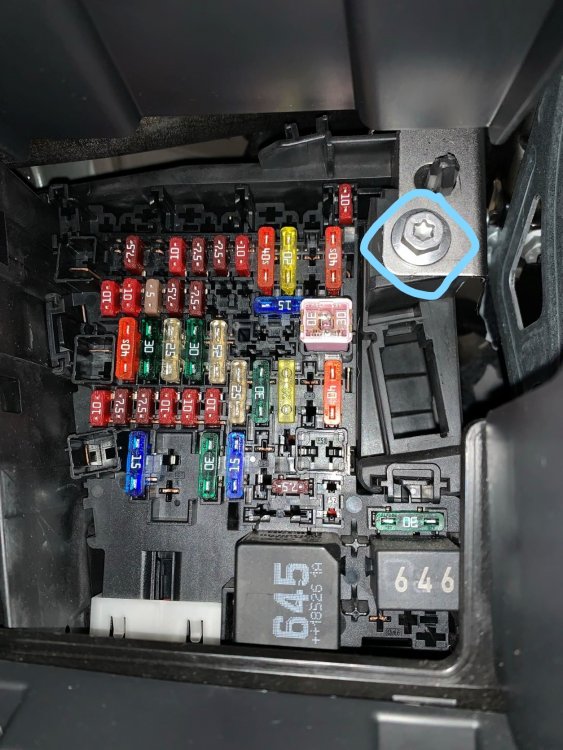

Wiring up a dashcam     I have done them in a Passat, a Polo, a Tiguan and now a Kamiq.
Heres how.  Firstly figure out where the camera is to go. In the Passat and Polo was in front of mirror and below binnacle. In Tiguan and Kamiq is toward centre on passngers side of screen as too low in centre.
Wiring   Fuse 46 in the Kamiq is fine to put a fuse tap in and earth to the bolt shown above.
As my car is RHD i ran the cable from the fuse to an extra ciggy socket and retained the original plug  12v camera. For 5 volt do this also as stepdown is usually in that plug.   Ran wiring across behind heater  stuff and glovebox to door seal.  Pulled A pillar cover off to give a gap at the top  Ran up the door seal and poked a heavy cable tie in behind the air bag  and it came out between front of roof lining and screen. Pulled the camera cable through and along front of roof lining . Put camera in place leaving clearance to get power cable in end nearest binnacle.
Using a BLACKVUE  (not a Blackview which is a crap camera).  Working back from camera I tucked the cable up behind edge of roof lining (gently) and then tightened it down the door seal to the end of the dash. Pulled excess back to the fuse box and tied it up neatly  For rear camera in the Tiguan  (havent done Kamiq it will be similar)  run cable from front camera same as above down door seal to floor and along under inner edge of door sills into the rear quarter.
Up the rear and after taking trim off top of tailgate you push the outer end of the plugs at each end of the wiggle cable and it will pop up but be careful as it can break the clip at other end if you are too forceful,. Using a wire or plastic tie poke it from door into car and pull the cable through to camera.
Tidy up as before by tieing up in rear quarter.
I actually use two separate cameras and is easier as only need to run a power wire along floor to a ciggy plug in rear corner and use an earth point in there. All works fine but I dont use parking mode but if you use a Power Magic just take two power wires off it if using separate cameras
Cameras and toll tag  are now all painted matte black so can hardly be seen

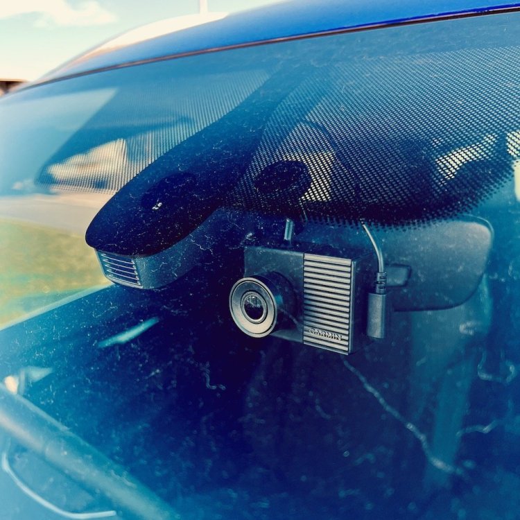

I must be getting lazy...I just couid not find the willingness to start dismantling trim for fusebox access or doing piggyback fuses
One quick solution - Garmin OBD socket connector with built in battery saver and options for 10 minutes, 24 hour or continuous running after ignition switch off.
Stuck to dash innards with a sticky pad, and USB cabling then just run as normal up the side of the A-pillar trim and under the leading edge of the roof lining

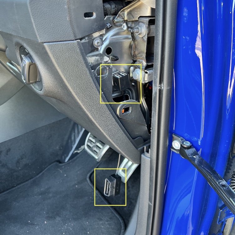

Hi all.

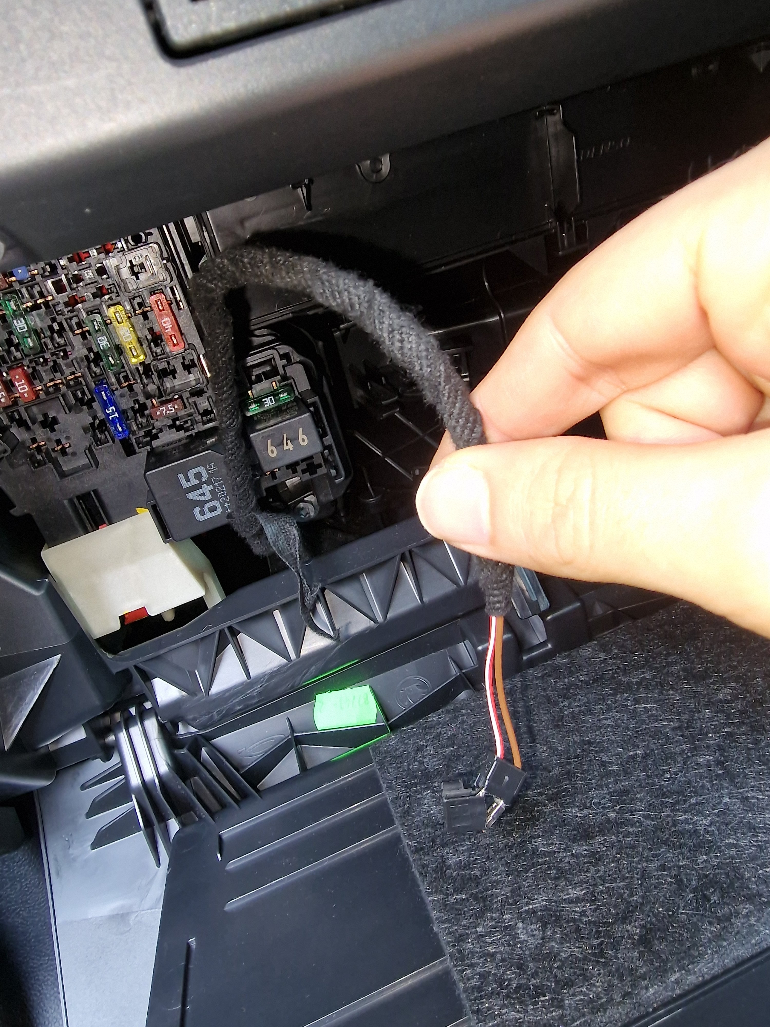

I opened the gloves box today and noticed that a cable in there has a broken plug and it disconnected. I don't think I did it when I opened it. Can someone tell me what this cable is for and if it needs to be connected 20230205_133431.thumb.jpg.6023b40fb174b06a01976b967c802b57.jpg? Thanks
1 hour ago, Avi_d said:
Hi all.
It's from the right hand side of the glovebox.
There is a picture about half way down page 1 of this thread.
Yes you're right. Do you know what it does?
Looks like it could be for turning the glovebox light on when it’s opened.
