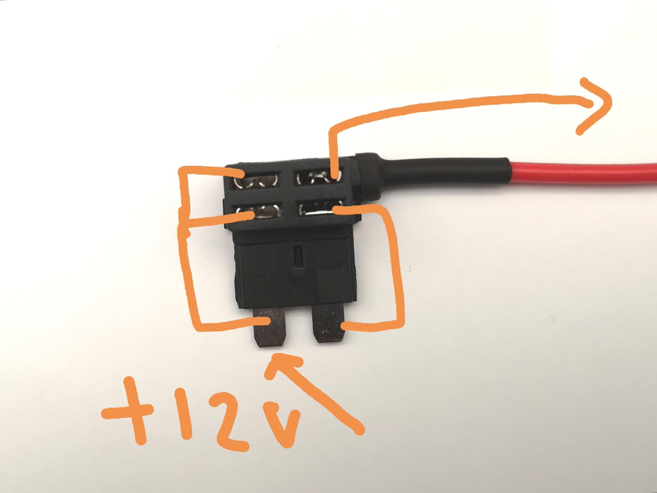

Thank you for the guide. I will receive piggyback fuse tap soon and will try to wire my dashcam using guides from this thread. Have one question.
Did you check which side is + side (line side where 12V is) on fuse box? If you connect piggyback "wrong" way you will have 12V go dirrectly to dashcam, not via fuse.
Personally I would want to know how the piggyback fuse works so belled it out, is pretty simple but came with no instructions.
It's not possible to have it so your dash cam isn't fused. You could however have the 2 fuses the wrong way round (not a good idea), Or have the piggy back tapped on the fused side of the original fuse (just means if the original fuse blows then there'd be no power to the dash cam).
Are you sure? if you connect piggyback fuse side where wire comes out for dashcam on 12V side on fusebox, you will bypass fuse even if there is one in piggyback fuse adapter. Fuses are basically simple wire, which will burn if there is more current going on. There are no sides for fuses. Someone can correct me if I'm wrong.
1 hour ago, Navip said:
Are you sure?
Yes.

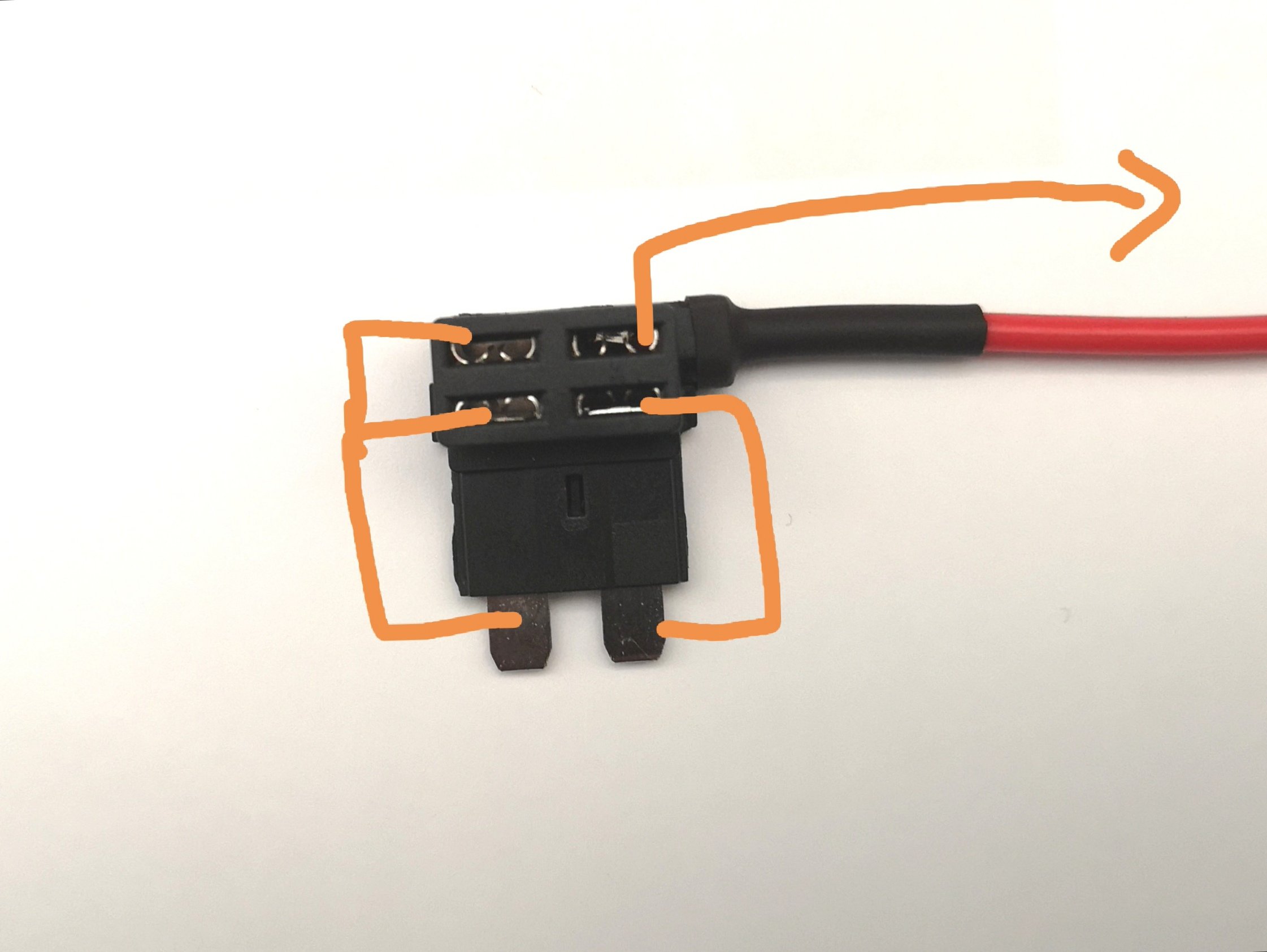

You cannot "bypass" any fuses with the piggy back fuse adaptors. See the attached photo for the circuit, apologies I scribbled it on my phone. Hopefully should make sense.
EDIT: I see what you might mean, when I said the fuses the wrong way around I meant having the original fuse swapped with the piggy back fuse. So in my case I would have replaced the rear wiper fuse 15 amp with my dash cam fuse 1 amp. On the photo the original fuse would go in the lower slot and the dash cam fuse in the upper slot.
Edited by John_S
My bad english
Ideally you want to insert the piggyback adaptor with the +12v to the connector as shown.
Understand now. Thanks for clarification John.

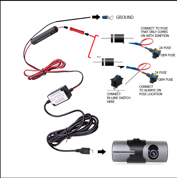

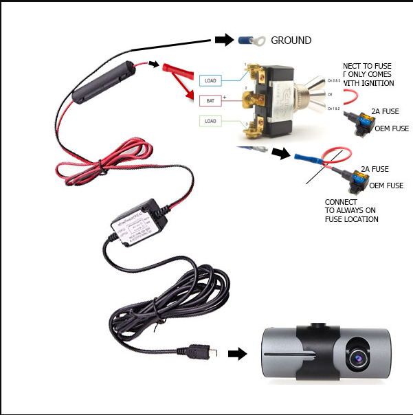

Is this circuit gonna work ?
What i want is 2 things
1.Power the Cam When the Ignition switch is on
2.Whetever i need car park mode , switch ON manually.
The only thing i dont know is what will happen if i swtich on the constant power with the ignition on .
BOTH ON
if there is a problem , i have to USE just a DPDT switch without the DIODES

something like that..
