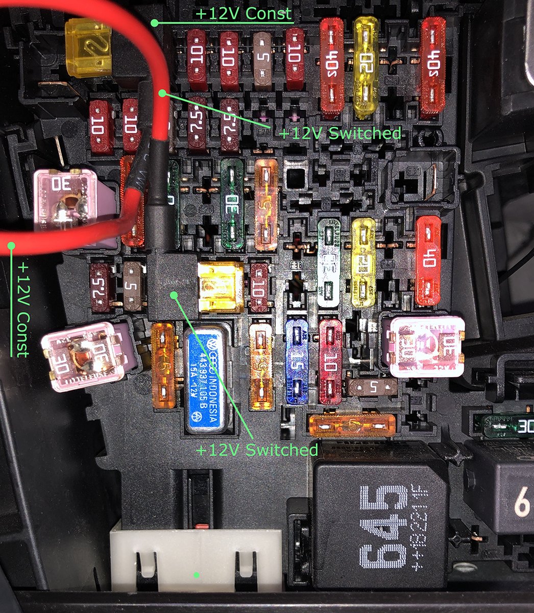

I am planning to piggy back the dashcam to the rear screen heater fuse, when I can actually get at the fusebox hidden behind the glovebox - even the Skoda dealer finds it difficult. See other posts as some, brighter than me, have done it.
I've just hardwired mine in today thanks to this guide - I actually wired in a 12v socket, and then plugged the dashcam in to that. I used the piggyback fuse from halfords in to the fuse 47, adding the 15 amp back, plus a 10 amp to the accessory slot (using the slot closest to the new lead).
The glovebox is quite easy to remove when you know how - push the damper rod where it attaches to the glovebox in (as if pushing towards the fusebox), it will release with a click and a bit of force. Use a screwdriver or similar to push the stops inwards to release the glovebox hinge (these push inwards like tabs allowing the glovebox catch to pass with minor force).

I've fitted my dash cam in the similar way but I couldn't use F47 (BLU 15A) because of the F45 - huge metal fuse for  the driver's seat. So I inserted a piggyback instead of small F36.
