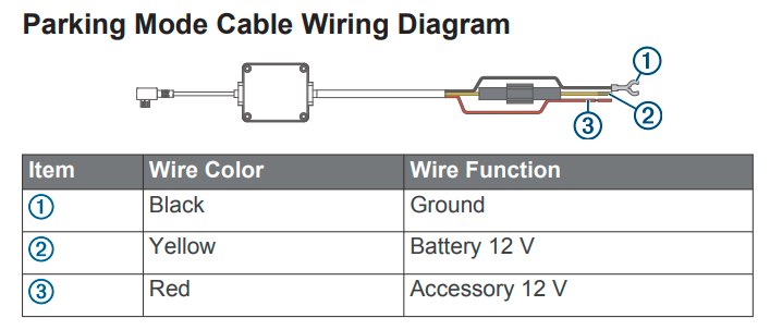

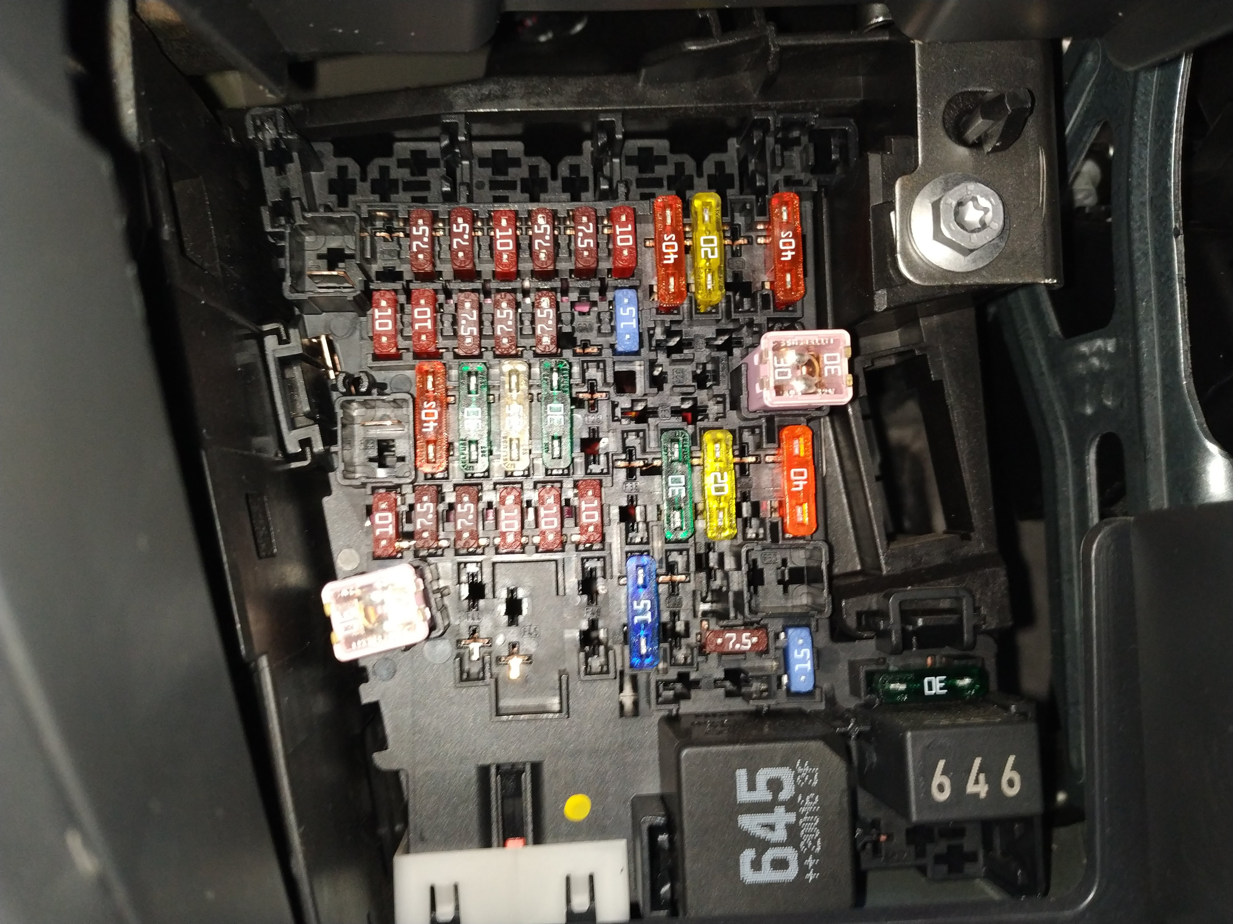

Hello, asking for little help. Based on images where should I connect dash cam on my Karoq:
This is exactly the info I have been looking for. I am picking up an 18 month old Karoq tomorrow to replace my current 2013 Fabia & want to transfer my hard-wired dashcam over. From reading this article it actually looks easier than it was on my Fabia.
