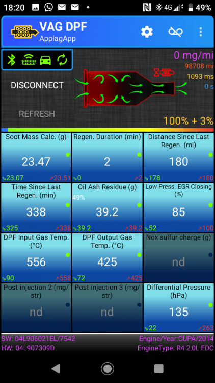

Have a look at threads about having a blocked heater matrix. It may be linked to that. My 2014 Leon FR ST 2.0 TDi did the same (we share the same engines).
Basically - the car does a DPF regen and the DPF heats up to 600 degrees or so to burn the crud off. Once completed, that uses the EGR cooler to cool things down again. This uses the same cooling circuit as the (blocked) heater matrix and as it can't cool sufficiently, it subsequently boils your coolant, opens a pressure valve and that shoots out of the header tank whilst you are driving (you don't notice it).
As it is under pressure, you rarely get a low level warning as you are driving. It is usually once the car cools, the levels drop and you start up next time that you get the warning.
Having your aircon on is effectively helping boil the coolant. If you had your heating on full blast you'd take some of the heat out of the coolant (as the matrix is effectively a mini radiator but not working properly as it is blocked). When the car is warmed up, stick the heating on full blast and see if both passenger and drivers side are similar temps - mis-matched or below par temps usually mean the matrix is bunged up. It's a known issue, partly due to having silica gel sachets in the header tank that can split and block things up.

The common denominator is usually the DPF regen. If you buy the Carista dongle and VAG DPF app you can actually see when a regen is due/taking place. I did that and as soon as the regen was over I stopped and checked the header tank. Coolant everywhere!
SEAT quoted me 8 hours labour + £500 for parts to change the matrix. They take the dash out! Using the Cupra forum and a workaround, I did it myself in 2 hours and bought a new matrix via Europe for €90.
This is a good You Tube video that actually does the workaround on an Octavia. My Leon was very similar.
