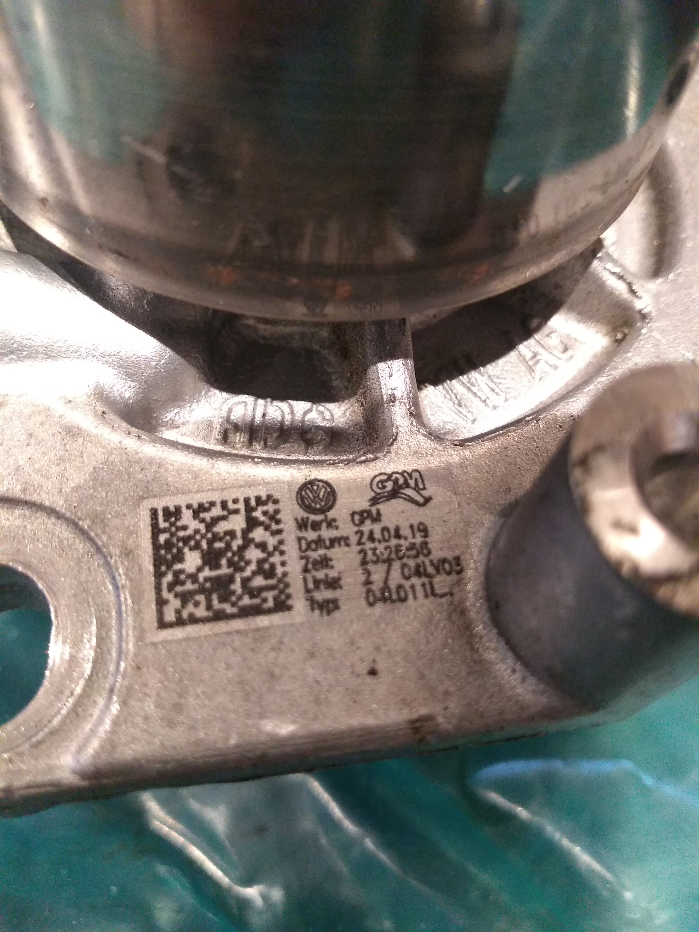

  • Any other info. (Full Skoda service history/independent?)
Cam Belt & Water Pump changed at 70000 miles pre purchase as an approved car from this dealership.
Full service history from same dealer throughout life.
Have old parts in hand to have checked.
Started route of The Motor Osbundsman, as this is a complete and utter joke
See picIMG_20211014_161907090.thumb.jpg.77f19b9906c482dfa37373dde9ea3cd7.jpg for pump details....
