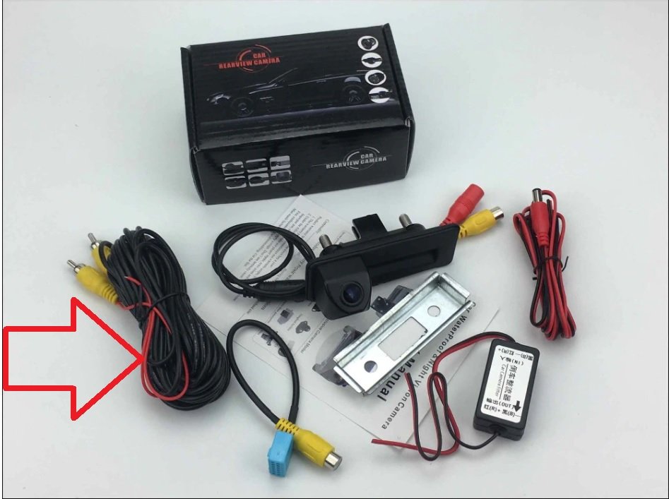

Regarding the reversing camera, bearing in mind I'm a complete novice when it comes to electronics especially..
I've managed to wire mine up at the back, boot handle fits nicely, wrestled with the tailgate trim and eventually overcame the wiring from back, through headlining to the front. I wired the camera in by connecting it to the rear wiper + and - (deciphered from YouTube vids and FB group posts).
My last hurdle is in regards to wiring it in to the android head unit. Specifically, which wire do I connect the red loose wire from the RCA to? Any help would be awesome 👍

By red wire from the RCA I assume it's a small red cable with no plug on end that runs through the same insulation as the RCA plug (in pic below)? If so, that's meant to be your positive line that goes into a wire in back of stereo then use any ground at back for the negative so when reverse is selected it then powers the camera (there is a specific line on back of stereo labelled for this). Wiring it to rear wiper circuit directly will mean at all times that the ignition is in the on position, the camera is actually on and fully powered up. That in itself won't be any real issue as long as the filter box has been used of course, but it will be more run time on the components themselves. Mine is live all time ignition is on too as that red line seemed so thin I didn't want to use it, if it dies I will use it on the next one though.
Yeah that's the same camera I've purchased. I had a look last night at back of stereo for a line labelled for camera, can't see anything other than the yellow female for RCA. Can I attach this red positive cable that runs through RCA to the red cable on the stereo power?
Is the filter a must, as I didn't attach it 🤔
Camera does work right now without the red cable attached to + behind the stereo, but I can tell the picture isn't right

Pic may not be clear if filter not used, camera life may be reduced also. Can't remember the label but there is one might be attached to the actual yellow plug on radio end that plugs into back of stereo itself?
