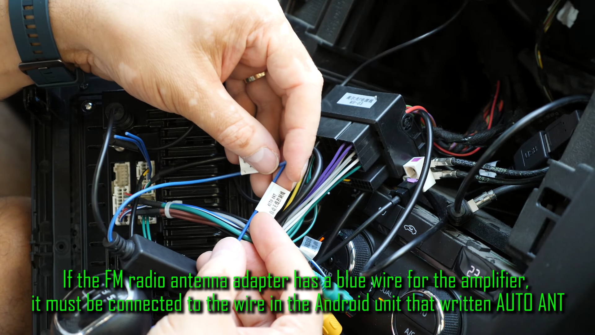

This is the best video to give an idea of how easy it is, nothing scary in it, 99% plug & play bar one single wire to connect for FM booster
That looks pretty straight forward tbh. I think even I could do it lol.
What did he do with the blue FM cable though. Looked like he'd just showed you two ends and then chucked them in with the rest of the cables.
He is showing you the blue cable on the FM signal booster and the blue cable from back of head unit you attach it to image.thumb.png.85e082245e8bac2df9d4056243499e44.png

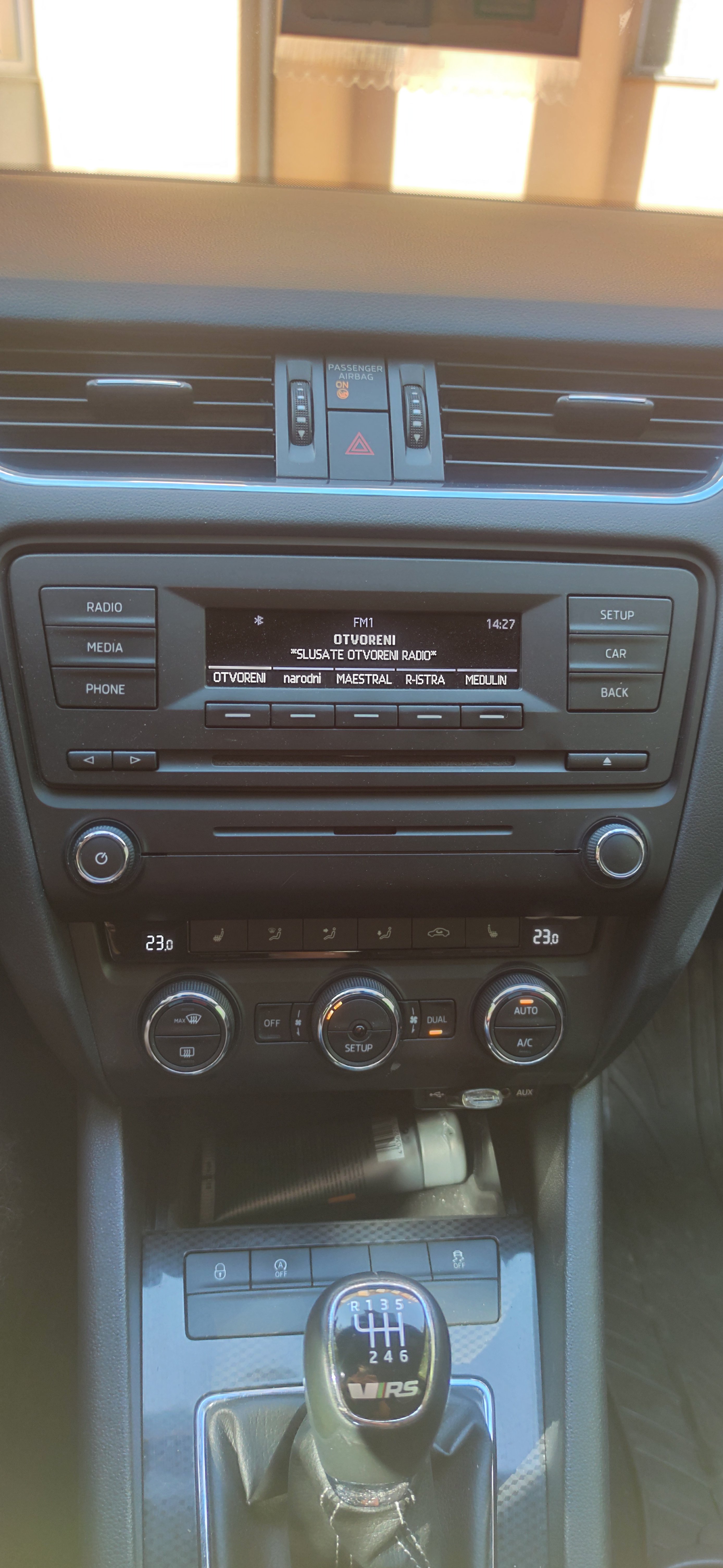

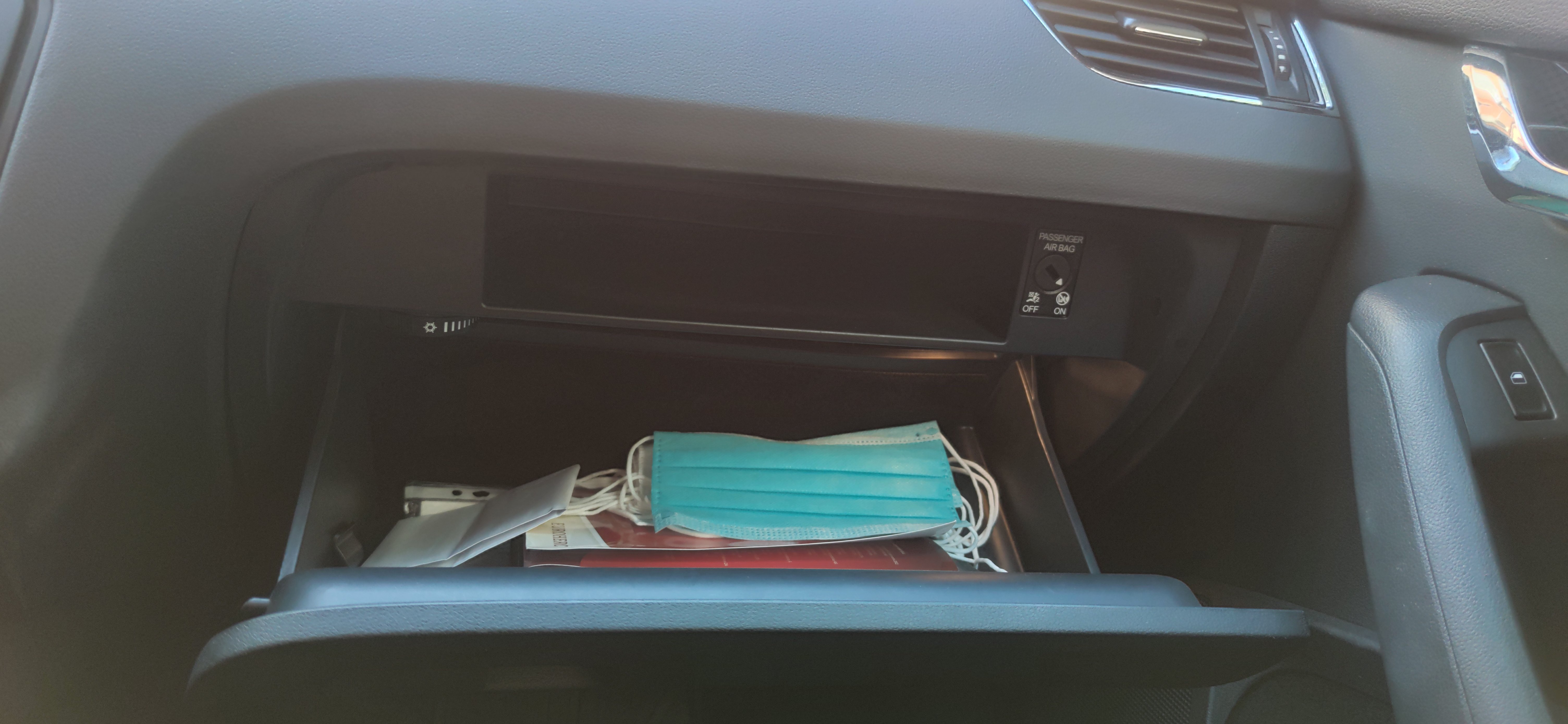

Hi all. I have skoda octavia vrs 2014 with this radio.. I want to know if I can put this android because I dont have radio unit in glove box. Thank you for helpIMG_20210923_142845.thumb.jpg.f4596875c1b9a185d0ec210389c1c0e1.jpgIMG_20210923_142834.thumb.jpg.0f8485af5c4e2a7ca510506b2977ce32.jpg
If you pull out your stereo you will likely find the same plugs are on the back of it instead, if that is the case then it should be fine and a lot easier to install. Look in this video for the type of plugs on the back of the glovebox unit and see if you have the same shaped plugs on back of your stereo in the dash.
