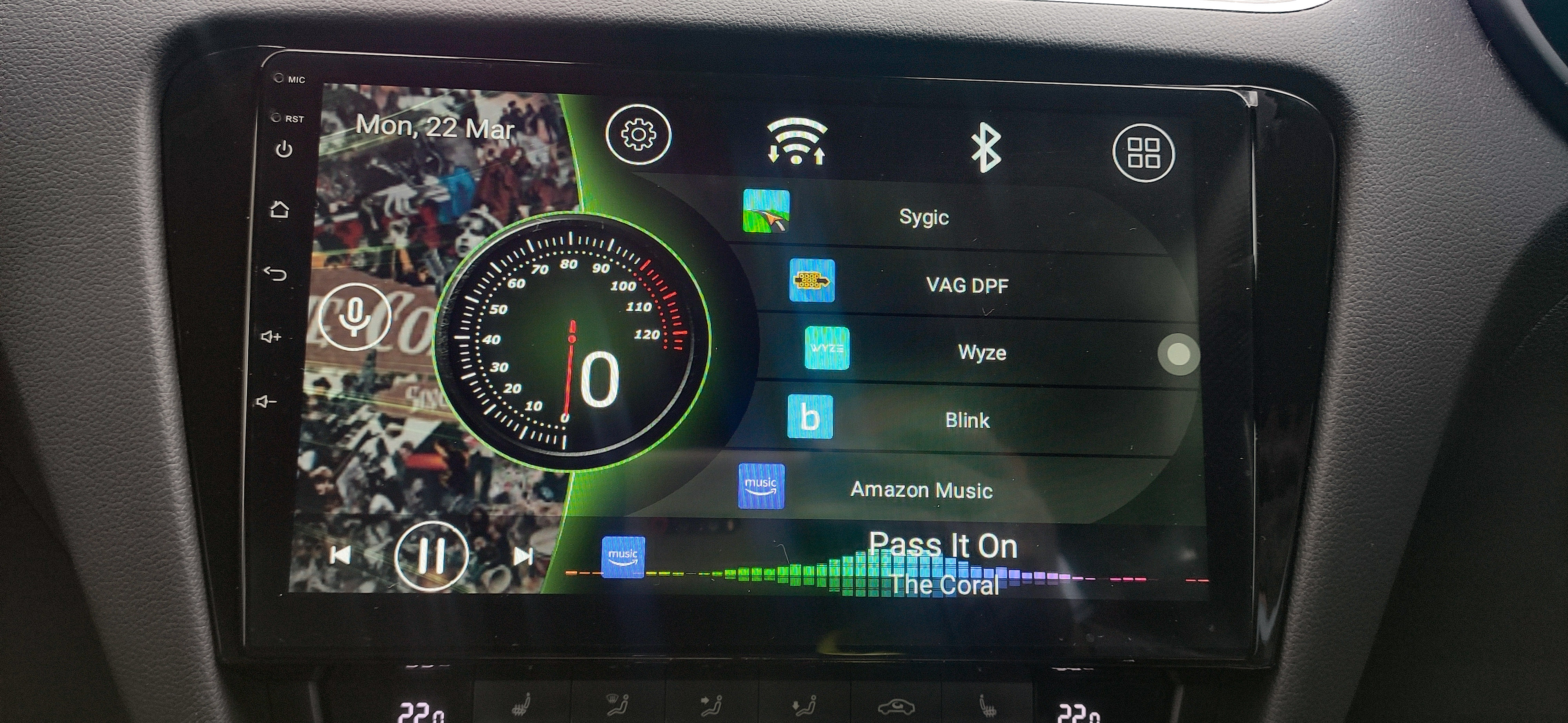

Here is the one I am trying, they have a lot of cool live skins that you can pay for or buy the pro version and get them all from what I have seen.
ps. still not peeled off the screen protector lol
Edited by FUBAR
Looks good. The most important thing is you have everything you need in an easily accessible place.
Today I drove it with no data connection and that's the plan for it. I have downloaded playlists on amazon music app and set that as the primary one for the launchers widget at bottom left etc so it's playing in offline mode from local storage. Then as I have Sygic the same applies as the maps are on the device and I don't need any active connection (not that I ever really use sat nav tbh, but it's there and signal or not it can do all I want it to). I will just give it some data to update things from time to time and take it from there. :thumbup:
