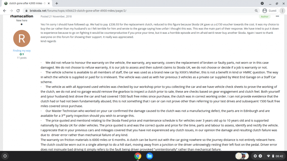

  • Hi all,   Again apologies for the late reply but it's been a bloody turgid affair to get to the point where I had my car returned to me today. Sounds like great news (which it is.) but...
  • Glad you (almost) managed to get your clutch problem and refund of your engineer's report costs sorted.  But isn't it a disgrace that you had to suffer so much hassle and indifference from your Skoda

Hi all - believe it or not this is still not resolved. I haven’t had the money refunded for the inspection nor have they given me a copy of the original works they have done or the subsequent repairs when it came back damaged again.
I have given them a 2 day ultimatum to respond and will then share the headline issues with all of the members on the forum so they know to avoid this dealership at all costs. They have been an absolute disgrace and at the heart of it is ineffective management at the branch which ‘allows’ these practices to go unchallenged.
