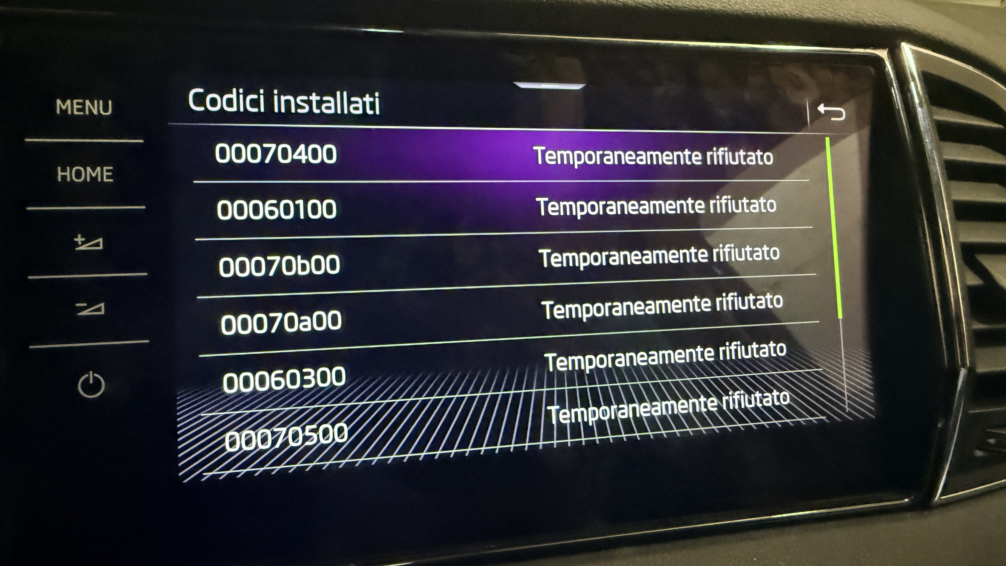

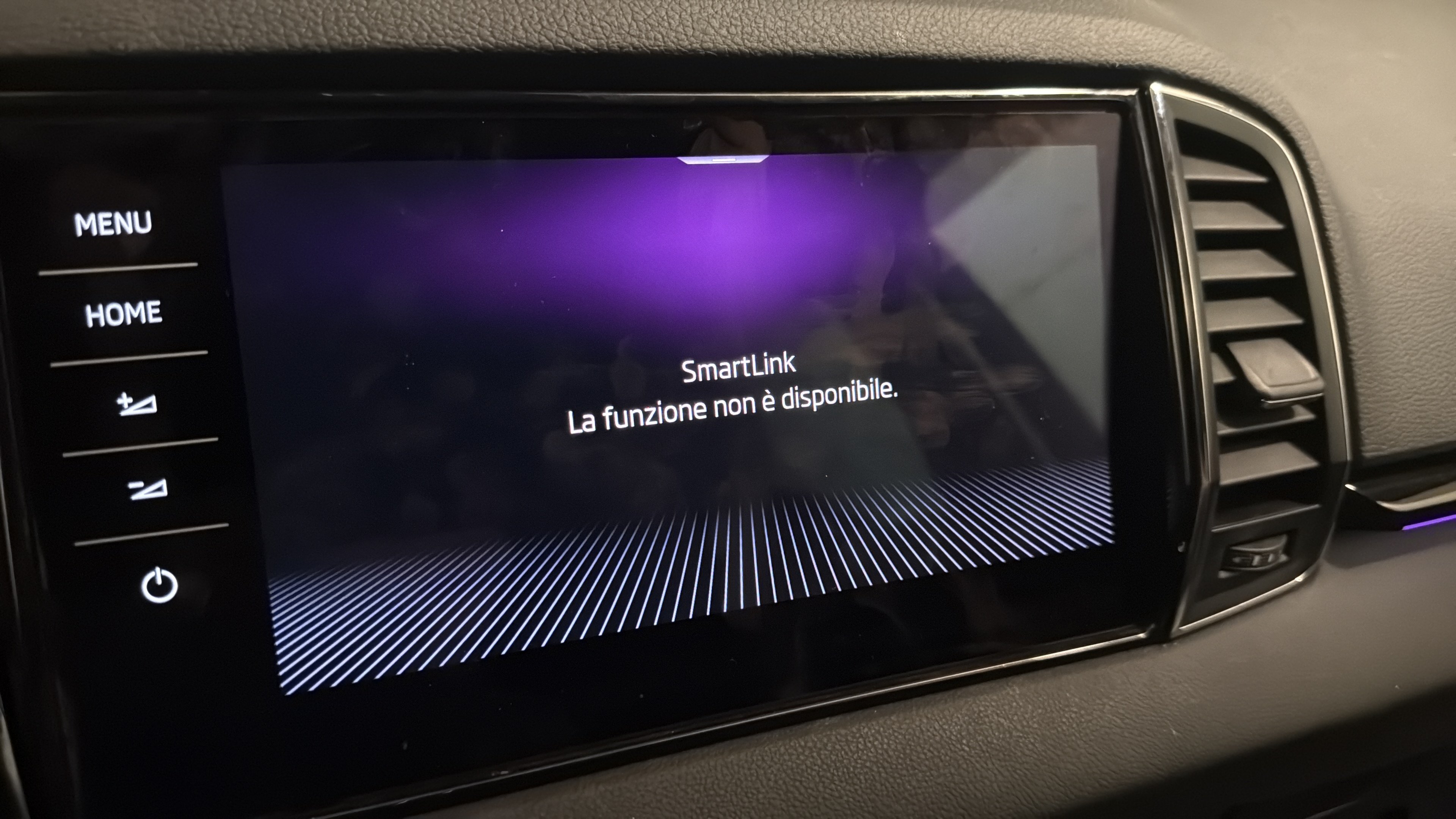

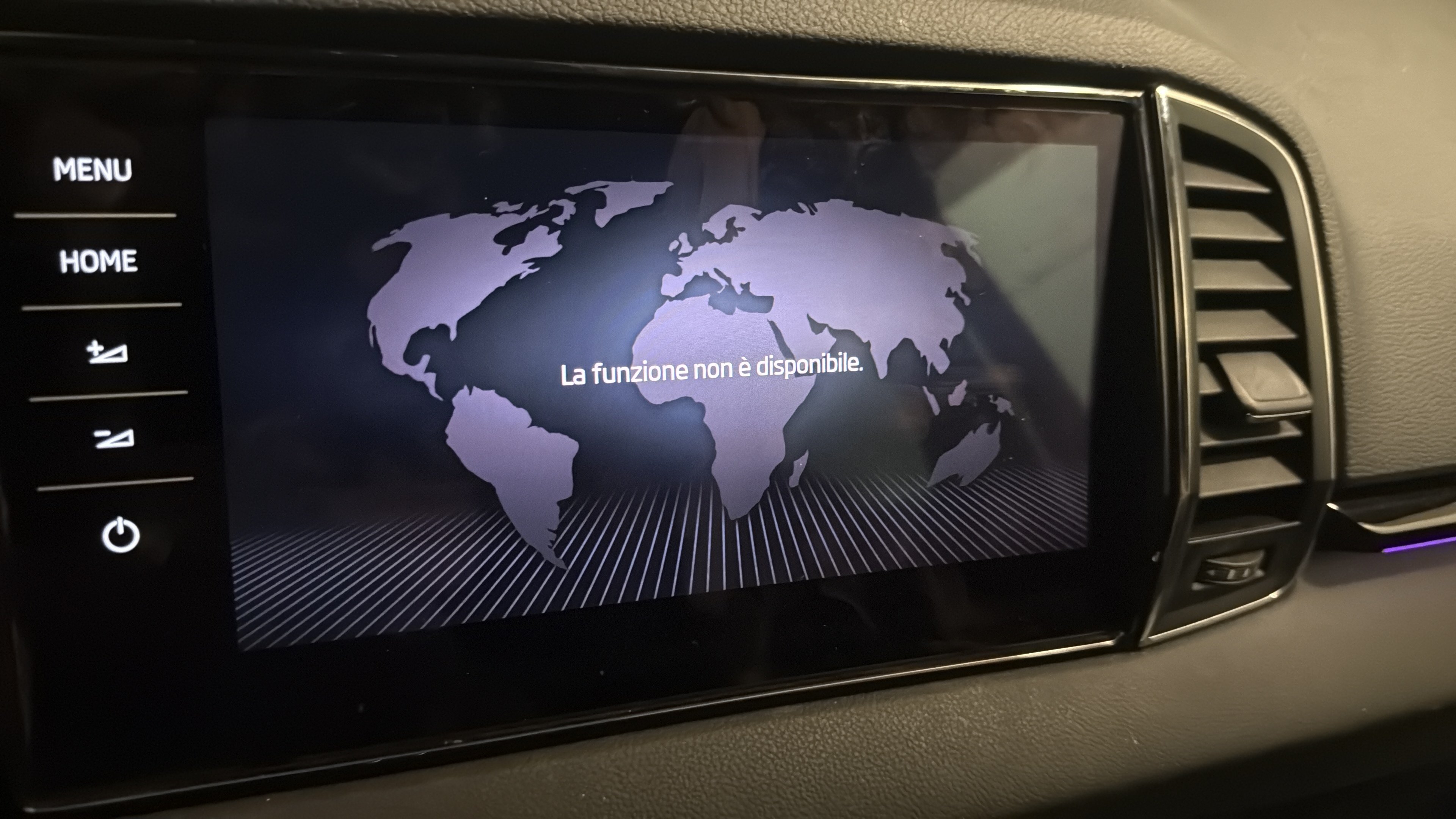

  2. Component protection removed and retrofit done but navigation, smartlink and vocal commands don’t work. But online services via app are on Looks like the FECs didn’t migrate yet! Any idea how solve this without patching the unit?
