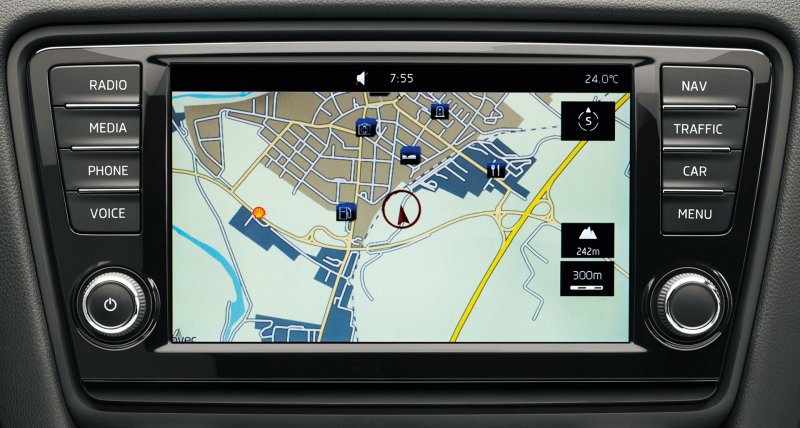

Due to the "Unique" way VAG call different things the same name it caused a bit of confusion for me when trying to upload POI's to my Columbus.
If you have the older Columbus that looks like this
then you need to use this link;
http://www.volkswagen.de/de/navigation/rns-510/poi-listen-sammlung.html
If you have the newer "MIB" Columbus and it looks like this
http://www.volkswagen.de/de/navigation/discover-pro/poi-listen-sammlung.html

I believe this VW POI site is for the old Columbus / Amundsen units not the new current units.
They have the same name but are totally different.

As per above...... This tutorial and topic is for the older Columbus not the newer unit you have. There are some links to the VAG guides for your unit posted earlier in the thread.

If the output file has MIB2DE, MIB2HIGH, MIB2TSD files in it then it's been produced with the Discover Pro site. I have the same problem insofar as I can't get the POI to load onto my MIB1, but looking at the output files it may be that they're only suitable for MIB2 units?
