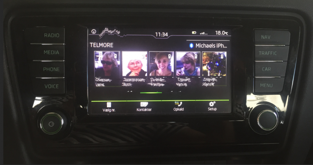

  • I am a Iphone BETA user on IOS 11, and have now tested it on my Škoda Auto Amundsen Infotainment system 2016.   After upgrading to BETA IOS 11, then iPhone contact pictures are now shown on
