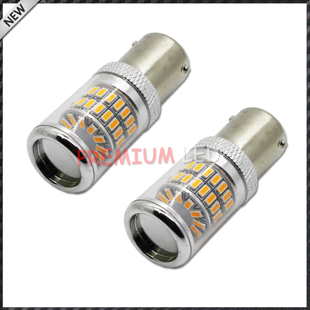

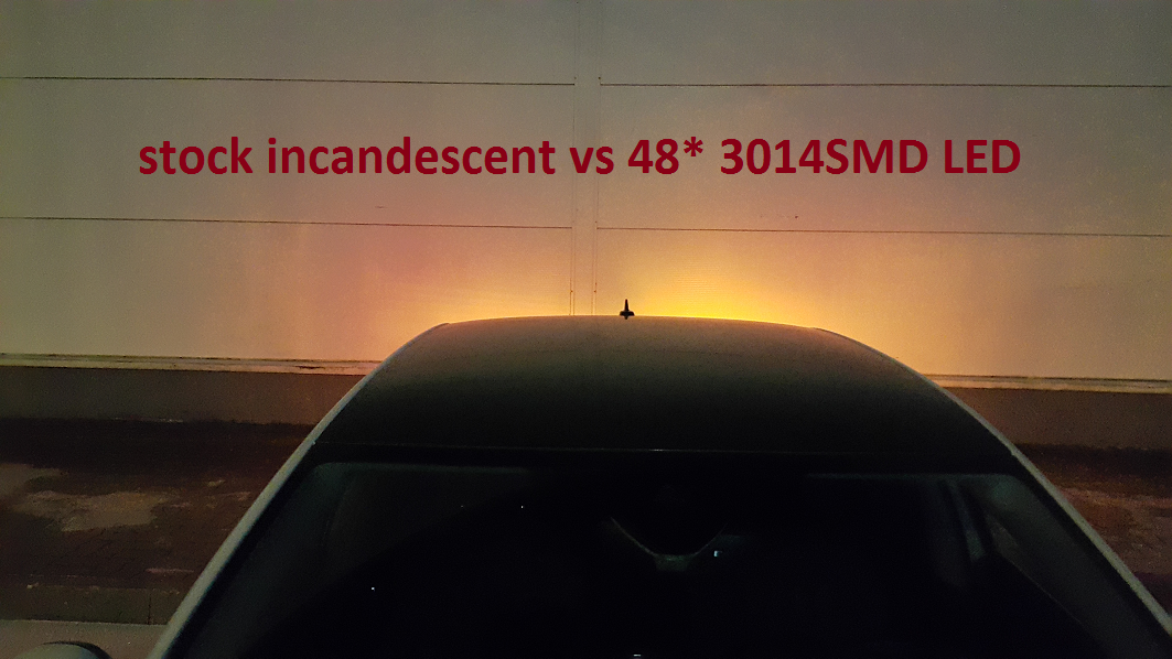

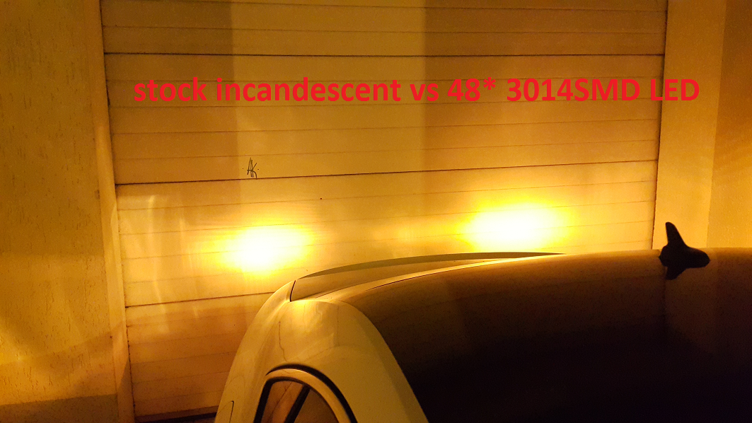

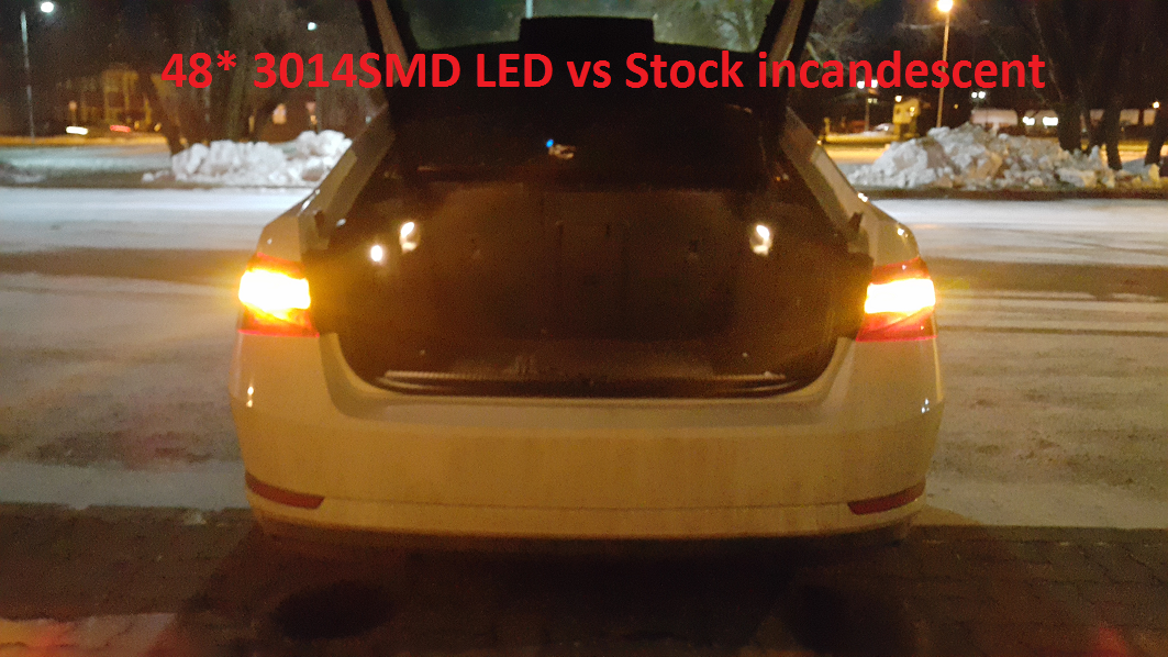

On 2/1/2017 at 09:05, MartiniB said:
Rear Turn Signals
stock(Philips 12496NA/LLPY21W12V [E2] 2F7 FRANCE 5M02) Incandescent
replaced by
Ali's noname(Kaizen-GT 1156PY 48* 3014 SMD 12v 6.2W)
https://www.aliexpress.com/item/2pcs-Amber-Yellow-Error-Free-BAU15S-7507-PY21W-1156PY-LED-Bulbs-w-Reflector-Mirror-Design-For/32316963252.html
Hi MartiniB.
I ordered the same bulbs on 8th of this month and they arrived yesterday.
Fitted them today and by the cringe, what a difference they make.
Thanks for the tip. :thumbup::thumbup::thumbup:

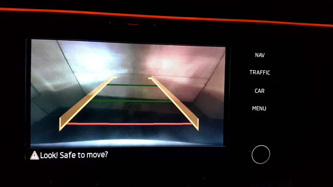

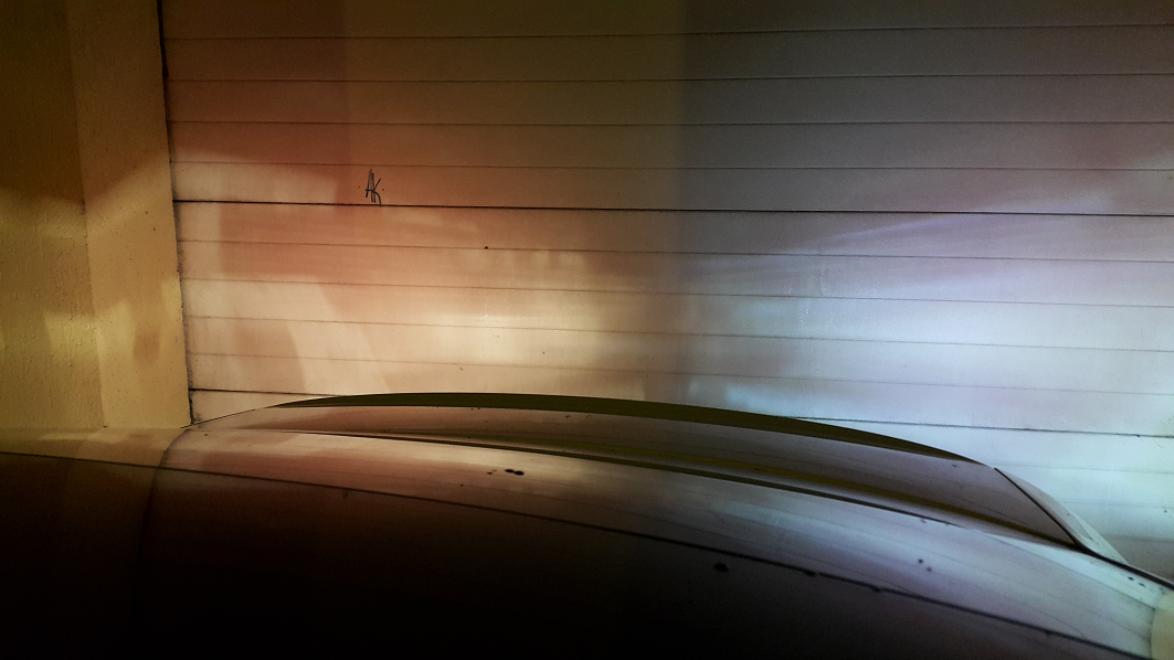

On 21/11/2016 at 13:40, MartiniB said:
have replaced rear
Osram S? 7506 12v P21W [E1]2 1514
to
MAXGTRS S25 1156 BA15S 80W P21W 4+12 CREE Chip XBD LED Car Reverse Lamp
https://www.aliexpress.com/item/2x-High-Power-S25-1156-BA15S-80W-P21W-CREE-XBD-LED-Reverse-Light-Backup-Led-Reverse/32565773694.html]
LED vs Orig on Columbus
Orig vs LED
made also some measurements by app on Galaxy Note 4
Osram
Declared lumens: 460
Lux from 10cm: 2100
Lux from 50cm: 190
MAXGTRS
Declared lumens: ---
Lux from 10cm: 3000
Lux from 50cm: 280
top leds give higher values, but in Superb case they go to the back side of reflector
